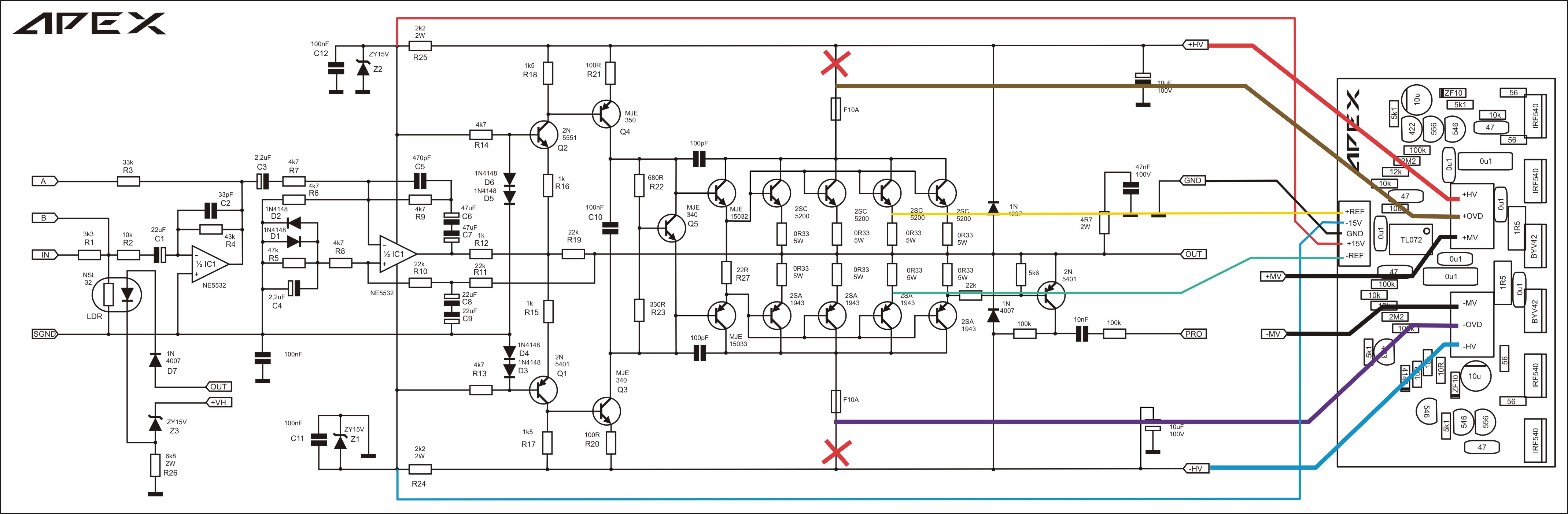

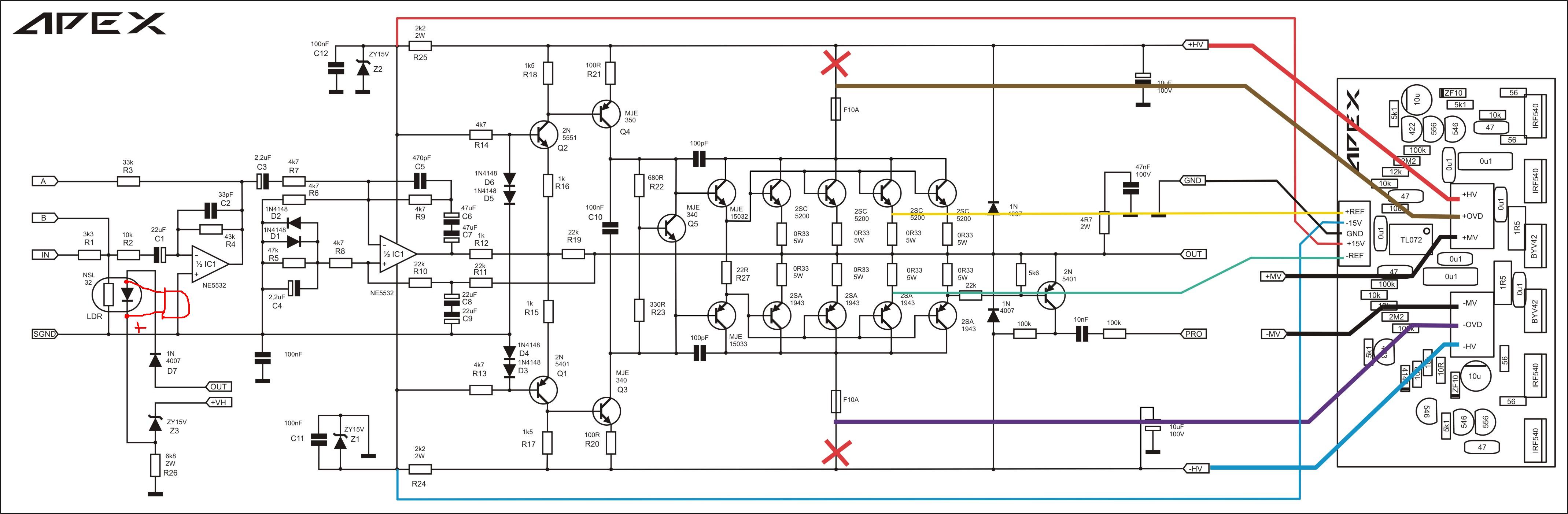

500W PA amplifier with Limiter

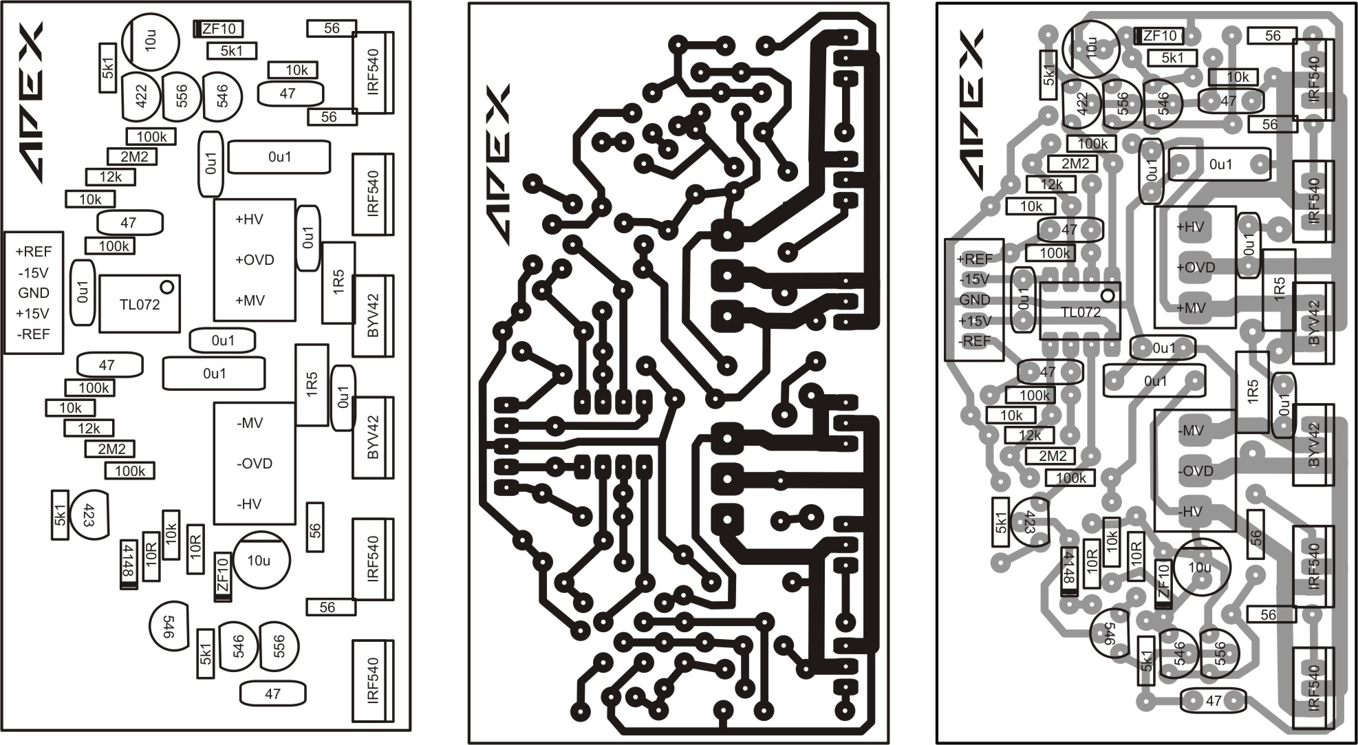

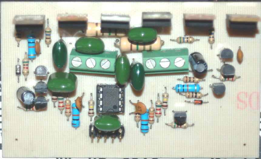

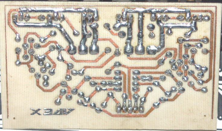

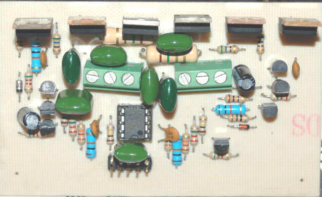

TL072 Pcb and Component Layout.
Ty mile now ill try to connect Step drive to my B 500
pls check if anything wrong with my work.

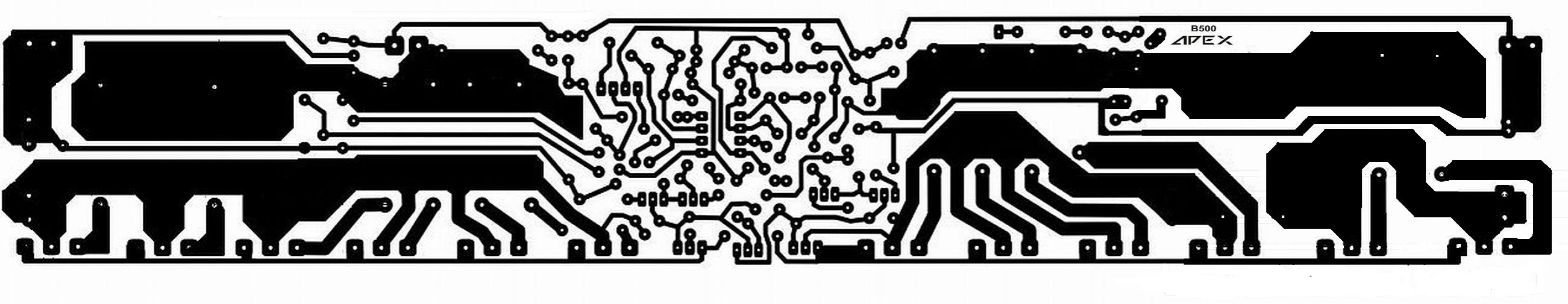

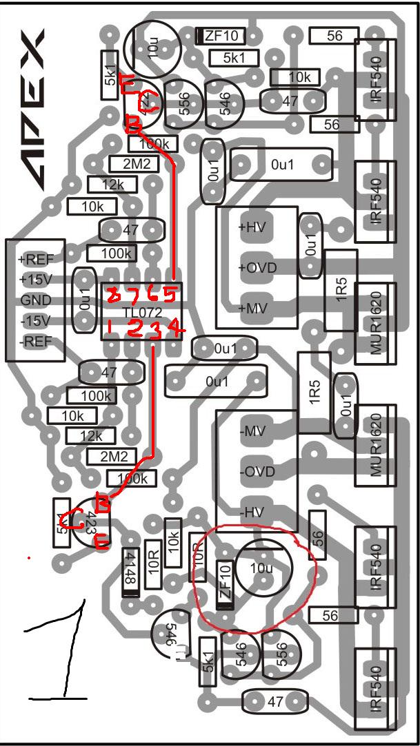

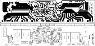

B500 PCB WITH THICKER TRACKS
hi folks here is just a bit modified version of B500 pcb with thicker tracks . Hope u people like it . I wanted to add more o/p pairs atleast 2more pairs but i dont know the size of the current pcb . If any one can tell me the actual length of the pcb it will be very helpfull...
regards
sekhar

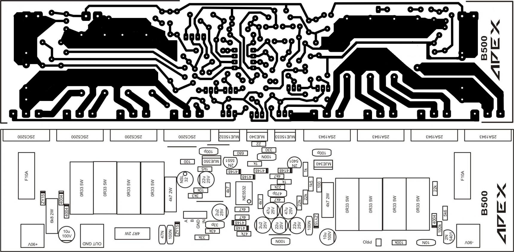

B500 WITH SIX O/P PAIR
B500 with six o/p pair. Can any body print this pcb and tell me actual length of the pcb.... i will add silkscreen very soon only two new jumpers ......................
hope u like it guys ................
regards
sekhar

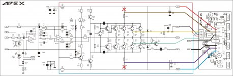

OK guys here is the top layer showing the 2 additional needed jumpers everything else same with the earlier b500 top layer except 2 more pairs and the four 0.33E resistor ........ plz some body print the pcb on a paper and tell me the length............
regards
sekhar
