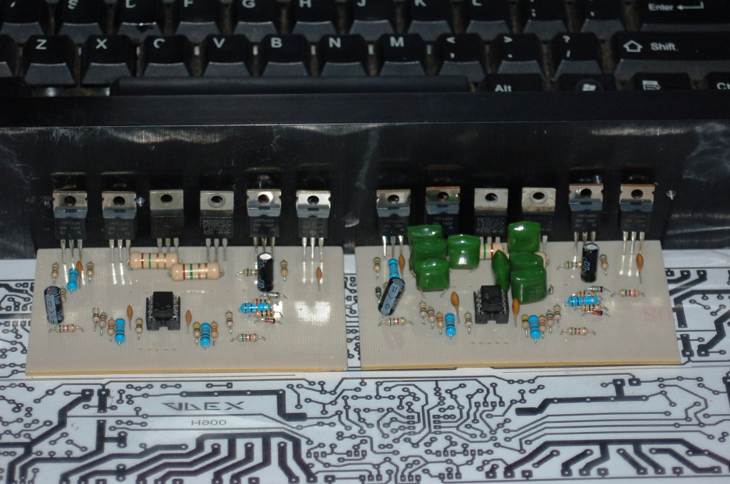

Almost done updating B500 to H class i hope it works for me
pictures attach

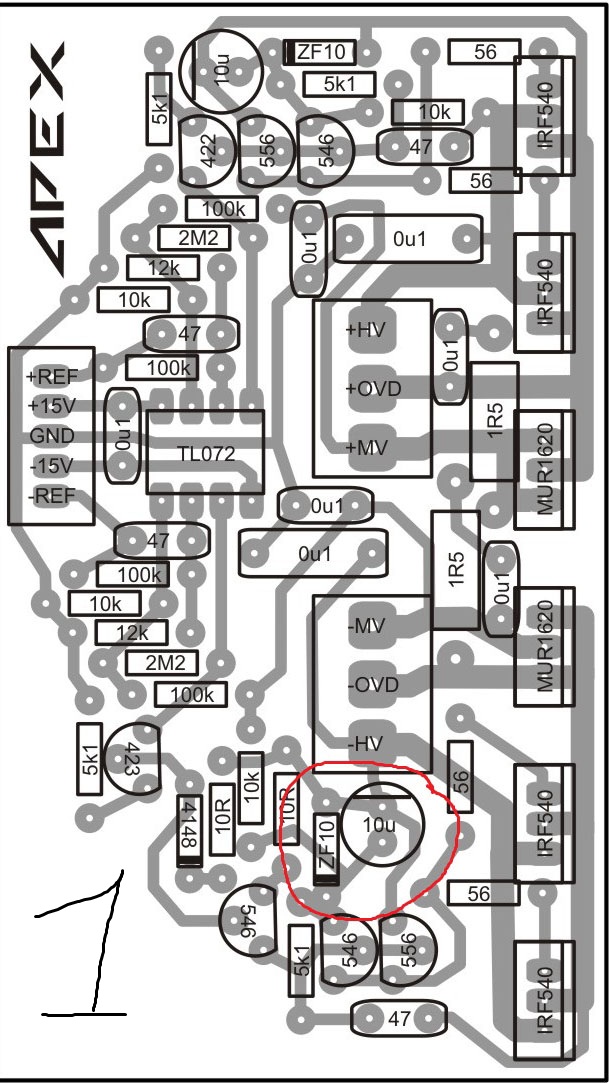

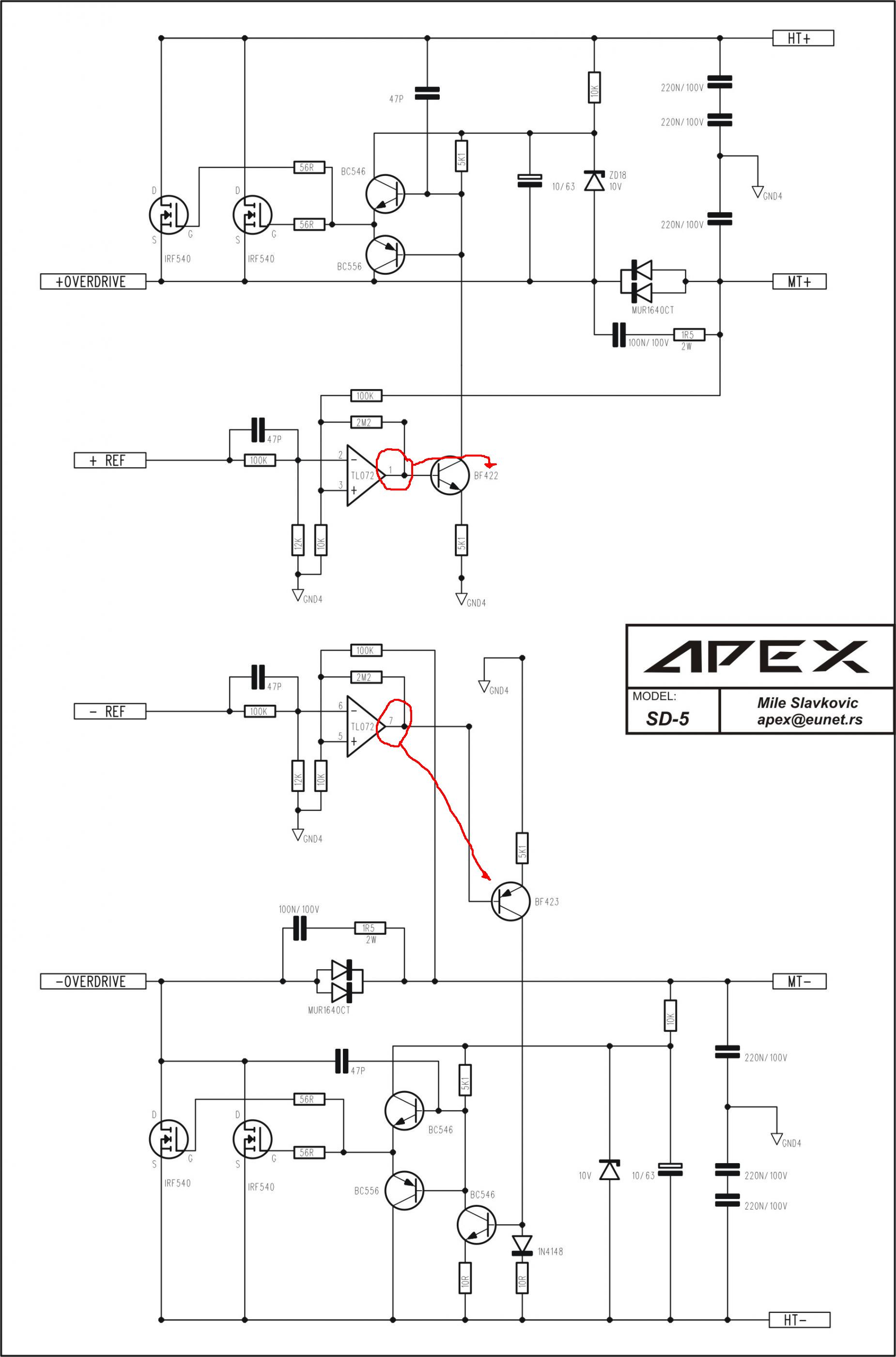

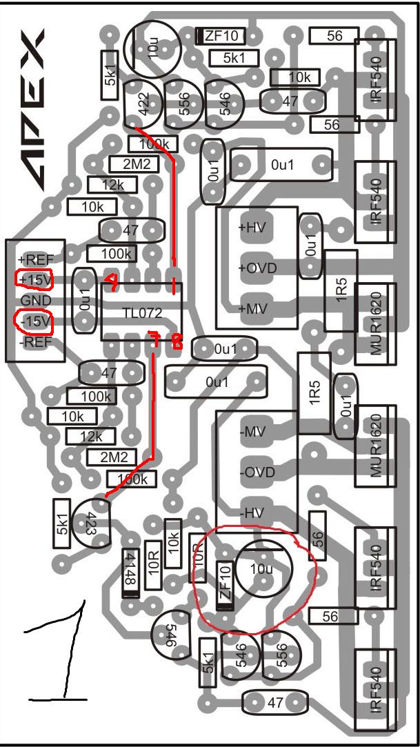

wich is correct
to mile pls help
lol my bad which of this is correct1 or 2,i just want to make sure before i connect the step drive to my b500
Correct component layout is on picture 1.
Regards

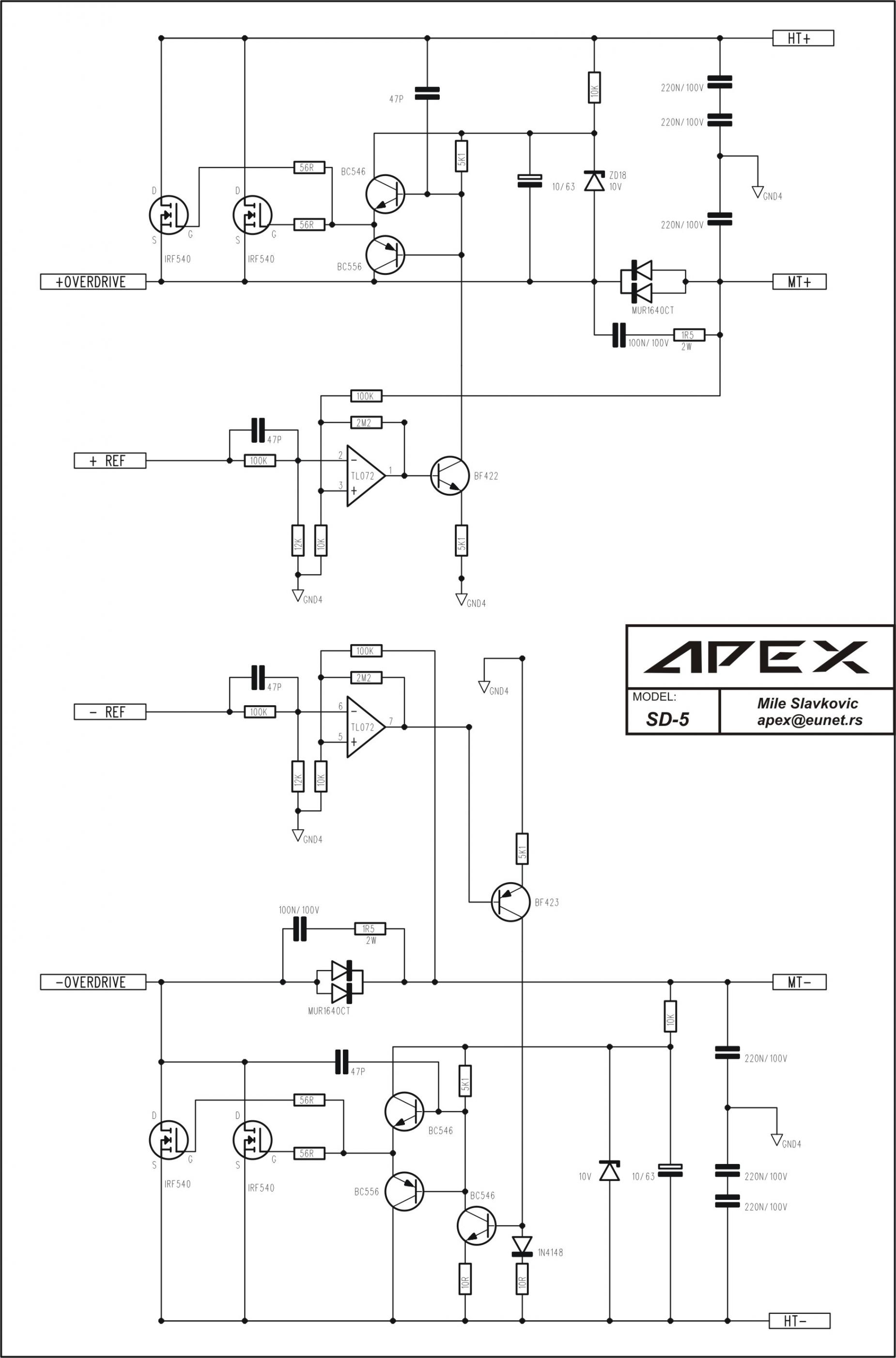

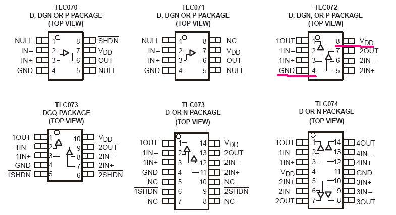

apex,
irvynejay,
a closer look at the schematic
i.c. pin 1 goes to bf 422.So neg supply must be pin 4 where signed as +15.
somebody must check my observation
pin 7 goes to 423,pin 8 must be positive where signed as -15
TLO72
pin 4 neg supply
pin8 pos supply

hi engel dela pena
greetings yes it is working fine only use last schematic of tlo72 step driver the 10uf and 10 volt zener wrong orientation corrected driver
stage from diysmps 1200 watt works fine 10 output pairs used it good if
IR2117 NOT AVAILABLE but i think coolets pcb is best if u use tlo 72 step driver
no wiring more compact will try coolets pcb in a few days and post pictures
weather here really cold use IRF2807 instead of IRF540
