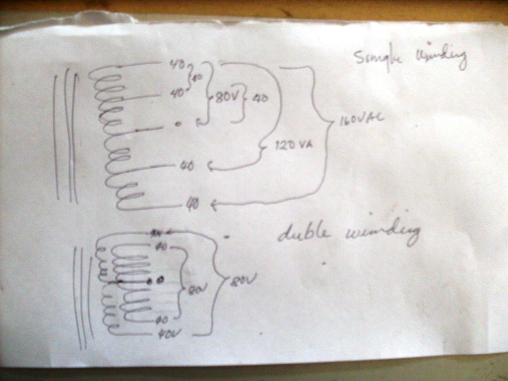

trapo 40x4
To mile Can you help me about this trapo scene IR2117 will be delayed,i decide to try to use your step drive using TL072 on B500 but im having difficulties analyzing the trapo which is i will customized to make pls give advice which is correct for my windings
hmm ok so in need to rewind the trapo like this 80vac 40vac 0 40vac 80vac pls correct me im wrong
Thanx Coolet

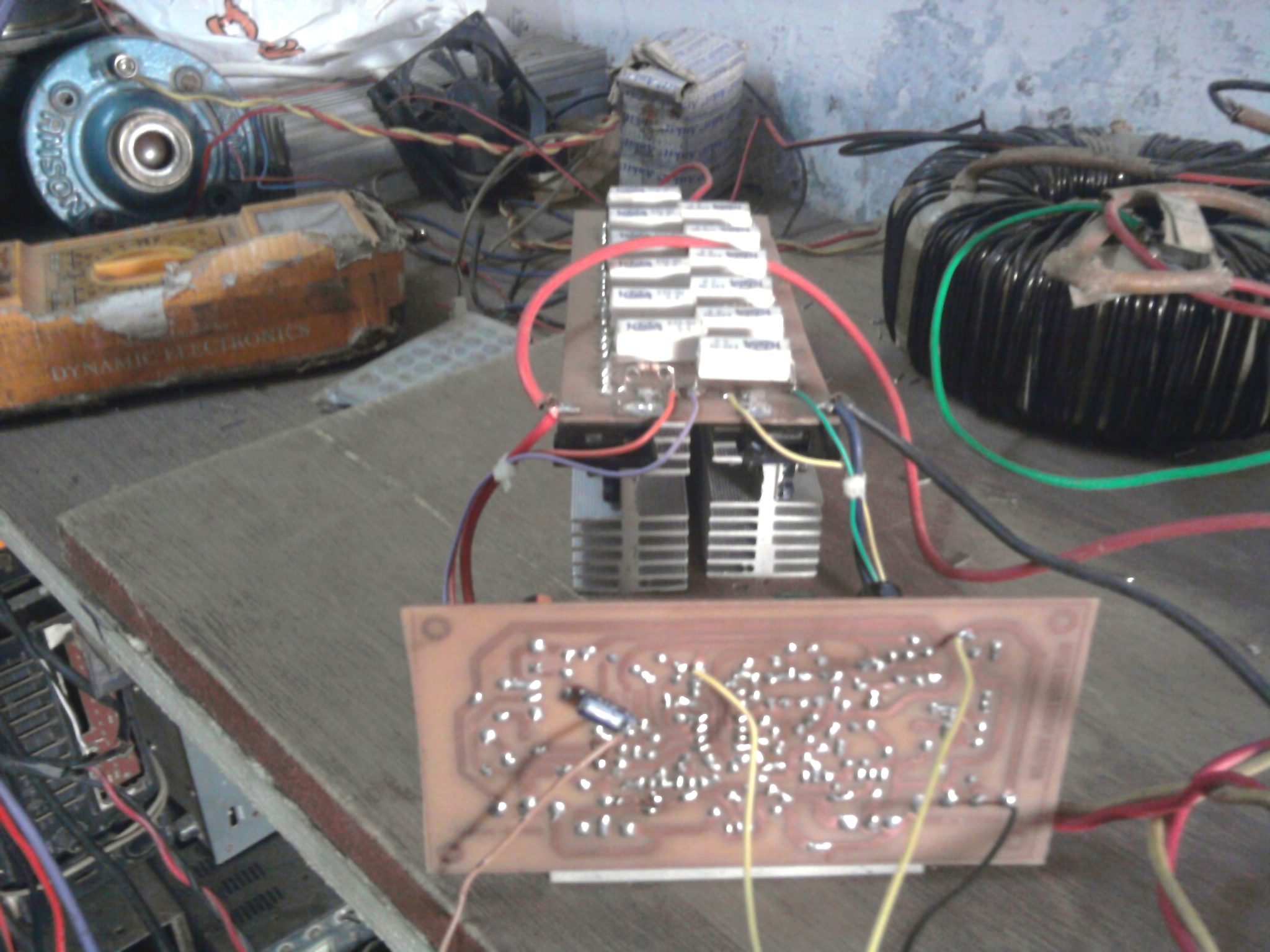

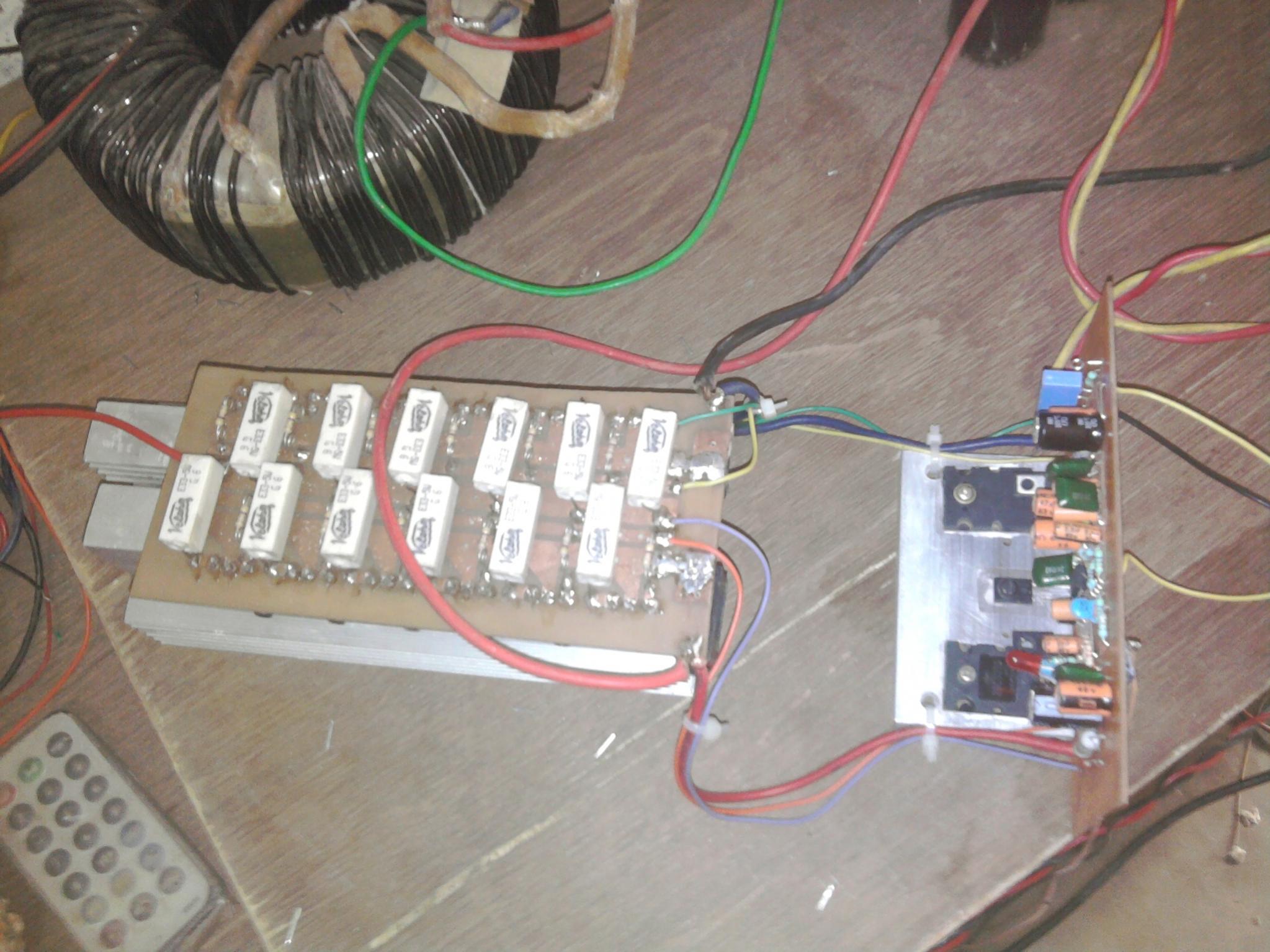

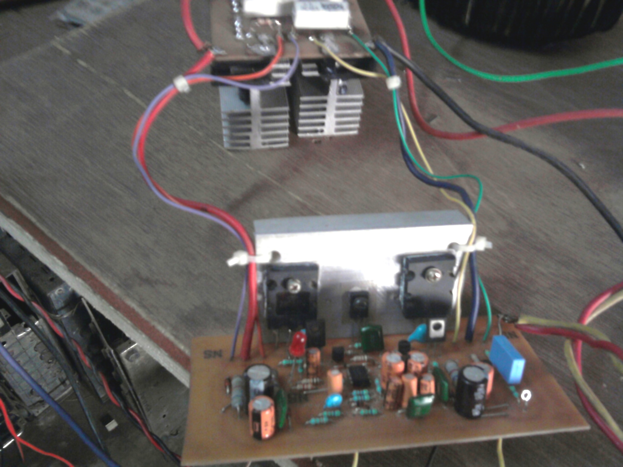

b500
my b500 in progress 🙄
http://img811.imageshack.us/img811/1189/picture144e.jpg
Nice heatsink, I suggest to use some drivers in TO220 case.
Regards
80vac 40vac 0 40vac 80vac is correct,
Regards
