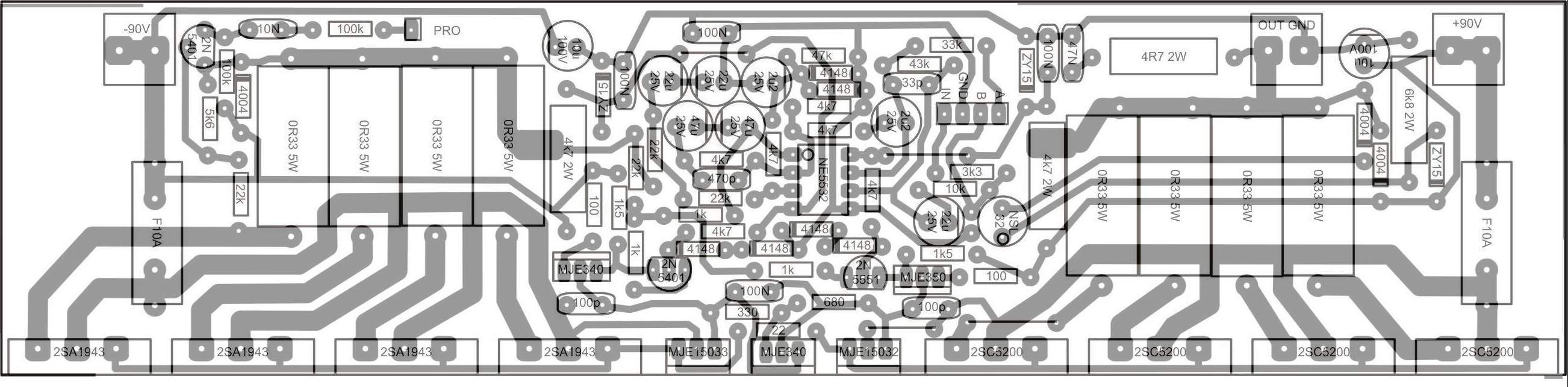

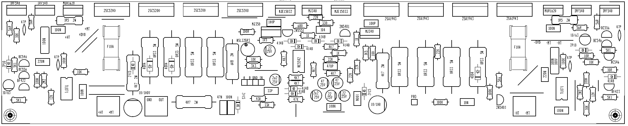

hi apexaudio
greetings please can you check coolets pcb for component value
1 R24 R25 SHOULD BE 2.2K INSTEAD OF 6.8K
2 R4 SHOULD BE 43K INSTEAD OF33K
3 C3 C4 2.2UF NO 2.2UF ON COOLETS PCB
4 R5 47K
THANKING YOU
ANDREW LEBON
4 R5 47K
THANKING YOU
ANDREW LEBON
hi coolet
greetings cool pcb design
1 43K SHOULD GO DOWN IN PARALLEL WITH 33PF
2 33K SHOULD GO DOWN
will keep you posted if anything amiss should finish pcb today
thanking you
andrew lebon
thanking you
andrew lebon
hi coolet
greetings sorry forgot
1 6K8 2WATT 4K7 2WATT AT SIDE OF .33 5 WATT SHOULD BE CHANGED TO 2.2K 2 WATT
THANKING YOU
ANDREW LEBON
THANKING YOU
ANDREW LEBON

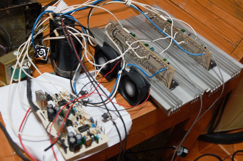

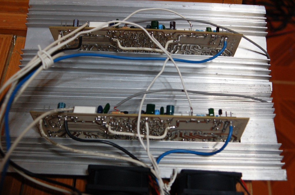

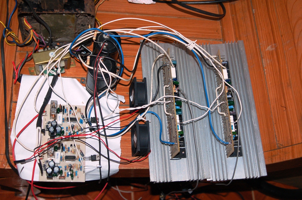

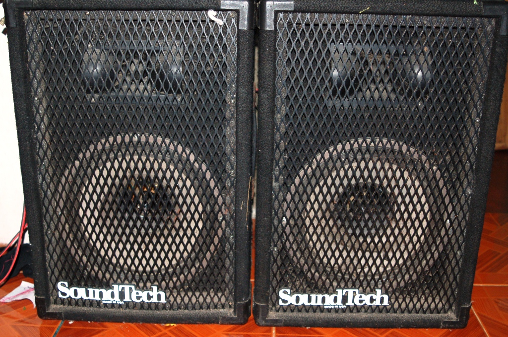

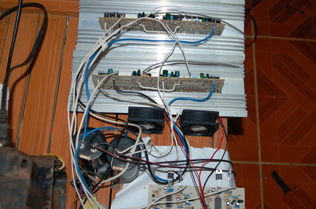

2 Channel B500 with protect connected
2 channel are now working with protect loaded with 2x200wats sound tech speaker with mixer 12 channel,VERY CLEAR SOUND TY APEX AUDIO

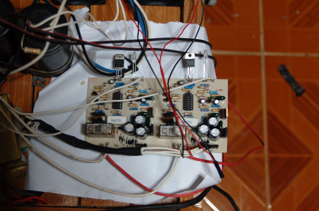

Thank's for the pictures, thermal diode BD241C(TIP31C) must be on main heatsink.
Regards
yes when i finally mounted it on the chassis i will put it on the heat sink. when B500 fully done i DIY H750 or H900 soon..i am very thankful to you apexaudio

ah ok miles Thanks ,,BTW i notice 2 power amps running with volume at 50% is it normal NE5532 is heating up?? not too hot i can touch it with my fingers
