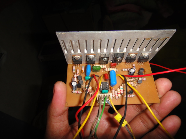

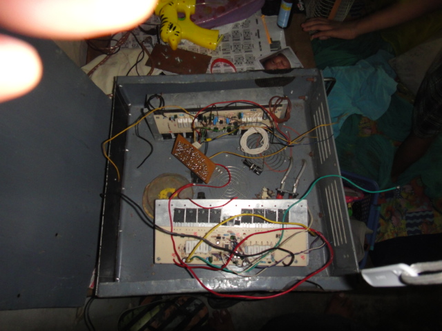

since i was using h900v2 pcb,i forgot to put jumper on neg. supply the one going to ir540
i already power up without jumper to neg. supply.Then after noticing the situation,i put then the jumper and power it up again,then the slight burning happen.it happen with zero v on the out.
I hope no collateral damage.

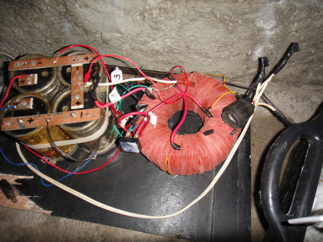

thanks i better do my testing tomorrow,i need some rest,winding a torroid is not that easy,adding 2x48 and 2x18 to my trapo.
now i got 96-48-0-48-96 ac
using 4x 20,000uf 75vdc
i got medium volt +/-62.5 dc
HV +/- 125 dc

will my psu work?for my b500 & tlo step
Voltage is to high, you can winding more turns in series with primar to get lower voltage on secundar side of transformer.
