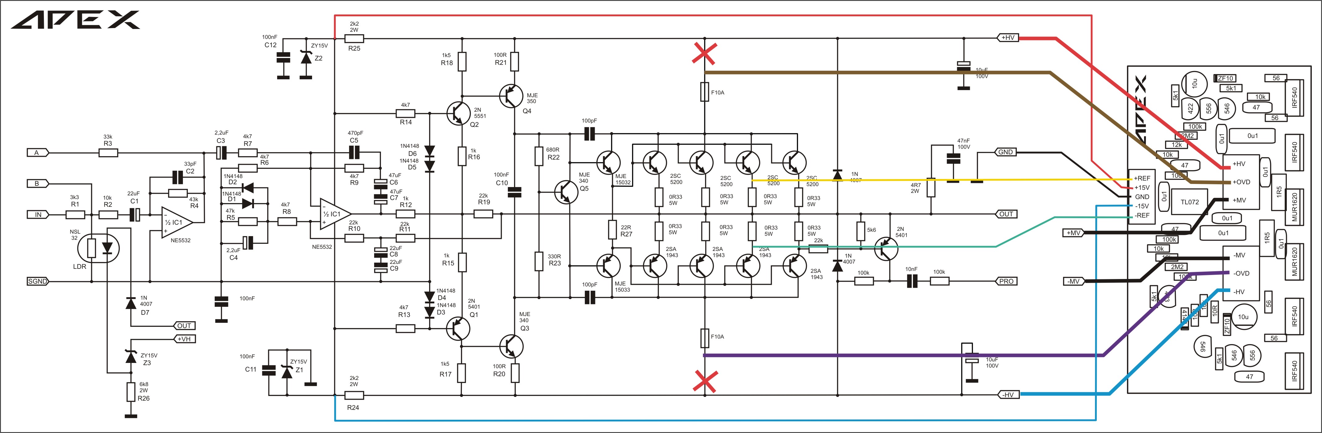

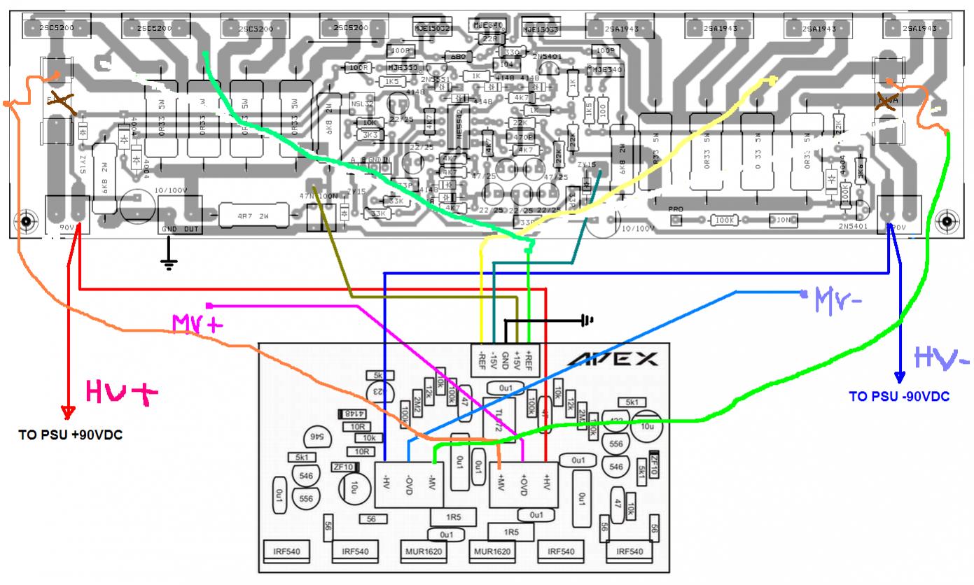

Hi Apex,
Is this correct? You got PM
You need +/-45V on +MV/-MV. Colectors of MJE15032/MJE15033 must be connect to colectors 2SA1943/2SC5200, see post #402 in thread:
http://www.diyaudio.com/forums/solid-state/162408-900w-h-class-pa-amp-limiter-41.html
Regards
Regards
Hi Apex,
hope this helps
@ apex tnx got it )
tnx Angel.. I'll make a new layout
so what is the +/-MV voltage? for B500
sorry for my lines
hope this make sense
apex pls. correct me if i'm wrong
