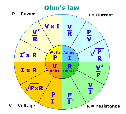

apex, sir...
sir im very sorry for this silly question...😀😀😀
how do i translate 50v 0 50v 1000va trafo into amperes???...😕😕😕
i think i've read it somewhere in the thread but i just forgot where...😕😕😕
salamat po,
regards...
Ohm's law
You can calculate by yourself,
Regards
