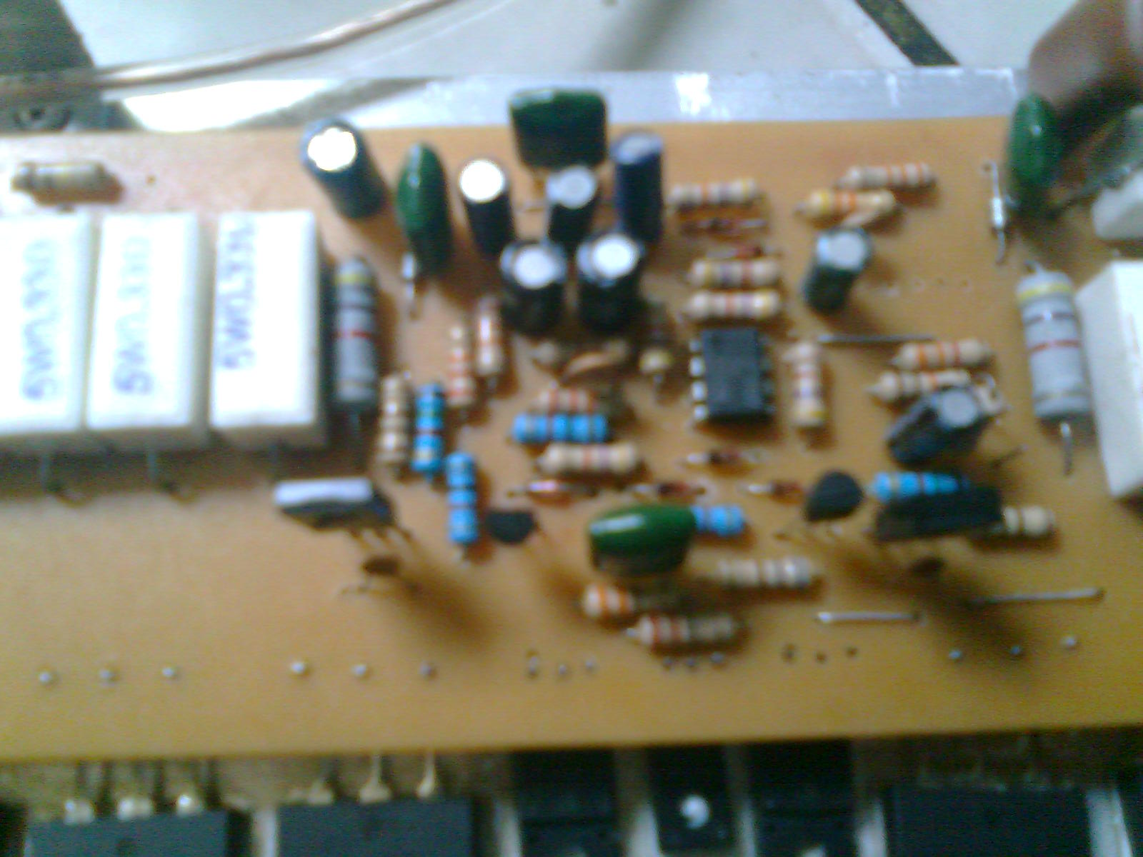

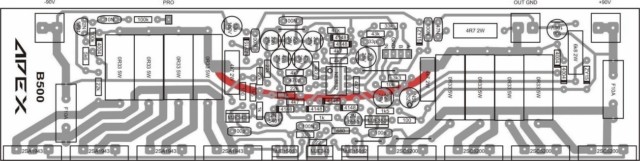

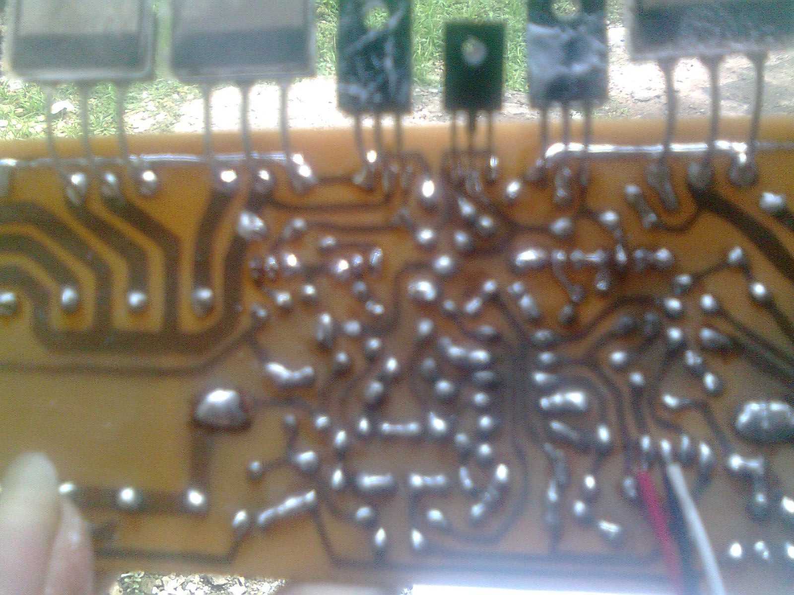

2nd channel prob...
apex...
sir,...
today i powered up my b5oo second channel...
output transistor were fine...so were the drivers...
no hum on speakers...
no dc on output...
touching input produces hum on speaker...
problem is,...
as i plug in my rca with the computer playing...
i noticed there was no audio output...
touching input makes output produce dc up to 5v...
it seems like dc voltages is amplified upon touching input...
i uploaded a video on youtube showing the case...
here's the link...
YouTube - b5oo second channel
please help...
tnx...

If work with finger than must work with audio signal also,
Regards
sir,
touching with finger makes speaker hum, but also makes dc output increase...i was wondering why audio signal is not amplified...
i have 0v dc on output but when touch by finger increases dc...
please help...
Video and pictures are not clear. DC offset you can only measure without signal on input (input short to GND). When you touch input with finger you put ac signal to input, and only way to know what you have on amp out is oscilloscope.

sir.,,
this second channel doesnt behave like the first one...yes dc offset is zero without signal...i used my fon to produce audio signal but output sound was very distorted...LED clip indicator lights on when i touch the input...its my first time to face this kind of problem...
