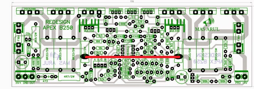

Apex B250
I just finished two B250, and tried to power up both of them and no one works. I connected the signal ground to power supply grround, dummy load 4 R, signal generator, and power supply +-80 volt. Nothing....everything it's cold, but no signal at output. What it's wrong or this pcb have some errors?
Is there wire jumper on your pcb?
