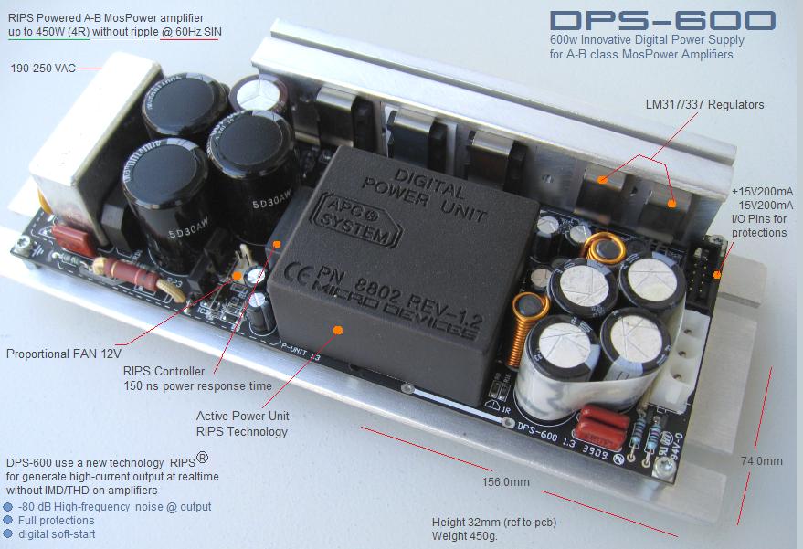

What is output voltage?Hi All,
to Apex:
Want to try the PA version of this power supply with your 500w amp?
I have tested extensively with mospower 450w (4R) but only with a model of amplifier.
I curious to know how it goes with other models.300-500w RMS.

hi,
PA version:
+/-72V 10Amp (repetitive 15amp burst) (230AC)
trim can 5% ADJ on board.
voltage decrease only 3v @ SIN and 4,5 with burst 60Hz. very hard ...for woofer.🙂
or +/-68V for audiophile amplifier model (this in photo)
Regards

Hi,With that voltage MOSFET amp will work also,
http://www.diyaudio.com/forums/solid-state/162043-mosfet-amplifier-irfp240-irfp9240-18.html
Regards
no problem from 52V to 76V max.
but this special power supply can powered only one amp, independant of current.
not suitable for stereo,two power supply is necessary for this.
this PSU (450g.) emulates very big toroidal with 2x22000uF.😉
Regards
