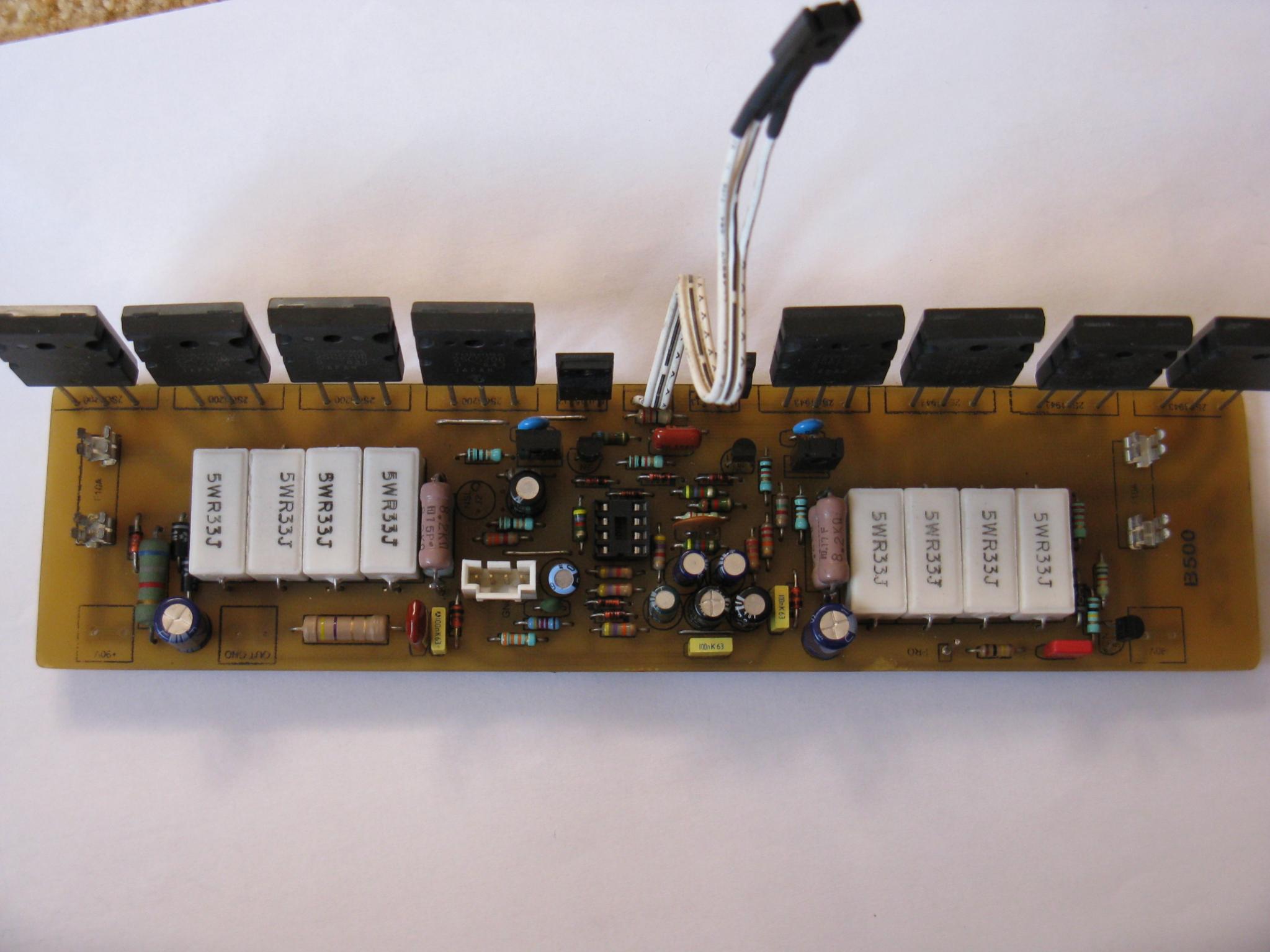

I finished collecting b500, here's what I got! "A few days ago will be tested.
