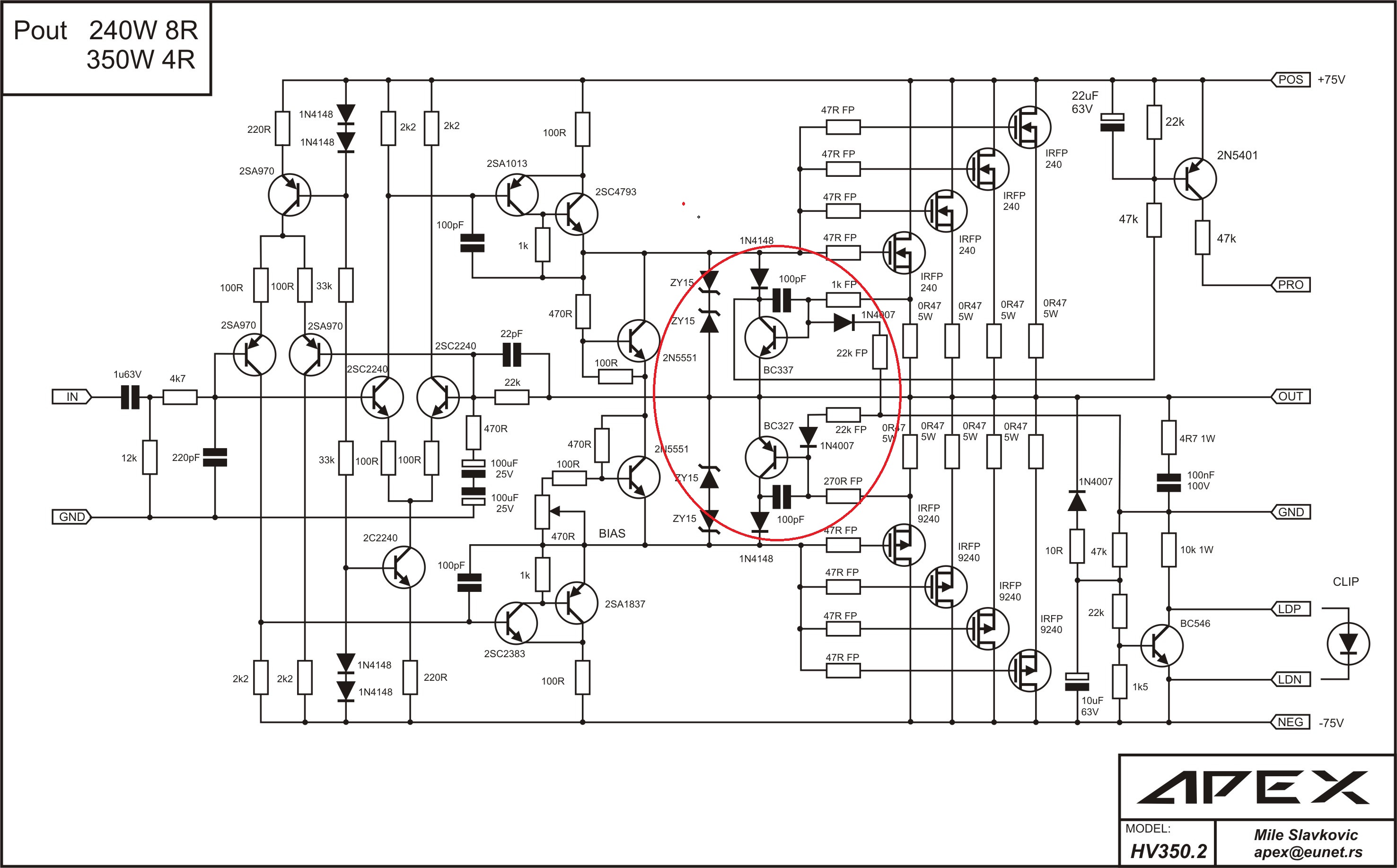

Mile lord, I'm trying to change the B500 with 1 pair of Toshiba, the question is how many volts the maximum that I use? to R 5 Watt, in the last section 0.33 R does have to be replaced?. I deleted some of the components as in the PRO and I do not use NSL32.

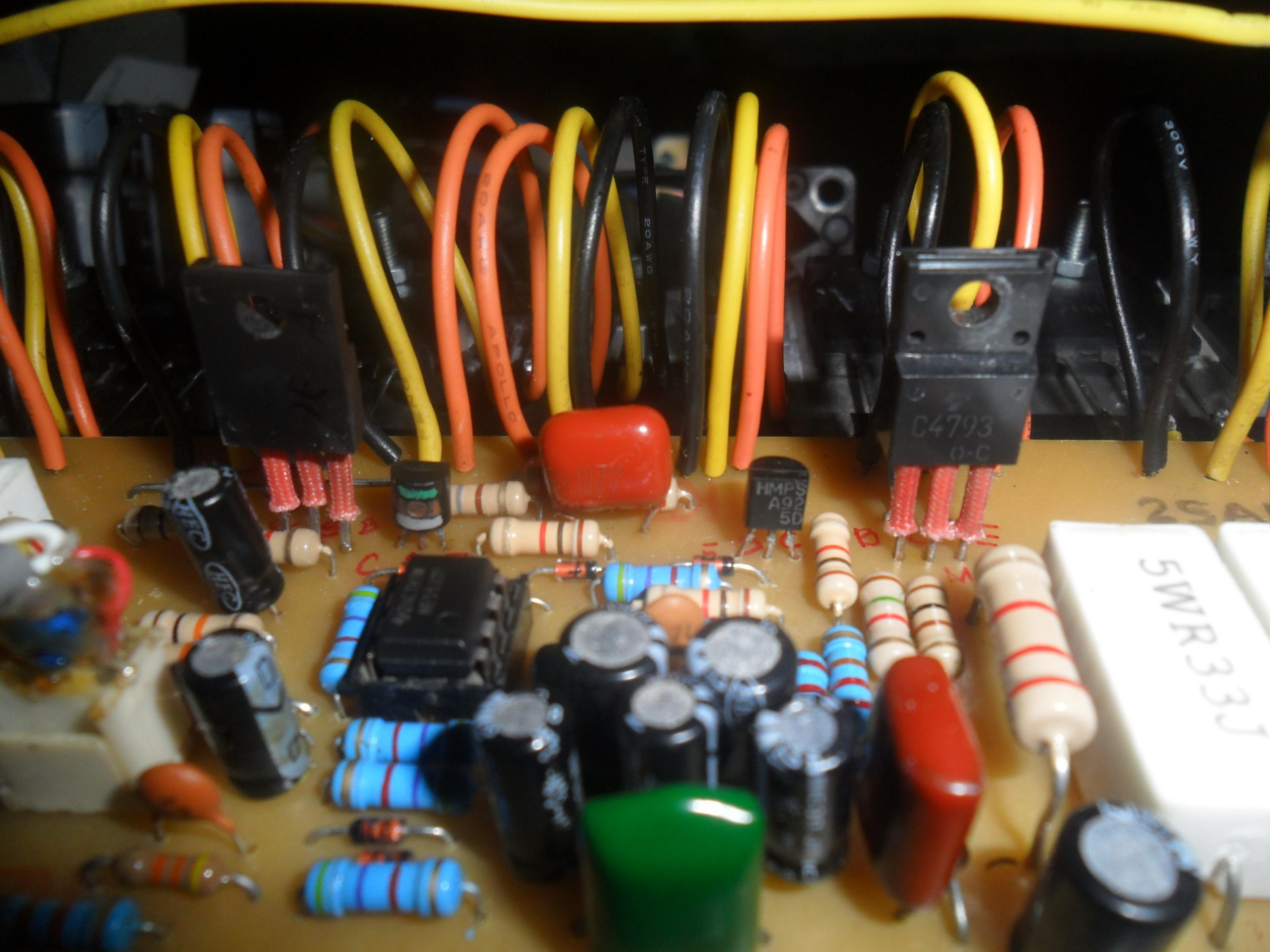

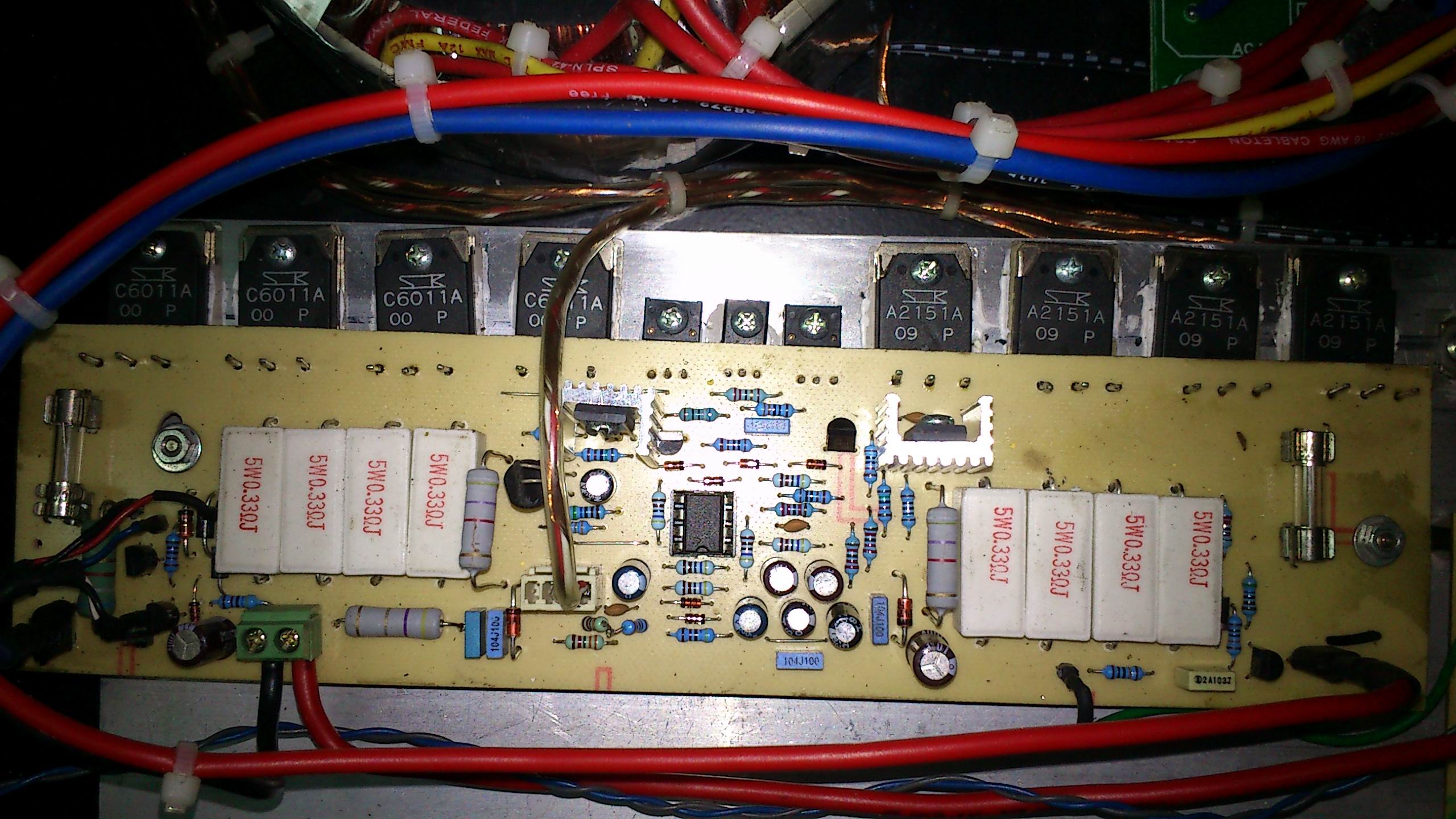

to MR. MIles thanks to your b500 it's another Milestone in audio circuitry, today i tested the amp very good sound, vocal is clear even i used subwoofer speaker and yet you will hear vocals loud and clear pictures and video to be followed,only problem i encountered is your PA protect when i connect to amp 100 watts bulb in series to primary of trafo glow and stays, and 10r 5w series to fuse voltage rails are quickly getting hot. something is wrong with protect.Mr Miles pls. check in short circuit protection diagram PRO terminal in series with 1n4148 in Board it's in wrong position i think pls. check MR.Miles, good day.
Short circuit protect is activ only with more than 9A current per outputs (2,8V on resistor 0,33R/5W) and you have AC signal on PRO terminal. You can't have this current with serial bulb and 10R resistors. Short circuit is stres for outputs and you can't have 100% protect, do not short circuit amp out it's risk.

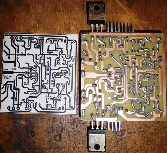

Hello Masood,

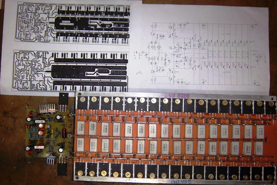

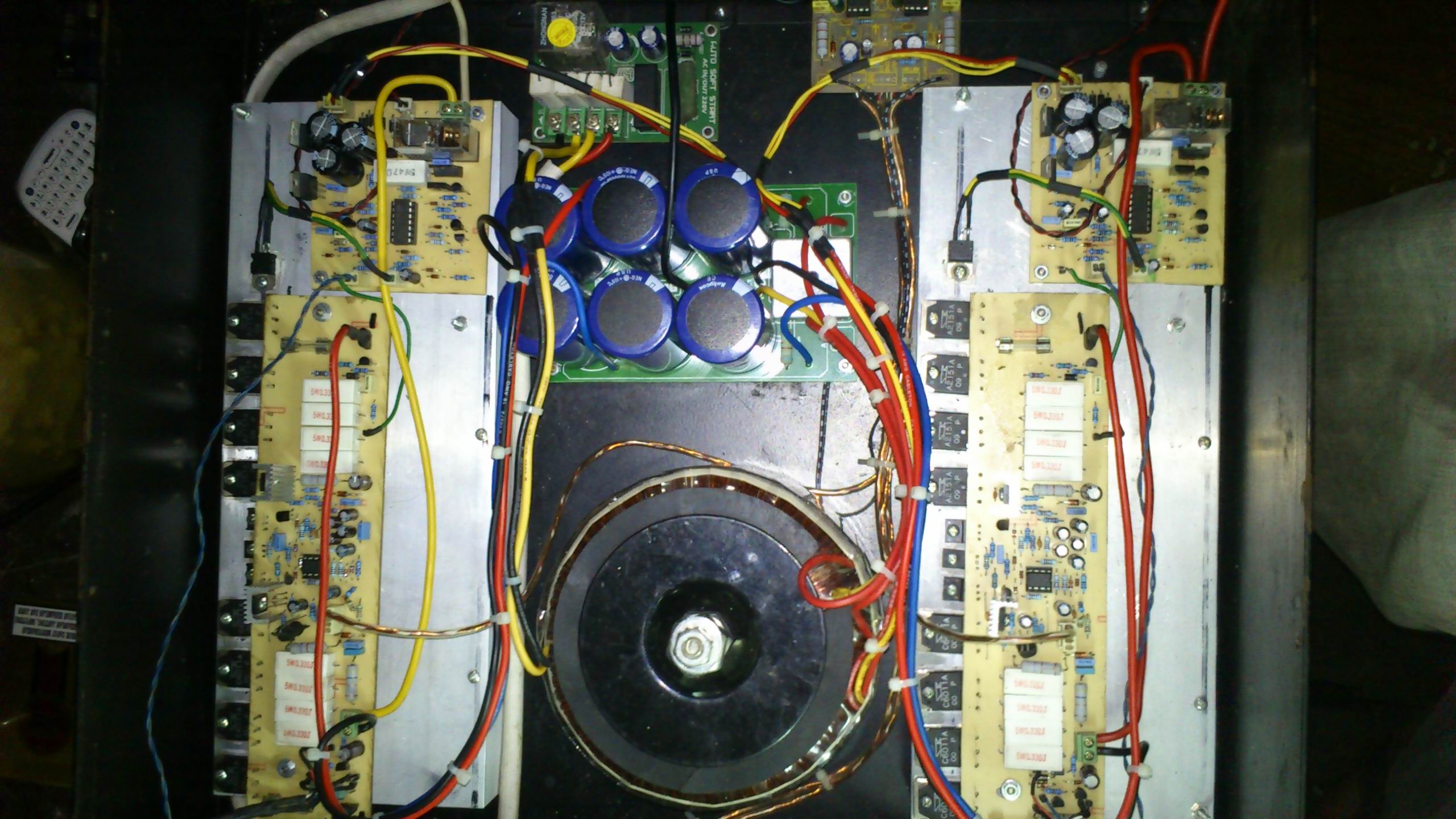

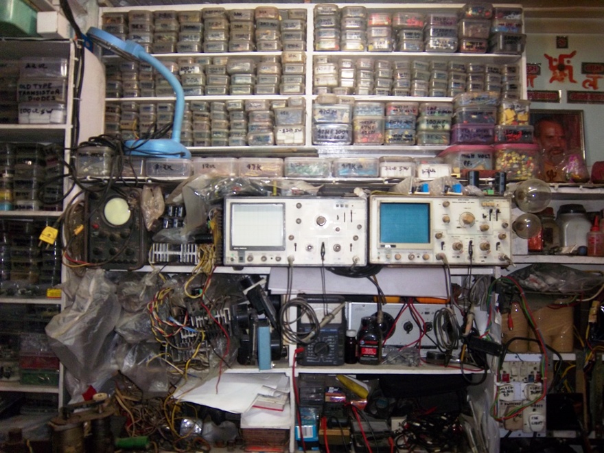

I am sorry I read you massage today only. I make my test p.c.b. by hand.This is hoe I do it .First take out a correct size print .cut and clean p.c.b. of same size . fix drawing on p.c.b. with tape on sides. drill all holes. take away the drawing. clean board with 00 no. emry. draw connection with camlin marker pen.Etch with ferric chloride. I am esndin photos of my recent work.
Regards

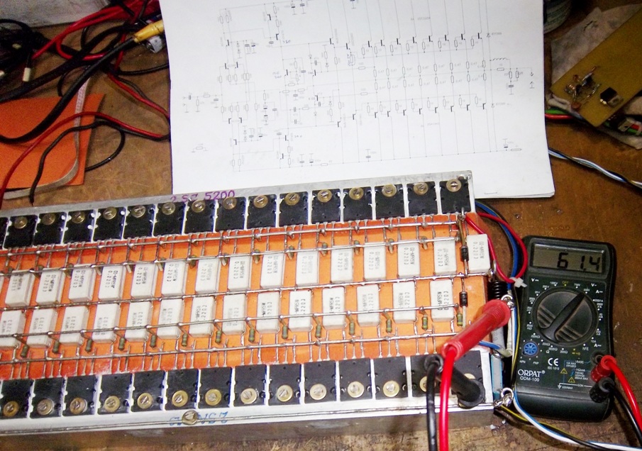

sorry miles i mean the amp not the protect, amp has shorts on copper lines.Mr Miles another question when i increase volume to maximum, protect activate need to reset to work again load test in 4r and 8r without tone control what could the cause?

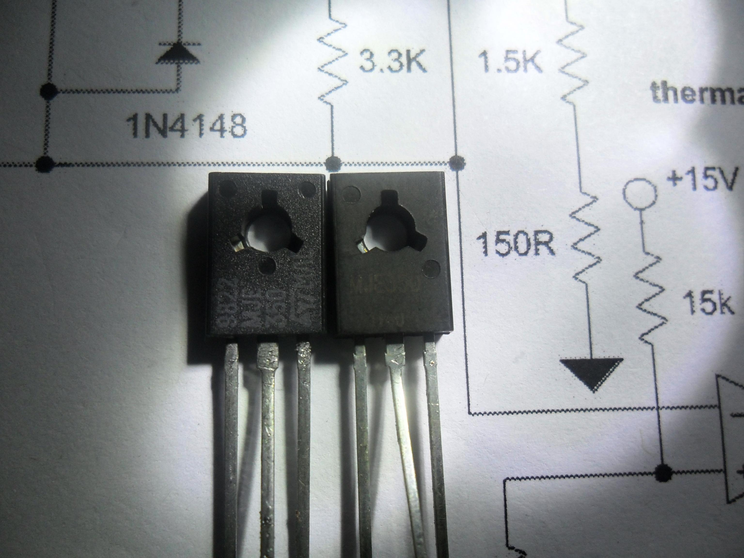

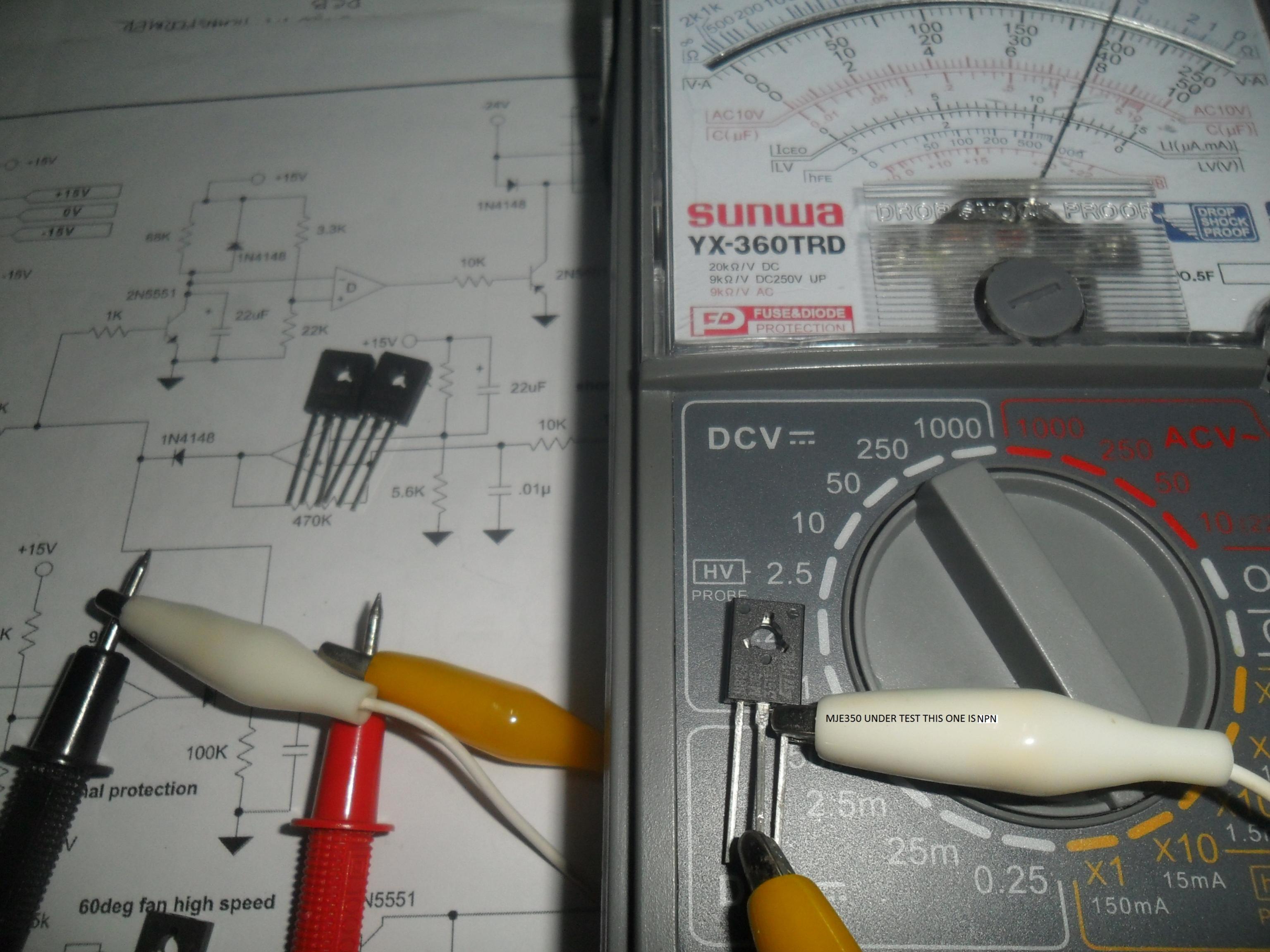

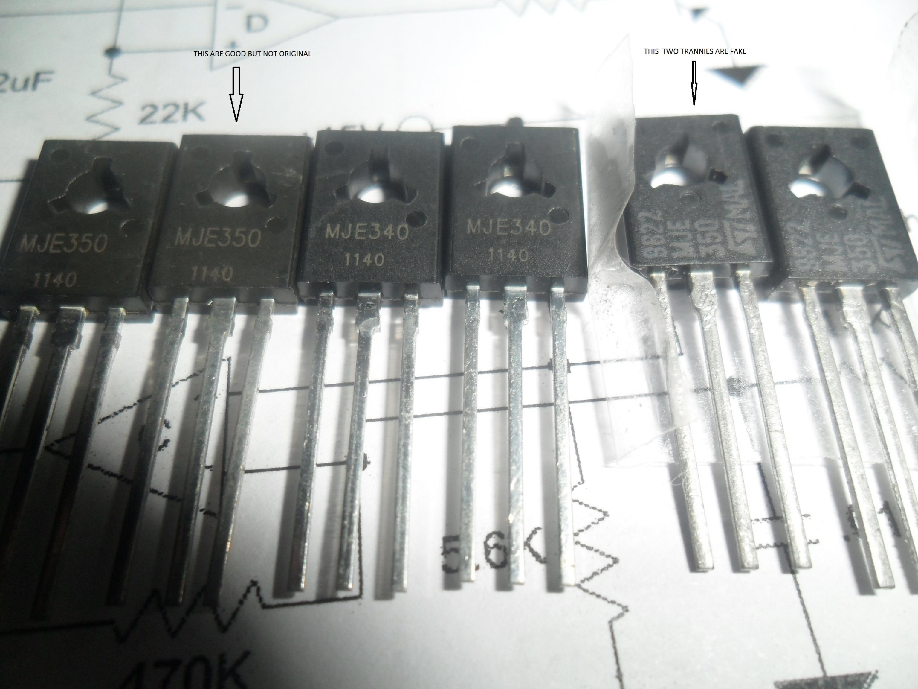

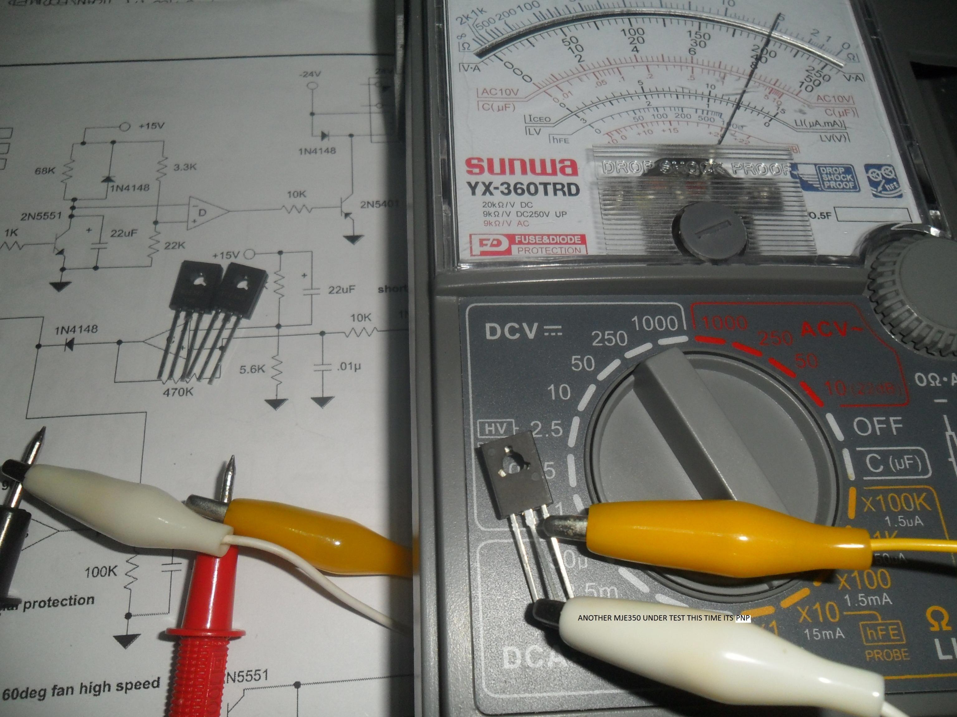

warning! MJE350 FFFFFFFFFFFFFFFake! two of the same thing different types, one is npn the other pnp. diyer's check first
