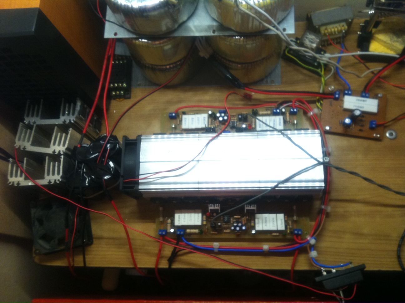

Thank you Mr. Mile..... I'm Trying to finish my second channel, i'm excited to hear the stereo of B500😉😉😉.

Credit for Mr. Miles/Apex,
Such a nice, powerful, noiseless and clear sounding amp.
In a low volume speakers like it's disconnected from the modules.
Wiljj78
Nice work,
Regards
Wiljj78
Awesome looking wind tunnel heatsink you got there...
Awesome looking wind tunnel heatsink you got there...![]()
Thanks.. Yeah..I salvage those from Bouyer AR 1150 Amp. from scrap.😉

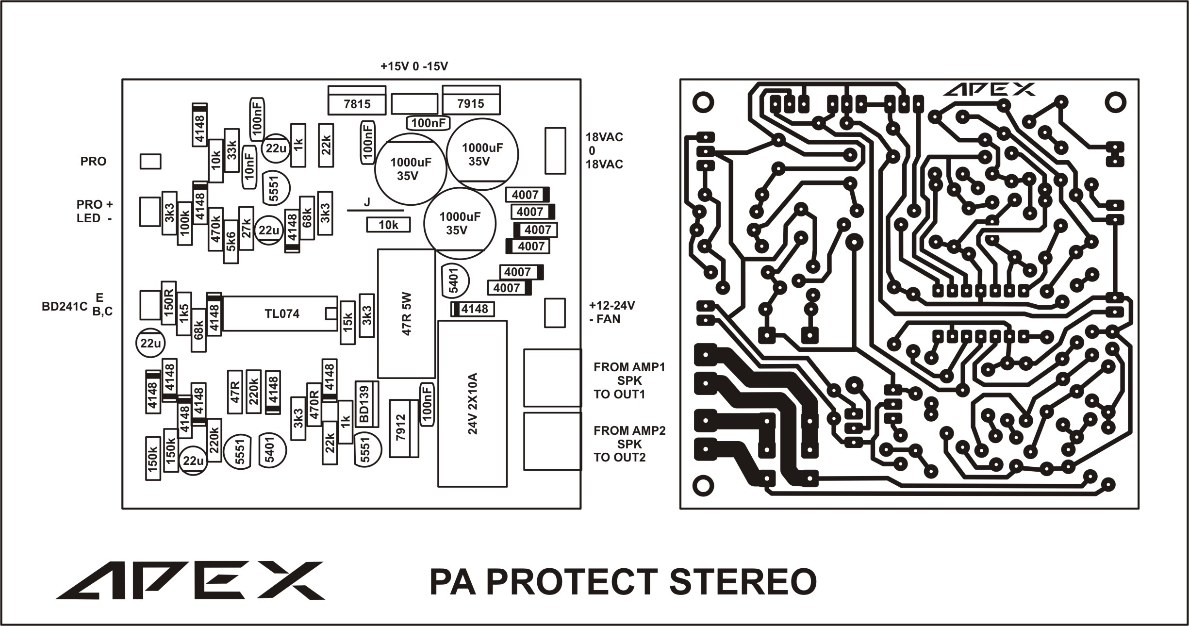

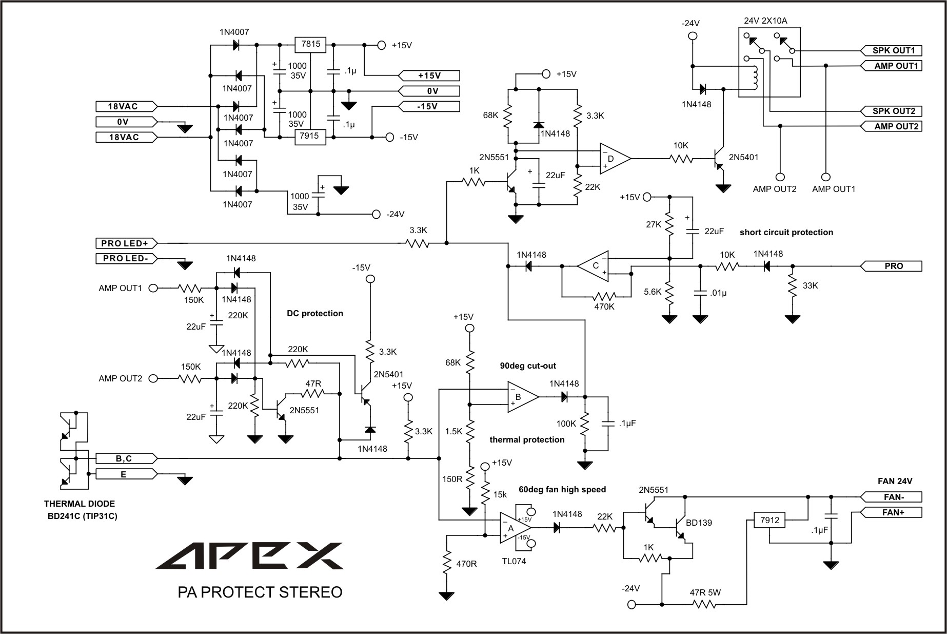

Mr. Mile,
Can you suggest PA protect for B500, i saw you post you don't recommend below protect for B500 and H900.
What is the correct protect to use for B500 or H900???
Protection is used with B500 and H900.
Protects against DC and temperature. Protection against short-circuit is bad, it will not save the amplifier from damage.
Ok, but i dont undestand why he don't recommend the PA stereo protect for B500 and H900 anyway Thanks Maxmud...
There is nothing wrong with using one stereovariante no protection, it will work well. But in idelae protection should be a separate amplifier for each channel. For accuracy and stability of operation.
You are lucky, I have been meaning to make my own tunnel heatsink for as long as I can remember. 😀
I got it!! meaning if i use separate protection for each channel it will only cut off accordingly when there's a fault occur either one of them, it make sense to me now...
Thanks you....

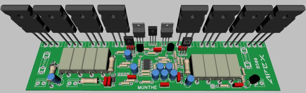

one of my favorite power APEX B500. I made a 3D version
Nice work.
