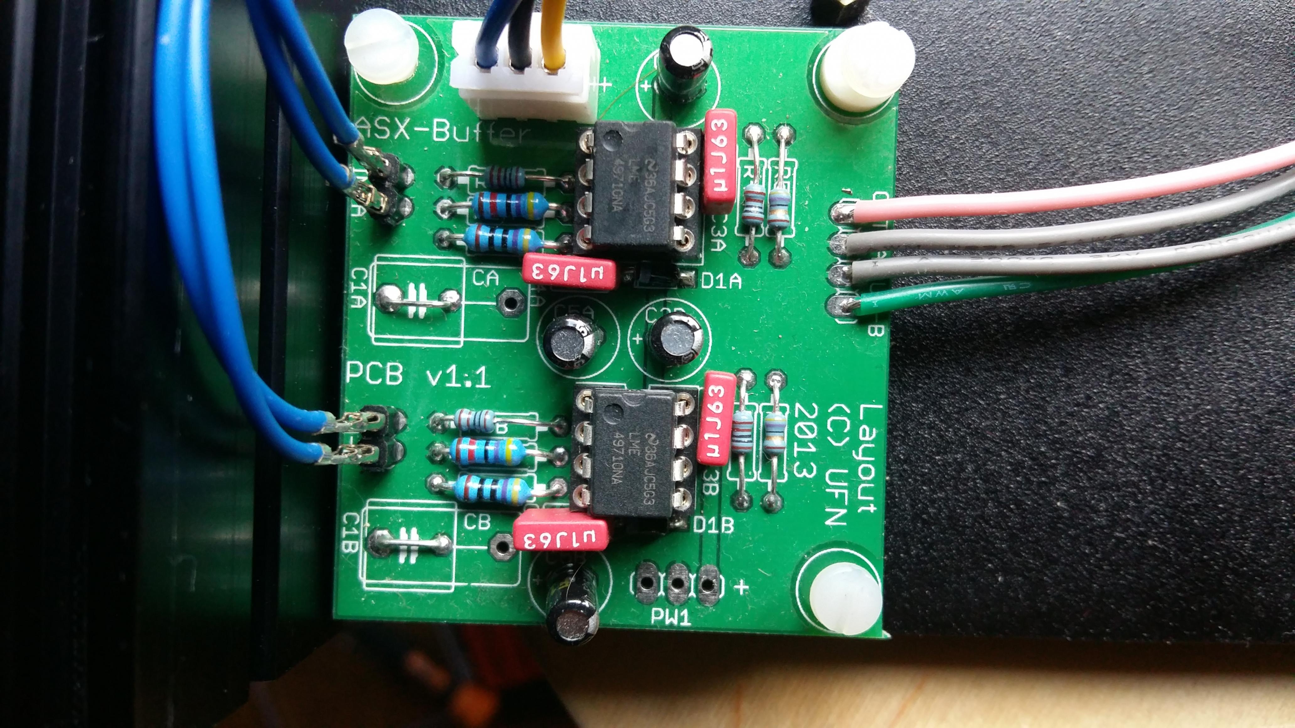

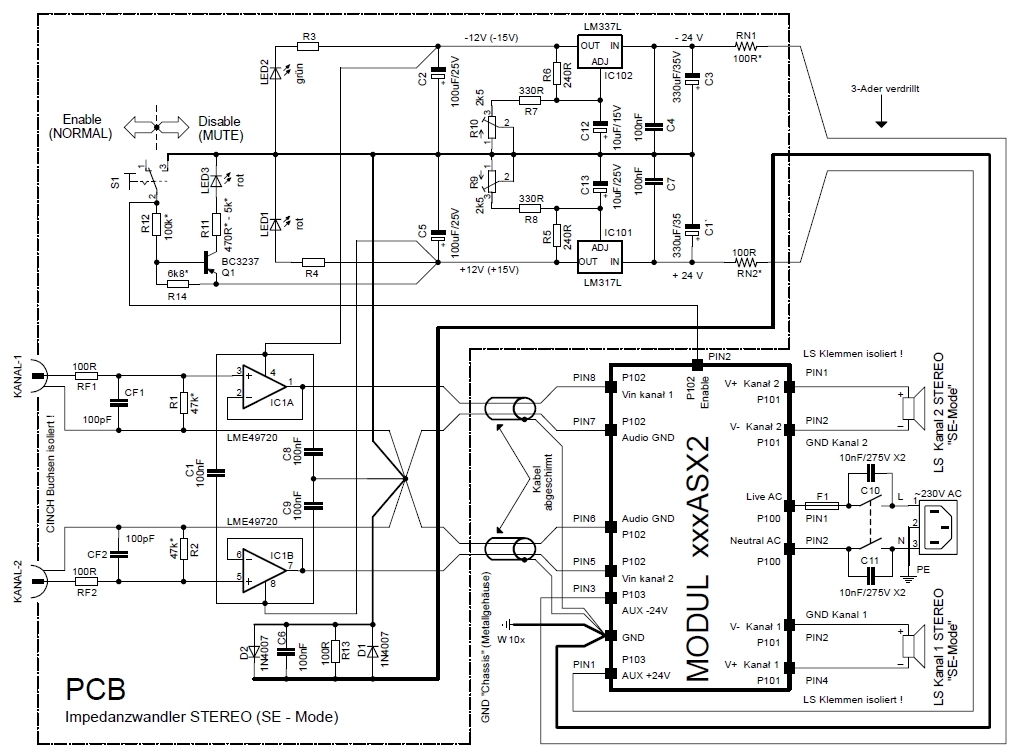

Here is a complète schematic with PSU section and pre-amp section for ASX SE modules :
Pre-amp section is not much different than this project that I use with 50ASX2 SE modules :
Project files: Opamp buffer for ICEpower ASX-modules | theslowdiyer

pguerin it's beautiful work. Thank you for posting. Very helpful.
Found this schematics on a german, forum 😉
But yes, very helpfull !

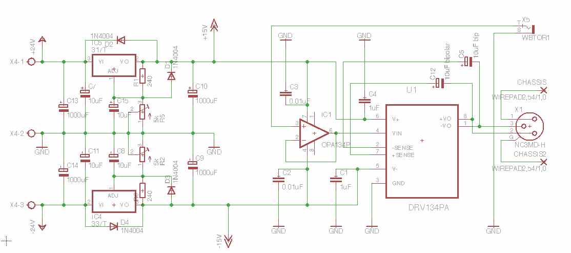

There some posted here on the forum, Ghentaudio's RTX Module (RCA->XLR) ( overpriced though) is based on the DRV134, there are cheap ones on the eBay (don't know quality) and it is easy enough to solder yourself on a small breadboard.Which one?
Why not a board based on DRV134?
This is posted on the DIYaudio forums. Looks like a good candidate.
