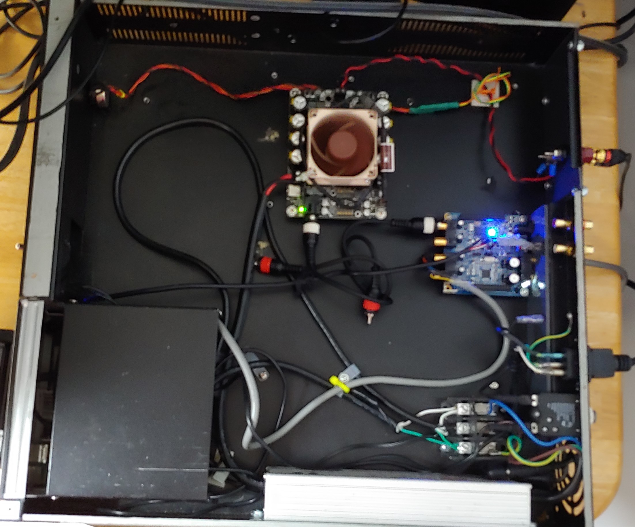

Thanks mga2009 for bringing this deal to my attention. I was able to pick up a couple and build a streaming BTL amp with them and a IQaudIO Pi-DAC Pro (balanced out) running Volumio. I crammed them in a BZ1907D chassis with a meanwell RS-15-5 power supply and an Adafruit rotary encoder (with debounce circuit). With the little listening I have done so far, the amp sounds great with a lot of headroom and a low noise floor.
silverD, that looks awesome!
I have been too busy to even test or unbox mine yet, but have been contemplating a similar re-housing of the amps. Did you have much trouble getting them out of the existing chassis? I guess you've bypassed the preamp on the board?
It wasn't hard getting them out. I removed the back panel and was able to unscrew and disconnect the amps to remove them. I'm not using the preamp board as I have balanced output from the Pi-DAC Pro and others had commented that it isn't the same quality as the ICEpower modules. The modules also come with the wiring harnesses which is a big plus.

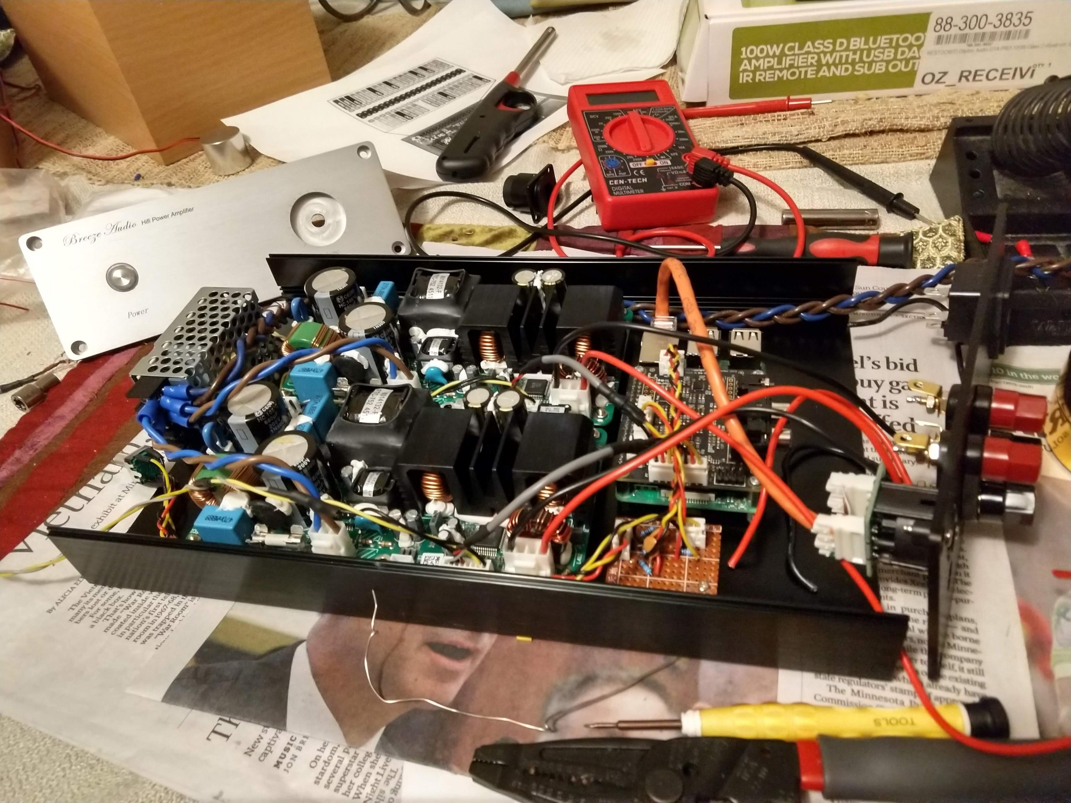

I've just modded my Vocopro 125ASX2 amp to be without any kind of input board/buffer, now I have direct RCA connection to the board, like with a Ghent kit for example.
My problem now is that the amp is extremely loud, I have to put my preamp to something like 8 'clock position, and it starts from 7 o'clock and goes till 5 o'clock. I believe at such low position it must distort quite a lot.
What can I do? Do I understand well that I cannot put any potentiometer (like and SMD DACT for example) between the preamp and the amp as it would ruin the sound?
So my only option is to put an SMD DACT before the preamp module? I don't want to use digital only volume control as I'm afraid a bad mouse click could destroy my speaker.

I still haven't pulled mine out but am wondering what the best course of action will be once I get them set up... Having the poor quality preamp bypassed sounds like a good start, but beyond that, no clue what if anything has been successfully done with them.
I would advocate for an input control on the amp, as I am still apprehensive about trusting computers 100% to do what you want and when. No way I'd want a $99 amp taking out $1000 speakers... But that's just me. Some people like to do electrical without disconnecting fuses too... But that don't make it seem right to me 😉
The most simple input stage for an amp is made from two resistors. As usually there already is an in series resistor at any amps input, you might get away with one...from input signal to input ground. If you have a powerful pre amp, try 600 Ohm to ground, if your pre is not happy in driving higher current, try 10k Ohm. You will have to open up the pre much more, but this way you reduce noise at the input, as it is reduced by the 600 Ohm resistor too. The ratio of noise to signal gets much better. There will be some kind of best combination with any amp /pre amp combination.
