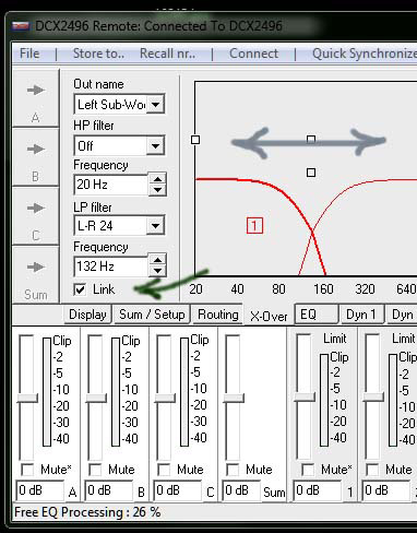

I can recommend not going above 135Hz for a midbass. When sliding the crosspoint from above down to 130Hz i get the snare drum dynamic in a single driver when the sub runs kick and electric bass. It's amazing and you dont want to miss out of that if going for a 4 way plus.

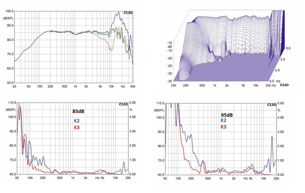

Here's some data for W4-1337SDF
TB SPEAKERS W4-1337SDF (Full-range 4", 8 Ohm, 50 Wmax)
Just make sure you treat those resonance peaks (Fs and breakup) and relieve the back of the baffle so the driver can breathe.
