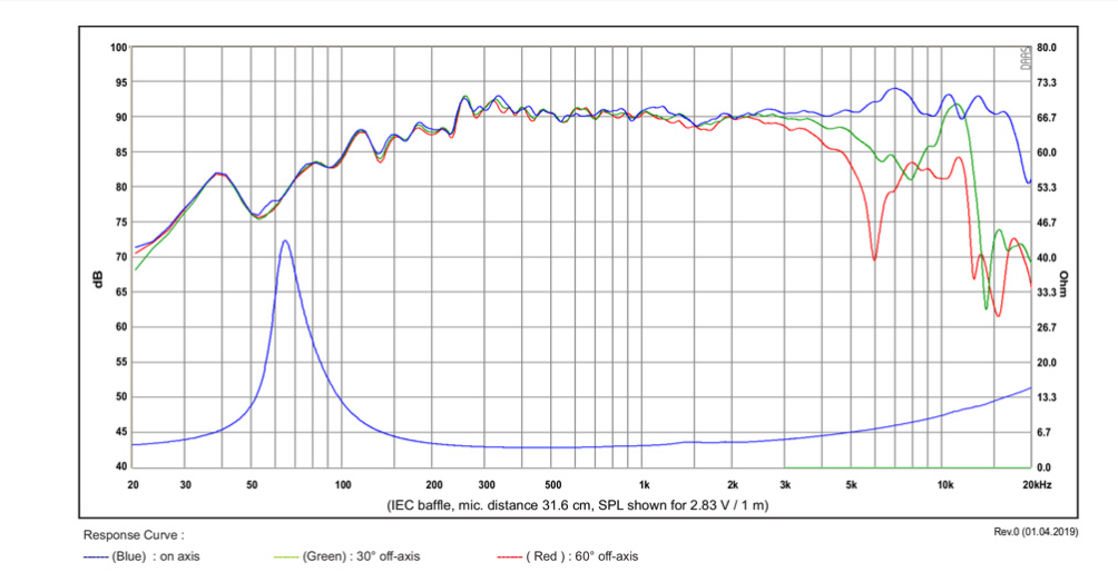

I'm not entirely sure what you mean by resolution. Where do you plan on crossing it over? Here is the manufacturer's FRD, it looks pretty good from 500hz to 4Khz, if you use it in that range it will very accurate. Funny, now that I look at it this FRD the peak and dip I described in my last post is not my cabinet but the driver itself. It also looks like I could add a notch around 6Khz.
It almost seems that when someone asks for this, they are looking for a driver which will have a smooth response without further eq. Of course it will also need to be blended into and part of a smooth system that works well with the room. Then a speaker might reveal what is on the recording.
With care and adjustment, an inexpensive driver might do this too.
(There are other possible definitions of resolution)
