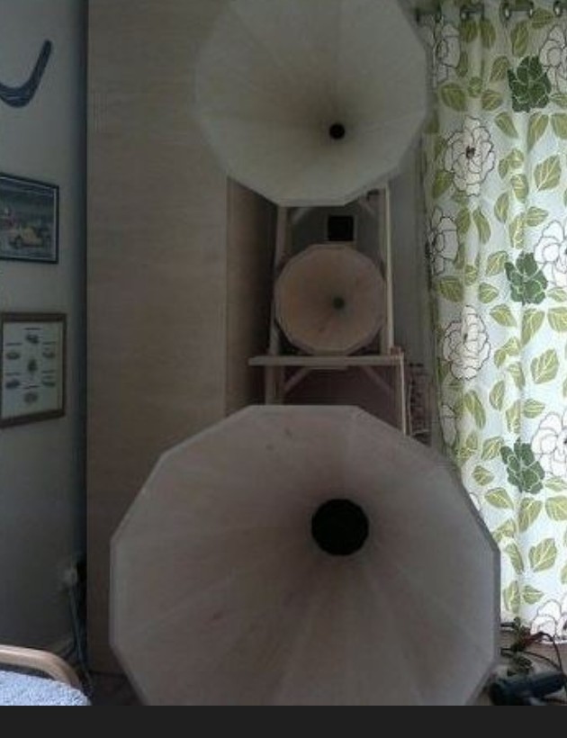

Been playing some more.
This time tweeter positioning.
Now at ear height and with much more room to breath. I was aware that they were rather in the shadow of the upper mid and mid horn before.
This is a temp fixing - I might try them at the same height as the upper mid centre - would look better perhaps, but sound wise?...
Ideally they would be in-line with the other drivers I know, but I have no room for that at present - perhaps I will try it if I cut the upper mid horn down by about 1/3, but I still think room will be tight.
Handy the stands are just proto's as I can drill and fix at will and try what's best
You will also see (perhaps not so well in the photo) that all the drivers are perpendicular to the floor but still time aligned. Mr Coco was right to ask/question the way I had them angled before when he was over listening, as I have now listened extensively to both ways this way is preferable.

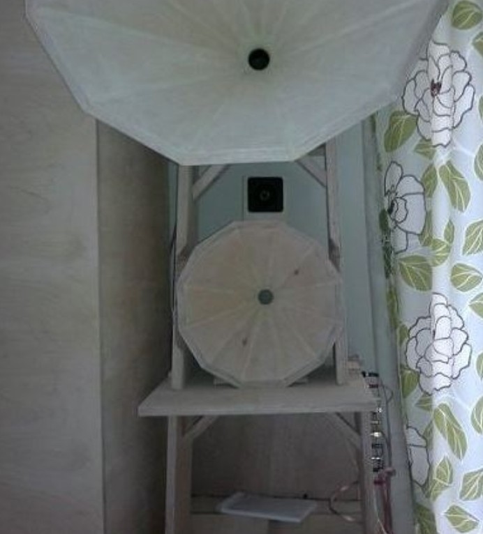

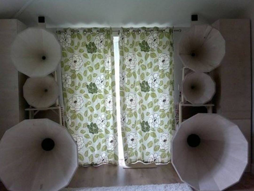

Today's DIY has been moving the tweeters. I found that they can sit on top of the mid horn right at the very top and sound quite nice. So now they look like little animals peeping out at the top - actually works very well as the ceiling skieling / slight vaulting slopes up away from the tweeter.
I perceive I am getting better imaging on vocals / upper vocals now as the drivers are all in line - the voice is nicely hanging in the middle when it should is you get me.
The other thing I did today was plumb in our external FM aerial cable to the music room. I have had a Denon Tuner since 1993 (was up in the loft for the last 13 years) but it is now belting out FM Radio of my choice with very good sig to noise ratio.
The tapped horns do very well 'coupling with the room' (as Mr Coco puts it), on pieces which feature a large scale organ or big drums etc - Jerusalem for example.
FM sounds better than Spotify streamed / compressed formats. But the Denon is perhaps only in the region of cheap and cheerful CDP really.
Next up some DEQX on the tapped and perhaps the midbass horns!

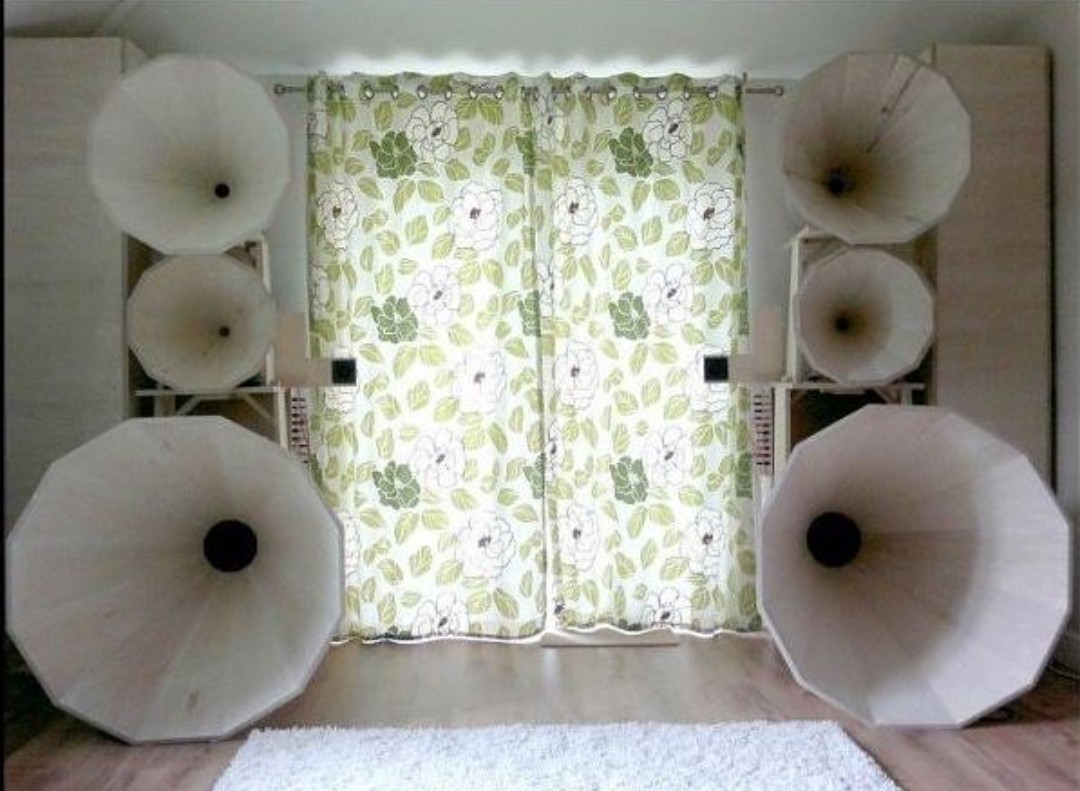

Well peeps, This evenings experiments have been to add a 2nd pair of terminal posts to the crossover boxes and bi-amp.
One amp for the tapped and mid bass horns and one amp the for mid, upper mid and tweeter.
This means I could remove the L-pad on the mid horn altogether and just run a skinny 5dB pad on the uber efficient 2435Be's.
The dB delta between the amps is taken care of by the volume pots on each amp. I am using the TVC as the master volume.
Bear in mind this is using two T-amps. So nothing is final or perfect.
This was prep for the crossover boxes for the next test (some DEQX) and also see what L-pad reduction gives.
So for the latter what gives then? Well after getting the vol balance between bass horns and the rest there is an improvement in mid and upper clarity, no doubt about that. More punch and snap to snares for example too.
More interestingly there is better detail and speed to the bass. too. The bass line is punchier (starts and stops) by quite some margin. Slap bass on some of my modern'ish jazz sounds great.

So this morning the table saw was a buzzin'. All down. The result is really rather nice.
Mr Coco's off the cuff calc in his head were spot on, conical length / cutoff point is not an exact science.
Easy-peasy chopping them down with a table saw. 12 zapps true and in line and its done.;-)
Now with the tweeters moved down (back to the first incarnation of the tweeter stands I first made 🙂 ).
Closer view
Nicely time aligned and with the narrow dispersion properties of the tweeters (as we already discussed) it's working really well.
The original horn size was for down to ~500Hz with the right drivers. I am using 1250Hz crossover.
Things are gloriously focused together and toneful (is that a word)?

Foam to absorb stray HF reflections
Further performance upgrade
I put acoustic absorbing foam on the top surface of the mid bass horn, under surface of the mid horn and thick felt a top of the upper mid horn to try it out.
WOW! HF is even clearer, refined / just right sounding. It was good before - meven better now.
Goes louder with much more composure too. These HF drivers are stunningly good. Lovin' he bass to of course
Of course some (perhaps lots) of the reflected sound waves are stopped and that lets through the sound in a less interfered with manner.
Interestingly I had to throttle back on the tweeter and upper mid horn amp vol a tad - less cancellation I guess.
Now just to think of a way of doing it that looks nice. One way will be felt with a sympathetic colour speaker cloth covering it - could be made to look ok. BUT this kit is all about sound and a certain function over form🙂
Here's how it looks now lashed up but sounding great. Can't see so much of it from the chair of course...
