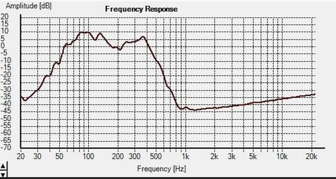

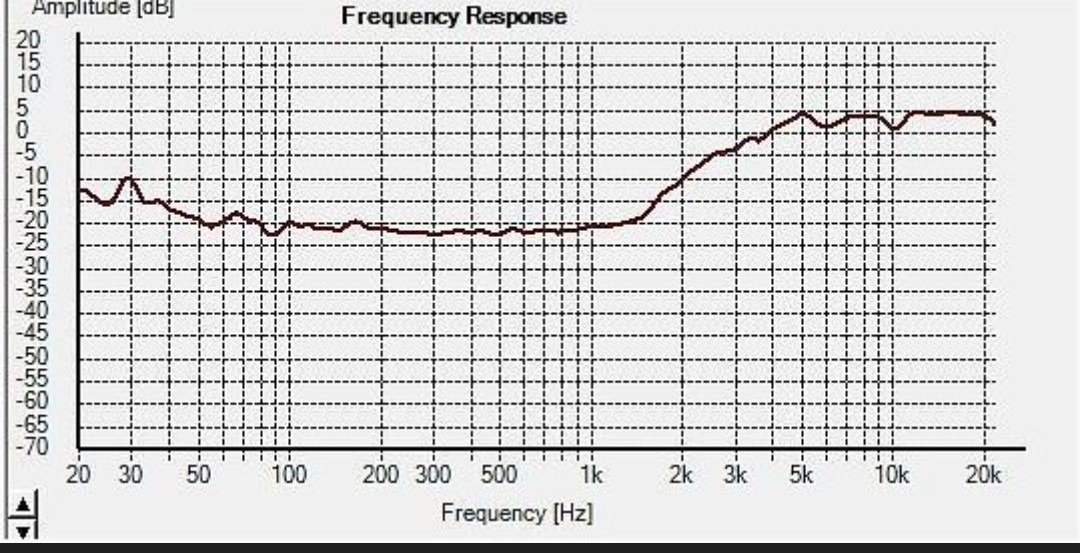

..did some measurements which showed I need to have a check over the lower crossover. Seems it crossing a bit high and there are a few ups and downs that were not predicted by hornresp. Room or driver variation perhaps.
Here's a sweep using Holmimpulse. 1/3 oct smoothed.
Need to revisit the throat size in the tapped horn vs the 100Hz peak and see or is it my crossovers?

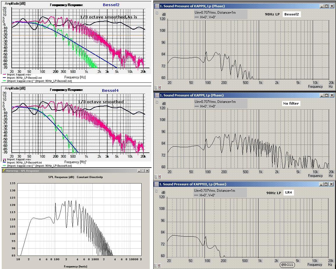

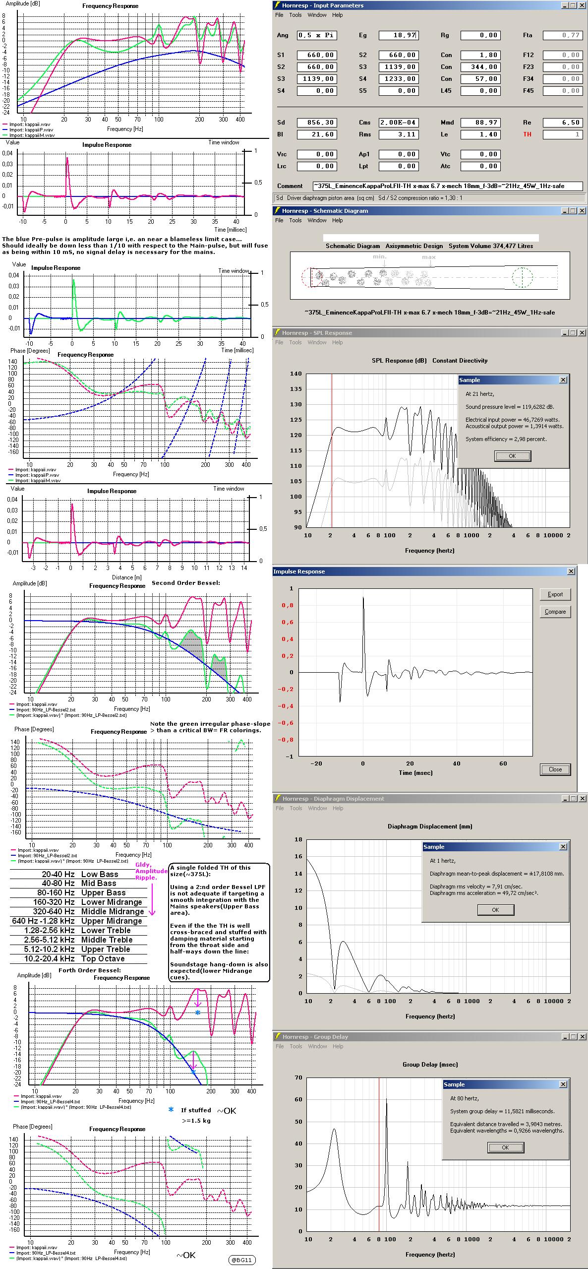

I looked at your HR simulation yesterday, see the first resulting picture,
A single folded TH of this size(~375L): Using a 2:nd order Bessel LPF is IMO not adequate if targeting a smooth integration with the Mains speakers(Upper Bass area). Even if the the TH is well cross-braced and stuffed with damping material starting from the throat side and half-ways down the line: Sound-stage hang-down is also expected(lower Midrange cues).
For Home use: IME,IMO a TH with Sd/S2 < = 1.5: 1 Smouth>S2 can be stuffed like an TL/TQWT or T-TQWT/T-TQWP in order to a great degree improve the SQ = Hi-Fi performance possible and only a marginally loss(blameless) of in-band efficiency.
The Pre-pulse is amplitude large( blue in picture) i,e. an near a blameless limit case. Should ideally be down less than 1/10 with respect to the Main-pulse, but will fuse as being within 10 mS, no signal delay is necessary for the mains.
Note the 'green' irregular phase-slope > than a critical BW= FR colorings.This phase should be brought down to improve good integration with your Main speakers..
Normally from my experience with HR and real measurements,even indoors is that they are very similar and only differs with some peaks and dips caused from the room influences.
IMO ,If you had posted a phase response too(,A single FR plot is worth less than 10% when looking at in total, especially for resonating enclosures) , you've told 50 % of the story and if added a non smoothen IR, nearly 100% would be covered.
Of course, it would be neat if you could post a non smoothen .wav IR file,,, here at DIYaudio...If not:
...Jumping to Sub-woofer forum where I almost found your identical posted design information: You are in good company here i.e. at 'sub-woofer forum', I don't recall seeing any measured IR posted ,or the very minimum: a printed one, that completes/reveals a useful (of quarter-waves relying sub) measurement that can be discussed analytically in order to avoid the typical nonsense text that often is added to the FR pictures in various threads.
today,I made an overlay on top of your recently posted measurement plot:The second of posted pictures:
A forth order filter seem adequate..a Bessel filter has no advantage over Bw or LR type of filter in this design as its more important for SQ reasons to suppress the off-band ripple than worry about 'timing' issues for the main IR and FR.

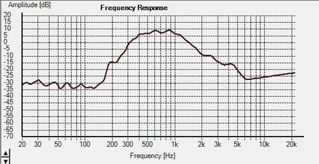

Wow thanks bjorno. I will take some time to digest what you have written. Quiet period at work perhaps🙂
1st thing I checked was the Zobel - I'd only mixed the Kappa 15A and Kappa Pro LFII zobels up! Sorted and it makes quite a difference but perhaps not enough as you say.
The Eminence do really seem to have a rising impedance and it needs controlling.
I will study further. I will take single driver plots soon too;-)

Any way back to the measuring of what I have...

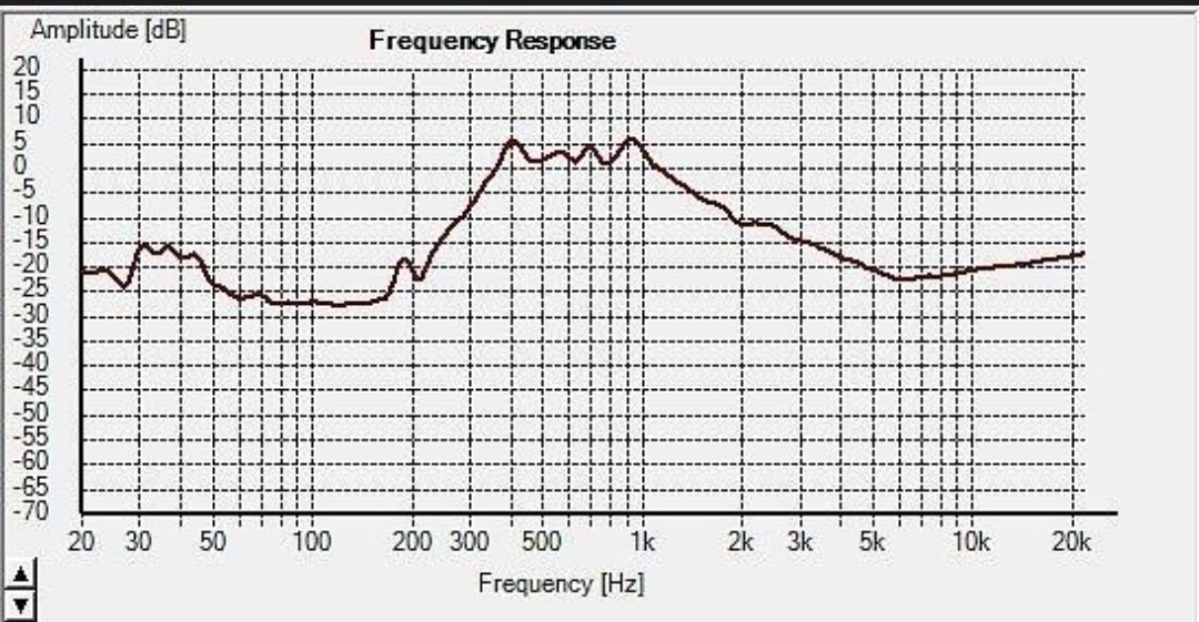

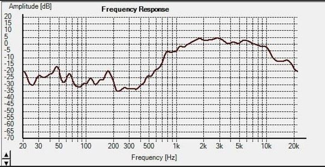

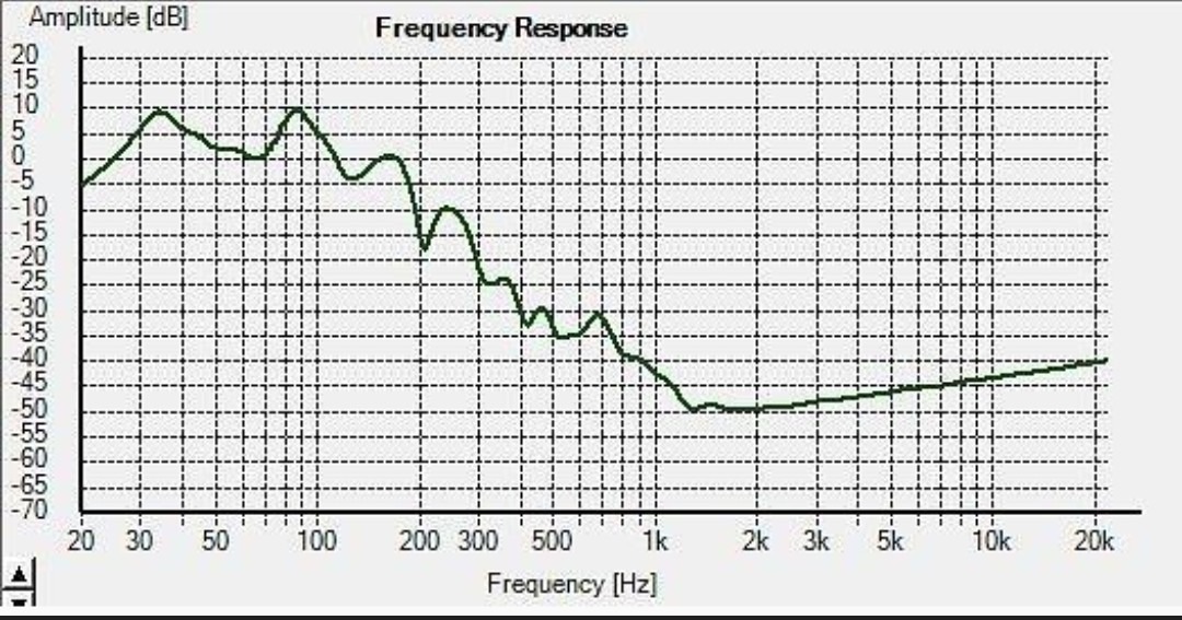

All same crossovers but the Zobel's corrected on Tapped and Midbass drivers.
1/6 oct.
Tapped horn 90Hz
Midbass 90-330Hz
Mid horn 330-1250Hz
Upper horn, 1250-9000Hz
Tweeter 9000Hz up
All done from close to the listening position and at ear height.
So there you have it.
Quite a lot of room affect, as to be expected. But the lugs are telling me it's pretty good.

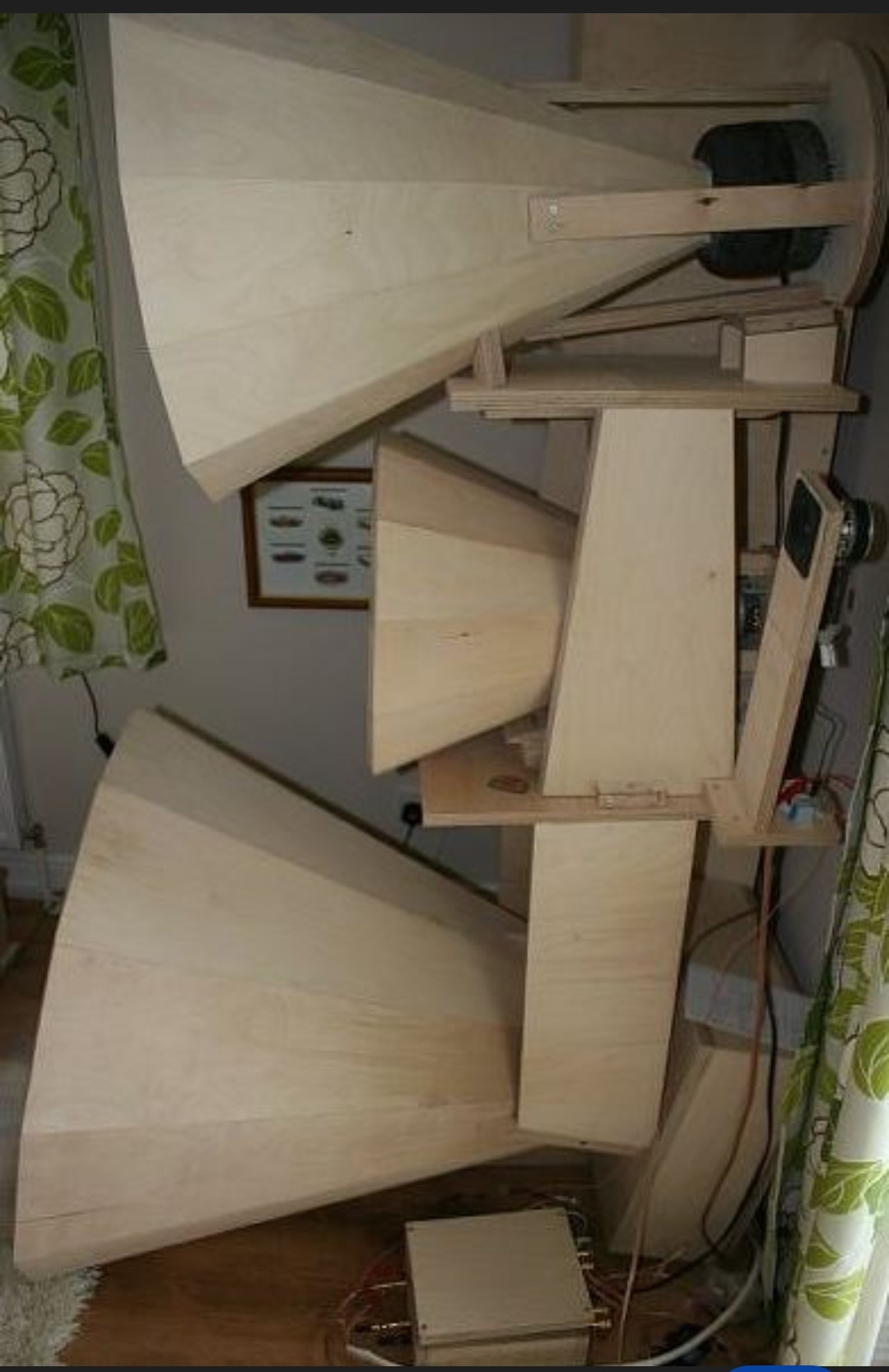

Today's fun was making all the drivers point straight forward (not angle up for the mid bass and down for the mid horn, towards the listening position).
I had already paralleled the mid horn you'll remember.
The mid bass horn required some little angle legs to go on the rear chamber, also added bigger pieces that distribute the weight across the horn.
First listening (something as corny as Robbie Williams - Swing when you are winning (wife likes it!), says that this how it should be. more cohesive sound indeed, mid bass integrates better with mid horn.
I planned to try various positions and angles and this is part of the of learning to use this kit with the room. Problem is to find the time and listen lots and lots...
That's the last time I want to lift the mid horns up onto their stands for a while...
