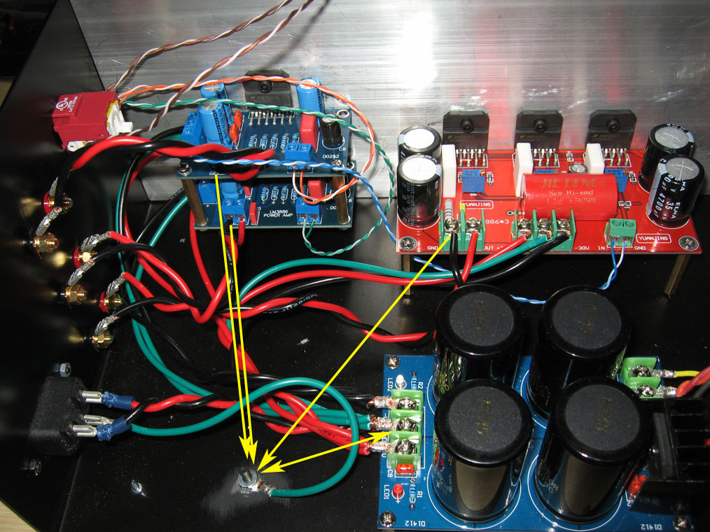

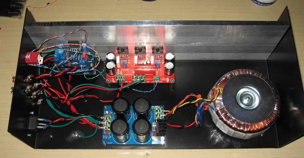

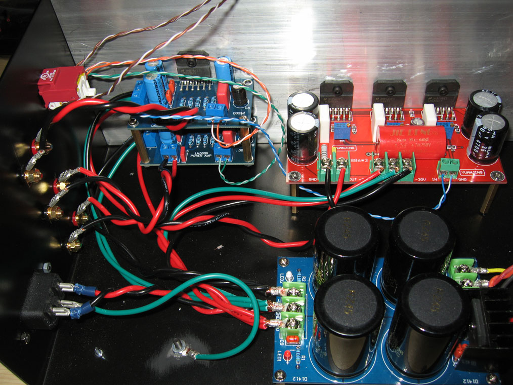

Noisy 3ch amps from CAT6 cabling
Hello gentlemen. I posted a couple of entries on here a while back about making dedicated 3 ch amps for my mains and using CAT6 for signal path from an active xover.
The amps are assembled. With CAT6 cabling hooked up ...TERRIBLE! The twisted pair ends are hooked as they should be to the boards and unhooked on the other. NOISE noise noise. Tried with and without grounding the amp.. no change.
But there's more: I removed the CAT6 input cables and hooked up a standard RCA to a source..... CLEAN as a whistle!
Pics attached. Can someone see something that's not right?!? 😕
Thanks!
Ben

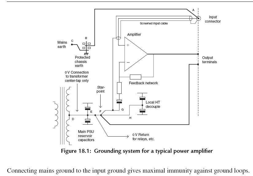

Here is a nice image of optimum ground
courtesy of Douglas Self.
IT makes more sense tor un your speaker ground return to power supply rather than the pc board ground.

In my experience that ain't quite the way to do it. Doug Self is fairly well known for measuring rather than listening - if he'd listened to alternatives he might not have made that particular suggestion. The change I suggest is the screen of the input cable should not share a spur with the ground for the feedback network (G). Give each its own ground.

Therefore I should be hooking up the speaker grounds to a central star ground along with the DC supply ground? See arrows in attached pic.

To start of with the ac mains runs virtually the whole length of your enclosure. Could be improved also it is running under the psu board not very safe . also i would sugest you solder the safety earth direct to the iec receptor. what if the push on connecter came a drift and touched the live mains conection. your cable twisting could do with some more twisting and try to keep inputs outputs and dc power in seperate twists and away from each other as much as possible . also where is the mains fuse?????
Nearly there a few things to sort out and you will have a safe working amplifier..
Best Reards Ian. Ps when uncle andrew t see's your amplifier he will hit you with a big stick
Technically no
You should connect speaker ground return to ground tab on power supply.
But i doubt that your ground loop that is prucing your hum comes from your speaker return. They are probably generated due to your multiple RCA / audio input ground connection points.
You need to have one input ground connection point. The image from Douglas self's book in my first post shows RCA's ground's to connect to star ground.
THAT is why everything goes quiet when you only connect ONE rca , because you have one grounding point. If you connect the multiple input grounds they NEED to all be in one point.
hope my explanation is clear.
look very carefully at the image in my first post.
