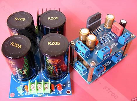

5 channels:
500VA 25 0 25 transformer for 5 channels.(giving 35 0 35V)
at least 100uF per voltage rail at each lm3886 cheap (10 total)
At the very least 20000uF per voltage rail just after bridge diodes.

5channels @ ~60W into 8ohms. The PSU sees a load of 8/5 ohms.
I would estimate you will hear changes by increasing the +-20mF to +-60mF if your 5channels are all wideband.
If you filter all 5 channels so that low bass is not fed to them then you can reduce the smoothing capacitance, but you must also reduce the high pass filter frequency at the input of each of the 5channels and make the complementary reduction in the NFB DC blocker as well.

Id just clone chipamps.com power supply and just beef up the diodes.
Yes you need 2 bridges, one fore B+ and one for B-
If your set on fc/fm (they are nice arnt they) just use 2-3 instead of 1 big one, this helps even more because it lowers the esr.
Andrew is harping on the fact that higher notes dont need as big of a capacitor bank, so if you wanted to just use fc/fm, you could get away with 5,000uf. Infact it might work out well since your caps will have a lower esr then stock. The could be an option only if your setting all your speakers to small in your dolby digital menu of your preamp. If your running your fronts full range then dont reduce your cap bank, and dont adjust your input dc blocker caps.

With one rectifier, the rectifier needs to be rated for twice the current as compared to if you used two. So just look if the diodes you want to use come in the required ratings. Maybe you want to use "fast" diodes and they don't come in 20A? So it comes down to practical conciderations

I would suggest using 40000uF on each voltage rail. This should be AMPLE for 5 channel above 80hz source and be MUCH more than enough for when you do stereo full range or stereo above 80hz.

For the power supply i wanted to keep the build easy and trouble free.
I Used two of these rectifiers:
http://www.wind-turbine-supplies.co.uk/images/Square_Bridge_Rectifier.jpg
35A 400V. DIRT cheap. Works perfectly. Very strong. No PCB tracks , wires from Toroidal secondary soldered DIRECTLY onto them. Bolting them onto metal surface of enclosure.

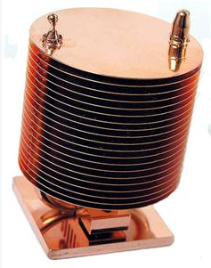

Copper heatpipe heatsink (for CPU cooling) for each amp chip, ganged in a single row and single fan cooled
What I'm thinking on doing is pair up in 3s. One pair for the tweeters, one pair for the midranges and one pair for the woofers. Each pair having their 40 000 uf filter supply (since they come preassembled as such). Only thoughts on this is that I'd like to double two chip board pairs for extra power for the woofer section (100W at 8 ohm - at 35 V rail). Problem is I can't find any info on the feasibilty of bridging to preassembled chip boards. Anyone
