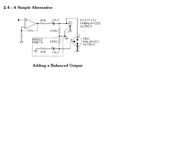

So, since the DCX2496 is balanced I will add a balanced circuit in the amp. I'll obviously need 3 (3 ch amp). I've quickly gone through this site about balanced entry to amp but unsure about what I truly require.

you can convert the DCX2496 from balanced output to unbalanced output by two simple almost no cost methods.
Short the Cold Pin to the Ground Pin in the receive end of the cable. Label this plug appropriately.
or
connect a dummy load resistor from Cold Pin to Ground Pin.
The Hot Pin voltage will change when you swap between the two methods, although when I tried it the Hot voltage did not change. I never investigated why it didn't.
The dummy load resistor could match the Rin of your amplifier/receiver.
You can convert any unbalanced output to a quasi balanced (impedance) output that can feed any balanced input. The "Quasi" part is due to all the signal appearing on the Hot Pin and zero volts signal appearing on the Cold Pin. Balanced inputs don't care where the voltages come from, they read the difference in voltage and amplify that difference.
Go to Jensen (or maybe it was Rane) and find the app note that describes the various balanced and unbalanced connection options. Copy the quasi balanced. It needs two resistors and one capacitor.

The scenario is this: As soon as I plug in the first UTP CAT cable into the input stage, noise and lots of it. That's with the other end unplugged from the driver (DCX2496). But when I plug into the driver the noise slightly reduced (as long as the driver is switched on).
Test with STP CAT cable: Same as above; unplugged from the driver and plugged into receiver gives me same noise. HOWEVER, when I first tried this I connected the exposed shield on the receiver end with alligator clipped wire to the Audio Ground. The noise was tremendously reduced (no hum) ..but still had a small amount of hiss coming from the midrange and tweeter. It was low enough to be acceptable.
Now when I go through the same exercise, no change to the ever present hum and hiss. Still as loud as it was before testing with the STP cable.
I've also tried grounding the shield at the driver end to either Pin 2 and Pin 3 (with signal ground) ..no change. Now I know for a fact the hum is ground looping back into the signal. The hiss I'm not sure if this is airborn noise being picked up by the CAT cable or a higher pitch of the ground hum.

I think your noise problems have nothing to do with your choice of UTP or STP.
I think your amp is wired up wrong.
