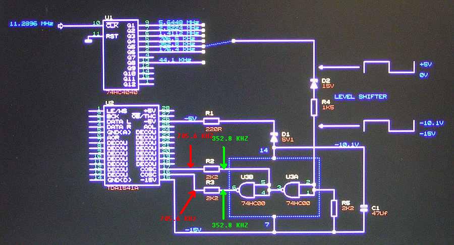

Well, here is the screen shot,
The other 3 TDA1541A chips can be connected to pin 6 of U3B and pin 3 of U3A, using 6 extra 2K2 resistors (R2 / R3). One could experiment with the 5V power supply for U3, the voltage across U3 power supply pins (7 and 14) must be around 5V.
The circuit receives the DEM clock from a divider (U1), different DEM frequencies can be tested for best audible results. The clock divider is driven by a 11.2896 MHz master clock or the MCK output from a CS8412/CS8414/CS8416 (pin19) or the system clock output PCM2706/7 (FUNC2, pin18).
U3 (74HC00) provides the differential DEM signals and correct DC offset (clock signals are referenced to -15V). These signals are fed into inputs 16 and 17, forcing the on-chip DEM oscillator circuit to follow the external differential clock signal. The DEM oscillator won't oscillate due to the external drive signal properties.
Finally have time to build this circuit for test, but I got different results, I got 705.6 khz at pin 16 and 17.
Did i make anything wrong? I follow the exact circuit to build.
