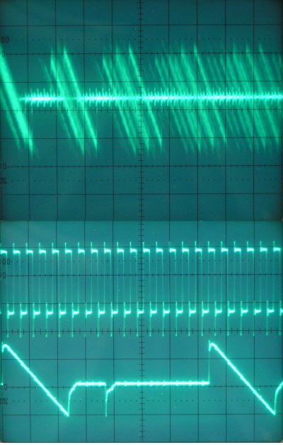

The best way of synchronizing the DEM clock is injecting a differential external clock signal into pins 16 and 17. So one non-inverted and one inverted clock. The frequency must be a multiple of FS (usually 44.1 KHz) and must run in sync with BCK. Practical external DEM clock frequency could be 352.8 KHz (BCK divided by 8).

How to explain with 470pf between pin16, pin17 and connecting only pin16 together of each TDAs, I found the sound is better? Is this something to do with the DEM clock, how?

Hi John,
If all DAC chips still have the 470pF connected between pins 16 and 17, The DEM oscillators will oscillate at a frequencies between approx. 150 and 300 KHz, but they don't run in sync. By connecting pin 16 of all DAC chips, there will be unpredictable interaction between the 4 DEM oscillators, in some cases this may lead to better perceived sound quality. But it's not optimal and usually not stable (performance keeps varying).
I attached a photograph to illustrate what's wrong when only using the 470pF external capacitor. The upper picture illustrates how the DEM clock looks like when the chip is processing data (pin 17). The DEM clock looks a bit better when the DAC chip receives no data. The oscillogram shows severe jitter (frequency fluctuations) that will lead to bit errors as the time averaging is no longer accurate.
The lower picture shows what happens when the DEM oscillator is forced to run synchronous with an external low jitter clock signal that in turn runs in sync with BCK. Now the DEM clock is locked to a low jitter crystal clock, timing is much more accurate and bit errors are reduced.
The upper trace shows the BCK signal (2.8224 MHz), the lower trace shows the synchronized DEM clock.
