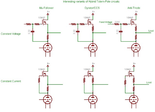

Yes you're right Erik. It is 1/gm of the cathode follower. My wrong.
Actually I measured Zout in the past. Looked on my notes and I measured about 450 ohms ( using two different loads 500K and 10k). Still not 1/gm of the Jfet ( I am using BLs so the transconductance must be 5-6mA/V and up).
Ale, instead of a "gyrator" load have you tried using the mu output of a CCS? See lower left schematic in the attached figure vs upper left (similar to your arrangement, really a mu follower not a gyrator). Similar low impedance output but one less signal path cap needed.
I use the CCS mu output in my 26 preamp with great success. I use a circuit similar to yours in my 833 amps to drive the 833.
Hi Magz, indeed. The mu-follower output is what I've been using for years for both preamps (4P1L and 01a) as well as for drivers (e.g 46 DC-coupled into 814). As you experienced for sure in your outstanding amp and preamp, you get best drive and very low distortion.,I also prefer the sound of this topology, that has been my experience so far over the years.
Hi Magz, indeed. The mu-follower output is what I've been using for years for both preamps (4P1L and 01a) as well as for drivers (e.g 46 DC-coupled into 814). <snip>
Can you describe your impressions compared to an transformer coupled amplifier stage?
