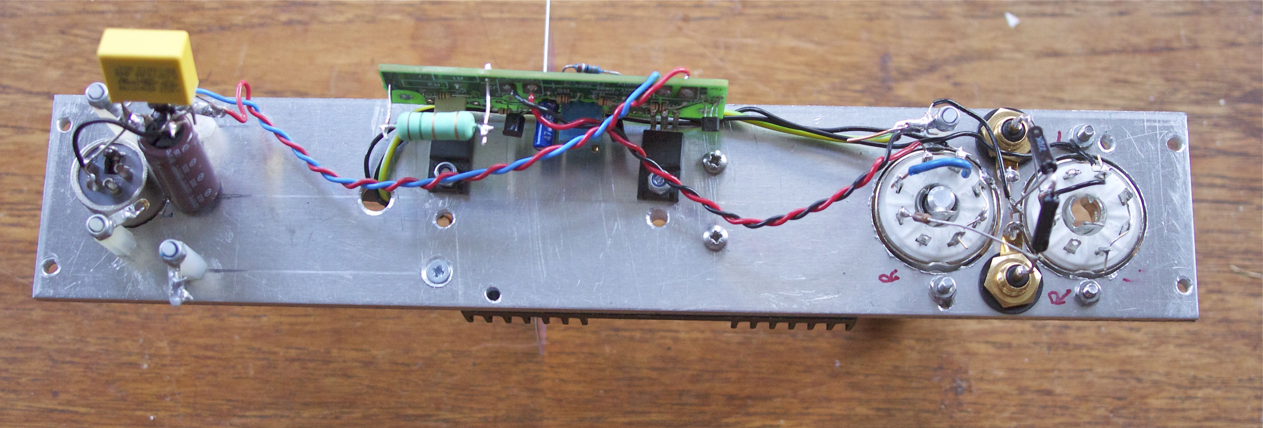

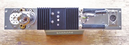

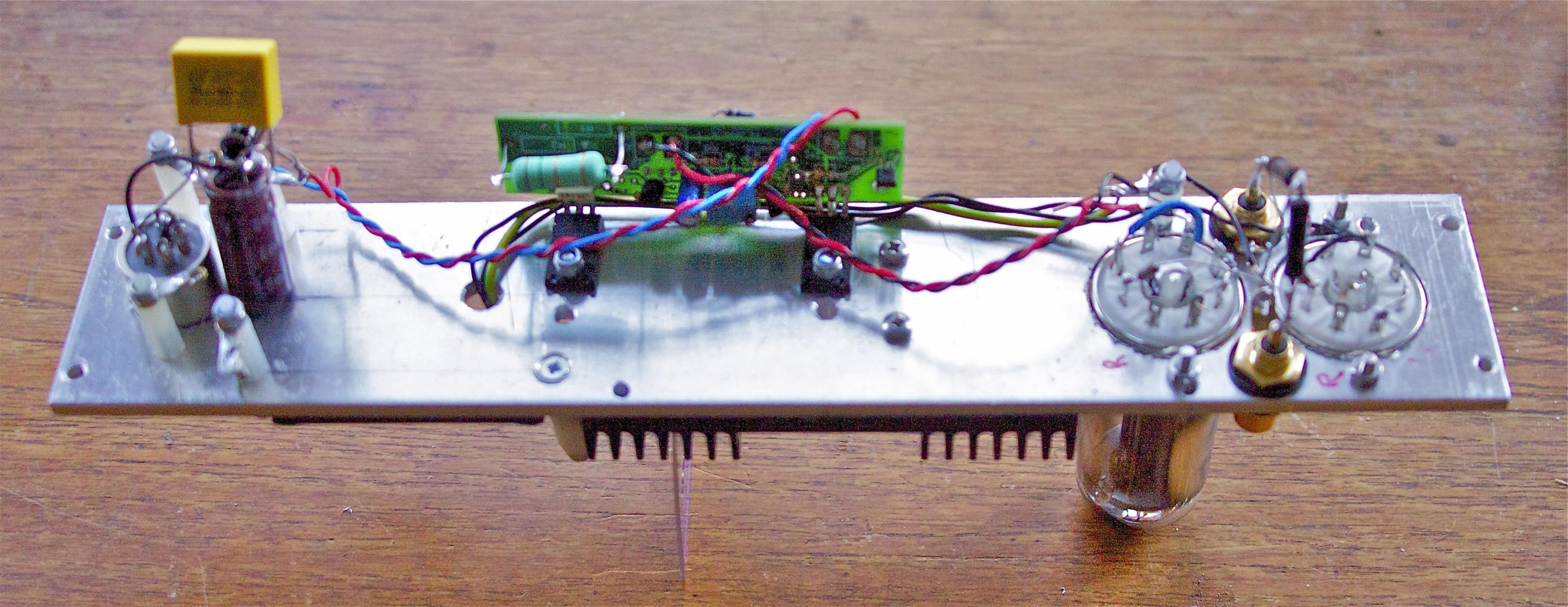

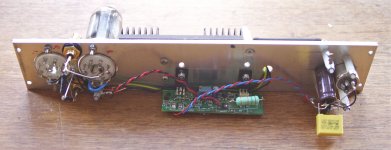

Au contraire, mon pote...... I love my metalwork. Made this today - my "line stage on a module". It fits into my modular amp, made of 19" subrack 2U parts. The module is 50mm by 275mm.
I admire that metalwork that you made, too, but I was thinking of that 6 sided box monster, rather than a single. elegant piece of aluminum. 🙂

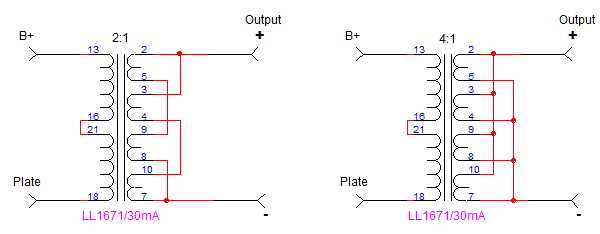

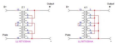

OK, thanks for clarifying that. I understand. The LL1671 output transformer can be connected 4:1 or 2:1, so there is a "natural" way to provide a 6dB gain difference.

Hi Kevin,
will you show, please, how to wire 2:1? (A+B and B+A in parallel?)

Hi Kevin,

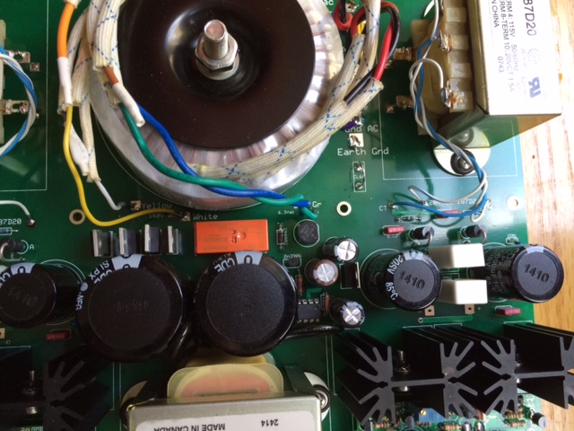

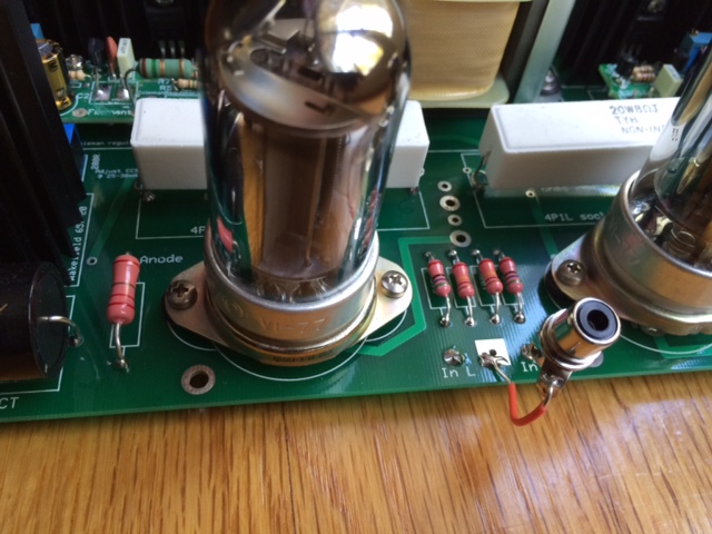

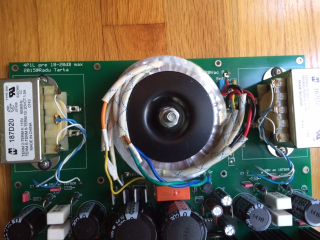

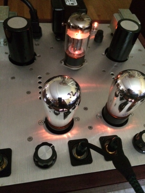

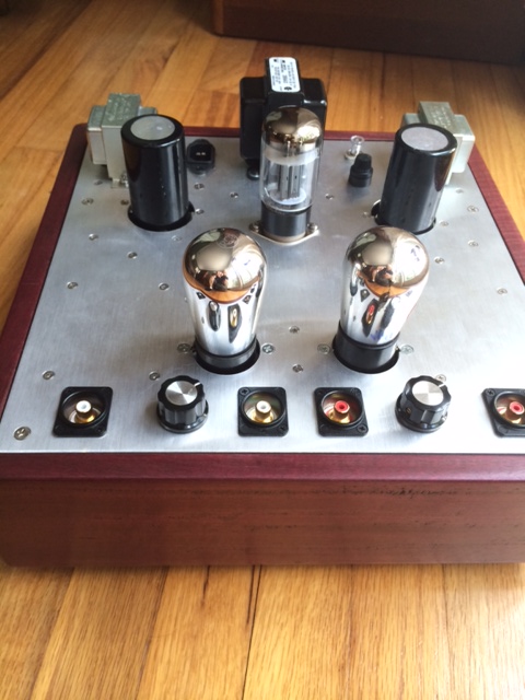

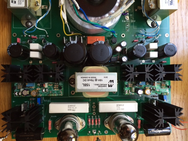

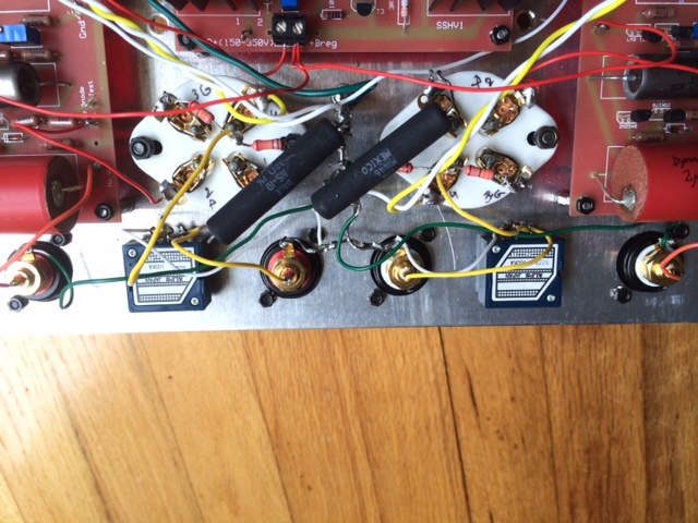

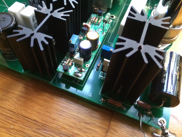

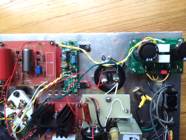

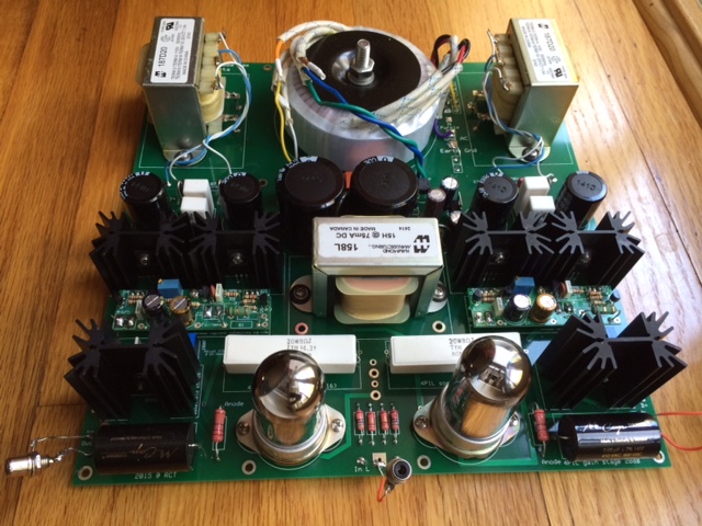

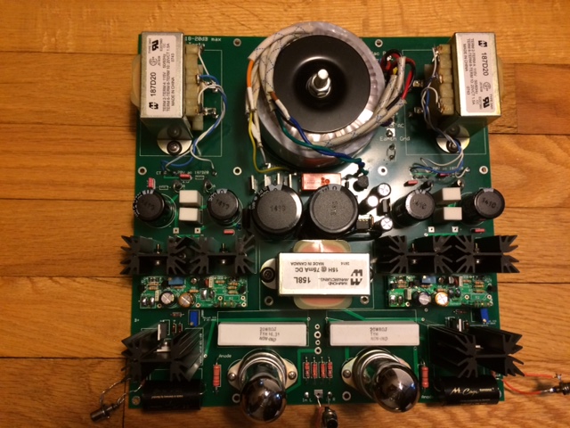

PCB for a 4P1L gain stage
Now back to 4P1L:
4P1L gain stage (about 19dB) compact for use with First Watt F4, and not only

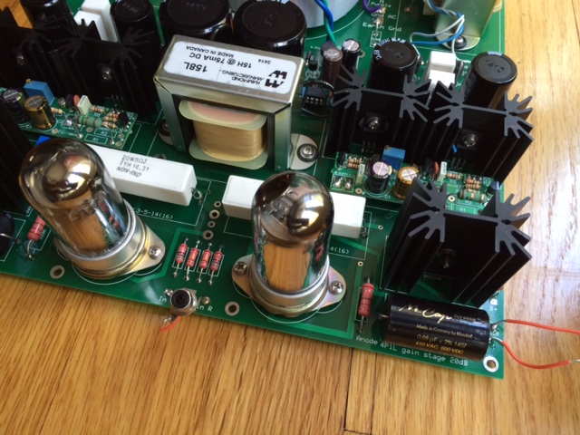

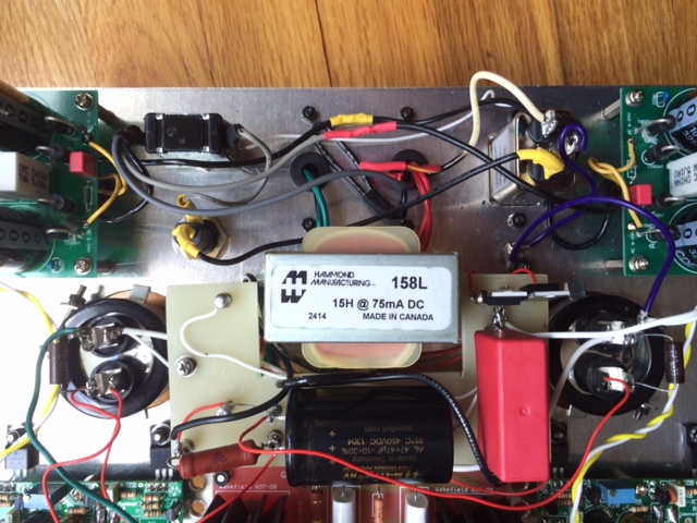

In this era of miniaturization, I always tried to make a tube amp reasonable compact. After long hours of experimentation, I came up with this compact 4P1L gain stage. There is room for improvements and modifications depending on what it will be used for.
Almost everything is on the PCB: transformers PSU, Coleman regulators, tubes and ancillaries.
The power supply uses 3 transformers ( one of the 187D20 for each filament, and one Antek 50VA 160V for the HT.). Ht supply is filtered by a CLC (470uF-15H-470uF). The raw supply for the filaments uses 1n5822 and CRC 10mF-0.47R-10mF. The Coleman regulators need to be preassembled except the power transistors who are mounted on 2" Wakefield heatsinks. The 4P1L is biased at about 115V Uak, 35mA and 560mA starved filament. The load for the 4P1L is a cascoded DN2540 CCS.
The PCB measures 266mmx274mm. It was much cheaper to order it on 1.6mm thickness and I provided many holes for support. One can use Aluminum stand-offs to make sure that the board stays rigid.
The only thing of concern is how the 4P1L's socket is attached to the board. I would use neoprene damper sandwich mount, rubber rings and even a dead weight.
I made few extra PCBs. Whoever is interested, I am selling 3 boards.
I have a BOM for this PCB.
Best,
Radu
