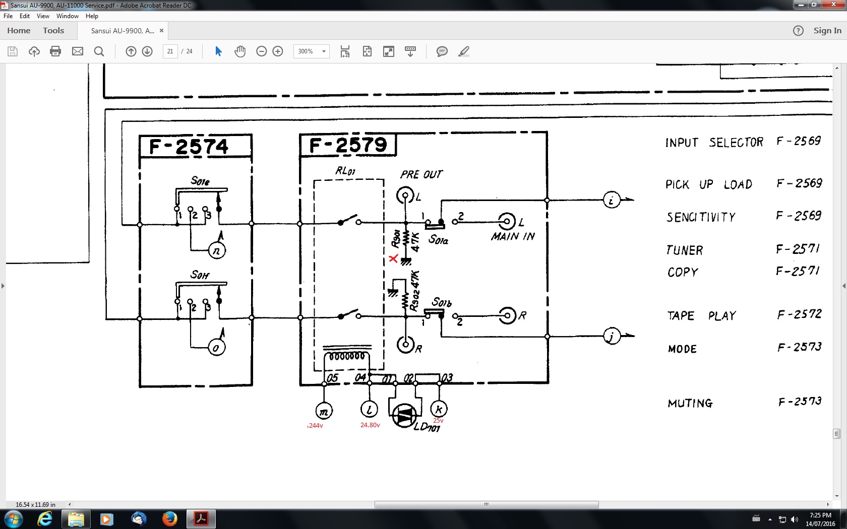

The green light doesnt come on anymore!The redlight turns on at power up but turns off when the relay is supposed to cut in? The LED reads 1.5v one way and 1.8v the other way on my DMM diode setting. I took the pre amp/power amp switch off and found an earth wire broken on the left channel. So that sounds like the wiper earth problem? Ive checked out the reg/protect board F-2568 but cant find anything wrong there except for D03,it read a bit low so I changed it for a 1N4148. D01,1N60 has a forward voltage of .380v.Ive marked the voltages in the schematic. I think M pin 38 was 1v before instead of the .244v now! Thats if I remember correctly? X marks the spot where the earth wire broke off. It might be an oxidised wire at the switch connection thats causeing this so Ill change them. (theres a few wires there) Once I find this green light problem its fixed.lol😀

So this is a totally different issue we are talking about now ? The power amps are OK and all is working apart from the LED ?

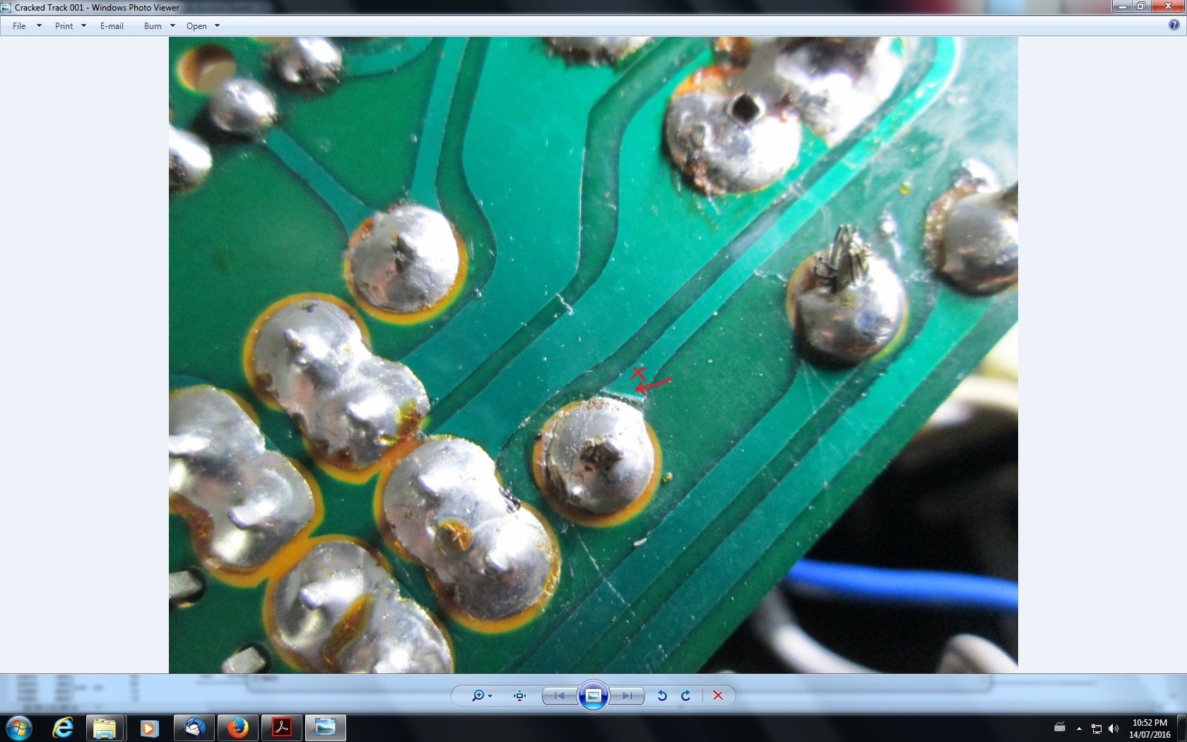

Yay! I just had a look and found it! It was a cracked track on the power supply F-2567 near the relay. Ill put the amp back together tomorrow and bias it and let you know how I go Mooly,it looks to me that its fixed but you never know. lol 😀
