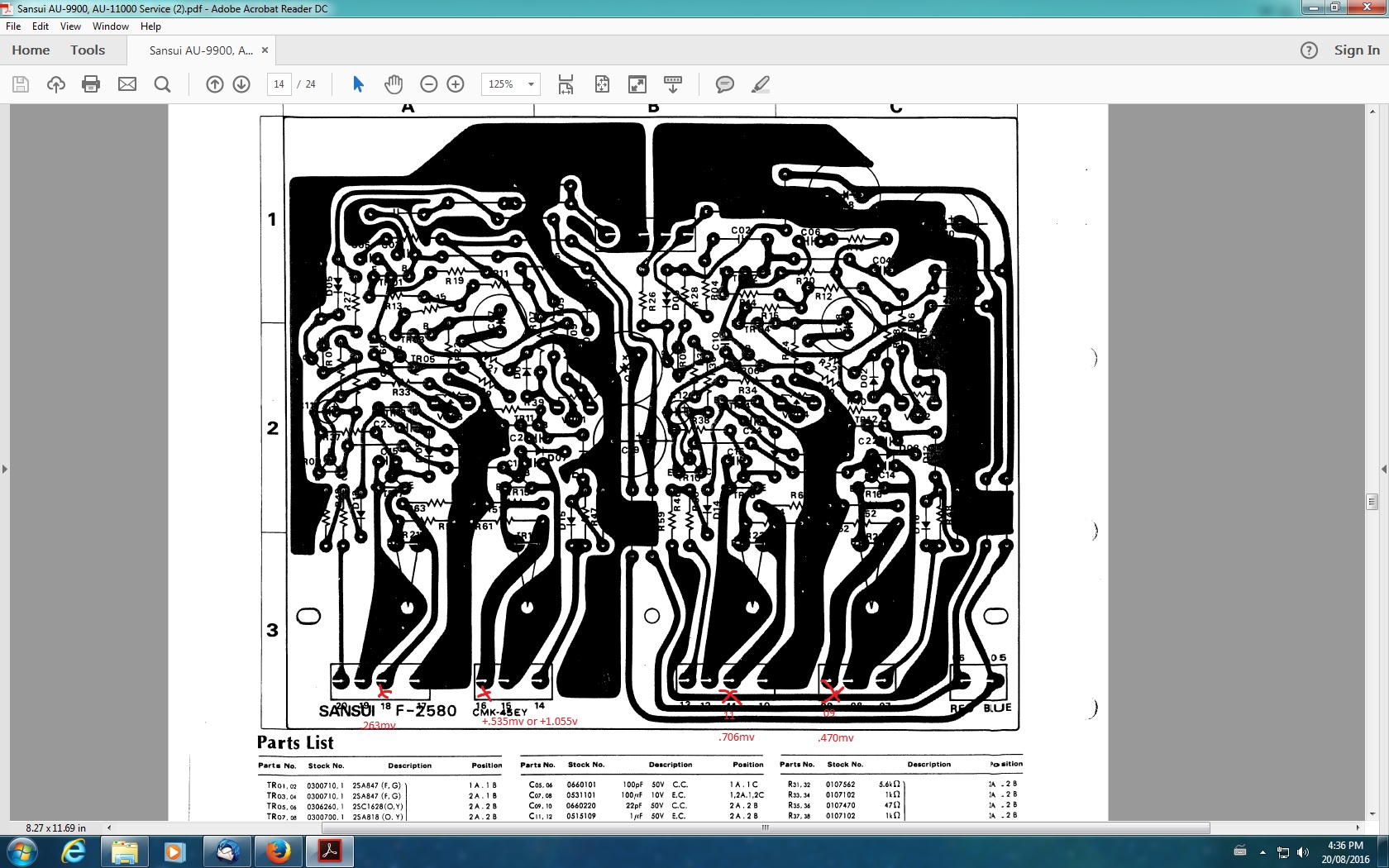

The good right channel has dropped to 10ma from 50ma? It has 1.2v between A & B. The left channel reads 1.1v between A & B. I took the driver board out to check things and reflowed a few solder joints,and I checked the left output module over again. The right channel jumped from 20ma to 51ma when I originaly adjusted it and it remained stable while I adjusted it back a bit to 50ma so it mustve jumped back down again,this is what its been doing for a fair while now.I connected some speakers,the right side is distorted at 10ma and the left side isnt doing anything,I cant hear a thing out of the left speaker.I crossed the channel over to the left side but didnt hear anything but I got a big shock when I mustve scratched the probe on the solder joint or something it was that loud I nearly jumped out of my skin.lol Ill check that pre-amp /power-amp switch to see if its that playing up again?

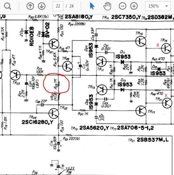

The left channel isn't reaching a sufficient voltage between A and B that I marked on the diagram to turn on the output devices. This can happen with newer semiconductors that are using different manufacturing and doping processes. The turn on voltage is slightly different and your circuit hasn't quite enough range to overcome that.
You need to be very very careful here.
If we can turn off the vbe multiplier a little more then the voltage between A and B should rise a little and bias the outputs on.
If you reduce the value of the resistor marked on the diagram by small increments then you should reach a point that allows the correct bias current to be set. I would suggest tagging resistors in parallel to this one initially. Try adding a 10k initially and if that isn't enough then remove the 10k and add an 8k2.
Always always set the trimmer to the end that gives MINIMUM current (lowest voltage between A and B) first.
(I'm also assuming that the 1.1 volts on the bad channel does actually adjust from a lower point up to this value. You might be best just confirming that to yourself before proceeding. If the bias trimmer has no effect on that 1.1 volts then there is some other problem at work. So just check that)

The left channel adjusted up to 1.4v from 1.1v with a couple of turns of the trimmer.What I think maybe happening is Ive pulled the MJ21194s out of a pro-amp that had some blown outputs in it, I threw away the blown ones and kept the rest thinking they were OK but it appears they may not be good even though they read OK on a DMM diode test? I think Ill order some new ones because Ive noticed the problem goes from one side to the other side and Im getting nowhere. The MJ21193s are new and probably arent able to bias with the old 94s?
Be logical, don't chop and change stuff yet. If there is a problem with the output then we need to prove it by measurement.
1.4 volts means there is 0.7 volts available for each NPN and PNP pair. You could just be below the threshold at which they begin to conduct.
Try what I suggested. Turn the bias back down and then add a 10k as I showed.
If you do as I suggest, and you see the 1.4 volts increase to say 1.7 volts (so 0.85 volts available per NPN/PNP pair) and still no current flows in the outputs then then and only then do we start looking for a reason why. In that situation there are only a couple of possibilities.
1/ There is a physical break between points A and B and the outputs.
2/ Both outputs in one or both of the NPN/PNP pairs are faulty. As long as one good NPN and one good PNP is there then it would work.

Re your last sentence if the system is not stable there would be a rapid increase in the current when the output stage starts to conduct.
My suggestion to cover that possibility is to have one hand on the adjustment while monitoring the voltage drop between the output pairs emitter junctions for any rapid peaking. A reverse adjustment can be quick.

I would always use a bulb tester initially, and that would also give a definite indication that the preset was now working and allowing current to flow.

The voltage amplifier stage is connected to the output transistor bases by 8R2 carbon film resistors of low wattage.
This is by design so the resistors will fuse if excess current is passed through them. I know from experience it is possible for that to happen without any visible signs to indicate failure.
You replaced some driver transistors as well as the outputs. Did you check the resistors at the time and are these still intact? It would be worth checking all the emitter resistors of the drivers and outputs as well.
Mooly made the point of checking continuity. It is important to do that by measurement. Carbon film resistors can also go high in value if they are subjected to too much heat.
The 8R2 resistors in question here are labelled in the Service Manual as FR meaning fusing resistor. It is less a question of what material these are made but are they intact.

The good channel. If you apply a short across the vbe multiplier (TR09/TR10) you force the bias current to zero.
It would be informative to know if the good channel still basically sounded OK in that state. If it did, then that would confirm that there is something other than just a low bias condition going on with the bad channel.

Ill do that with the TR09 but here are the readings on the base to the outputs.Most of them werent working as in no continuity from the driver board through the molex connector I have them going now except for pin 16 it reads 1.055v on the driver board and .535mv on the output base? Ill give it a good clean again and see what happens? Im taking it easy so as not to blow anymore outputs. Ive put the MJ221193/94s back in,at least Ive got that doubt about them out of the way. 😀 P.S. The right channel sounds pretty good now but theres nothing on the other side.Ill do TR09 and get straight back.
I downloaded my circuit from Hi-Fi Engine it is an 11000A is this the same version as yours - in this pin 16 is the positive supply rail sitting at 48 volts.
You say there is 1.055V at that connection point. Can you check what you have on your board.
Its Alive! Its Alive! I gave the balance pot a squirt of DeOxit and the left channel sprung into life.It sounds pretty good on the little test speakers. Ill check to see if I can bias it? I forgot to upload these readings They look all wrong but the amp is playing now like theres nothing wrong with it?
