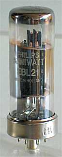

That tube doesn't look like a 4699 ? Rather a EBL21 , will not live very long in this config. unless you adapt the cathode resistor.

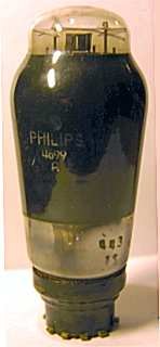

The ones I remember had bakelite base.These look more like a mix of the old base and a locktal.Strange 😕Most 4699 I have look like that.
Only a few very old ones are ST shaped.

It seems that with the tubular shape they also introduced the metal collar above the base.

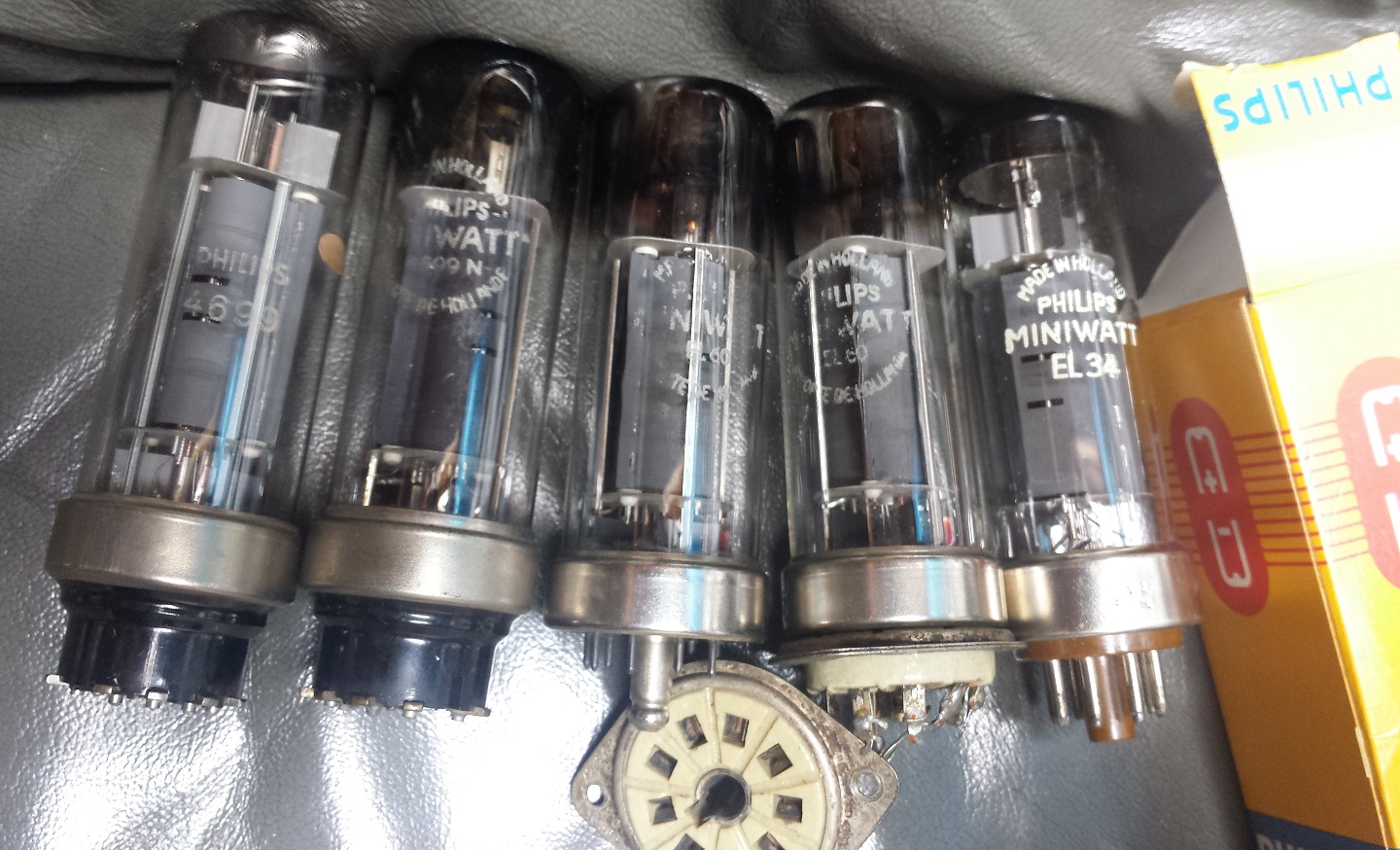

Here are the 4699, 4699N, 2xEL60 and their final descendant the EL34.
At the left the original pre war shape. Later 4699 had different heaters, labelled 4699N. At the right is an EL6 with identical properties as 4699N. Good ones are getting scarce rapidly...
