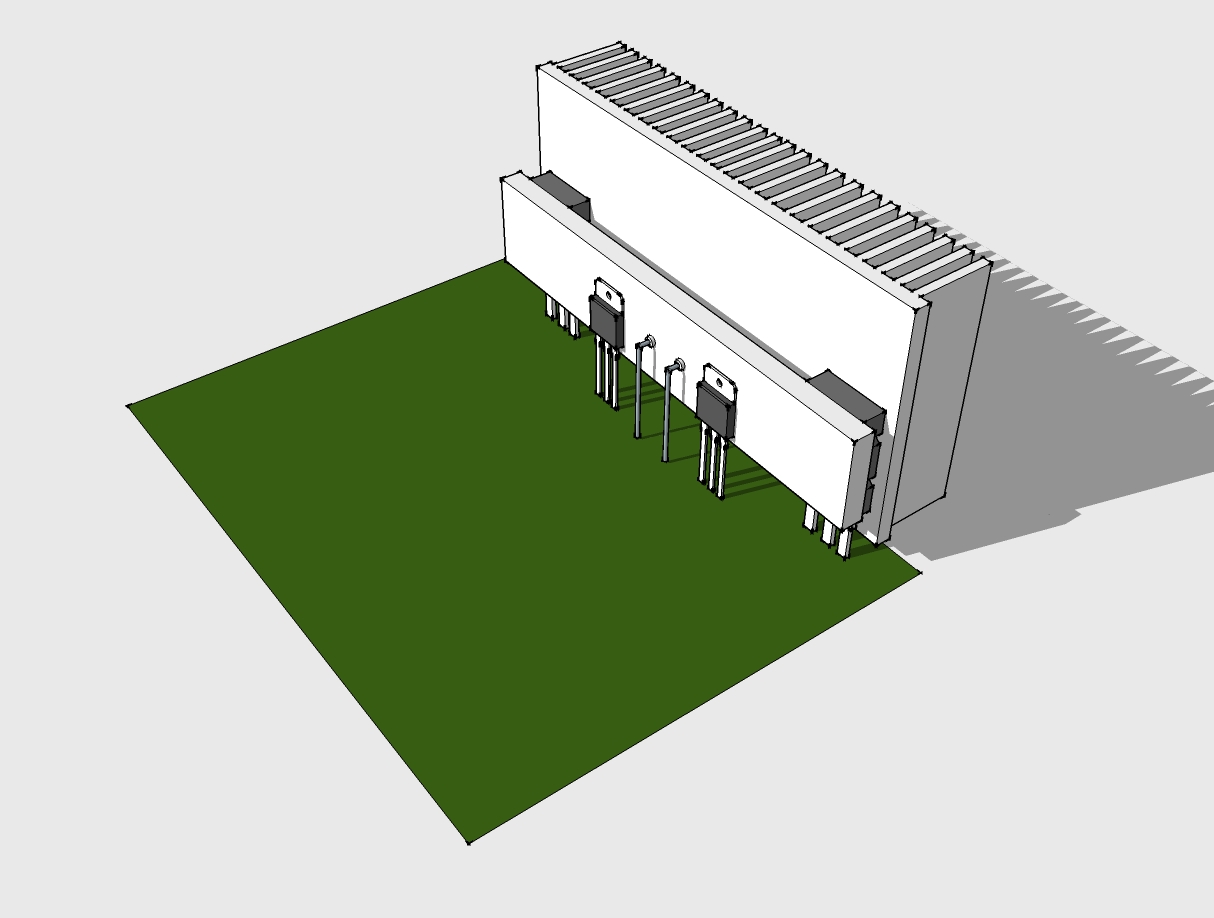

45W@8R 70W@4R CLASS B SO LOW DISTORTION.
here is your JPG pcb.

:Ouch: The pictures of the PCB are a wee bit on the small side.
And nobody seems to care that the biasing is suboptimal. Might as well stick another diode or two in that OPS and make it a class A amp, since it is just one out-of-spec component away from being one.
that is a sorry excuse of a pcb my friend .... it has all the classical mistakes software will make when asked to design a board
a 12 year old can do better .....

Is this ok?
I hope this may help....
check the pcb its not yet tested.ived just finished it yesterday.
check if my idea of prevention of thermal runway is correct.and open for any suggestion.
thank you.

i could never design such a pcb with so nice graphics .... the presentation is almost professional ... but need to ask a question .... does your software also say the behaviour of a ground plane versus the specific amplifier ? can also your software calculate inductance or capacitance between traces with such a proximity ?
i am pretty sure that your "presentation" is a result of a few hours of work ..then it could be better if your such nice graphic skills where followed by design rules for audio pcb / for amplifiers / for sziklai amplifier circuits ...

with regards to pcb design im just a newbie.im not aware if my software is capable of that im using eagle5.6.i got tips from randy sloans book about proper wirings i know its not sufficient but if you think you can put something on this design im willing to listen.is that cf design?
my friend did the 3d design and were doing it just for fun and to help others as you have said this is a wonderful forum where people share ideas, knowledge and even resources.

ok then ...here is some fast food details ...
----amplifiers are not RF devices nor power supply there is a serious chance that the ground plane you made causes trouble
----if you decide to stay with a ground plane after all as seen from your pictures proximity of ground plane between traces is way too close ... that might cause inductunce or capacitance with other traces and drive the amplifier to oscilation
---- next option will be to have a star ground on board
---- you have missed decoupling and bypass of rails on the pcb .... for this type of amplifier that might help a lot ...
---- " curent source" for LTP Q3 need to be as close is possible
--- since you made the pcb with LTP tansistors close enough you might as well bring them even closer so thermal coupling and matching will also add some quality more to the amp
---- C3 feedback capacitor is not MKP cap ...its an electrolytic ou have used the wrong part
---- Finally thermals is a quiet serious issue on this amplifier since no output resistors are used ...beyond serious heatsinc the needs to be used ...idle is supposed to be monitored properly and the diode string of 1N400X has to be properly attached on the heatsink
---- use of better transitors than 2955-3055 combo is recomended and choise of make and quality will make the amp more thermally stable ( pcb has to be able to use TO247 devices also )
----On this configutration with 33+33 volts belive it or not i think that is marginal i wouldnt go more than 30+30 with 2955-3055 combo better transitors might stand up to 35 or 40 volts
----even though vas transitor Q5 is excelent freq and perfomance whise i could as well make pcb that could feature BD139-140 family also just in case BC is marginal ...
my 2 cents
