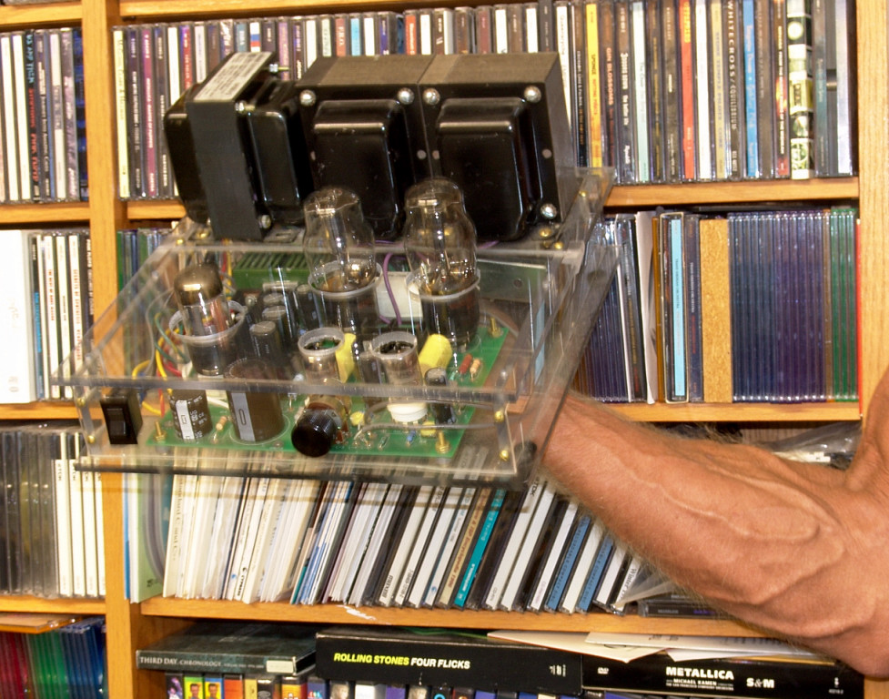

I have a little 45 SET. I run the 45's (or my favorite NX-483's) at 325 volts and 30 mA. The extra plate voltage allows headroom for the average speaker in the bass region. The NX-483's were made before 1929, have been in the amp for almost 10 years and still work great. My amp has been auditioned along side some high dollar equipment and stands its ground quite well, and is often favored by some listeners, especially in the dynamics department. OH, yeah, the power supply uses a $40 transformer, probably has several hundred ohms of DCR but there is a low ESR motor run cap right at the red wire on the OPT. The secret to dynamics is the ability to run right into A2 without distortion and total freedom from overload and recovery issues. AND...I can hold the amp in one hand. I don't have room for huge amps.
BUT, this thread was about push pull 45 amps. I have built a few, but currently don't have a working 45 push pull amp. Why? Tubes. I have about 20 45 tubes. All are quite well used, and most were obtained for $10 each or less. A pair of 45's in class AB2 push pull can deliver 18 watts according to the data sheet. To do this the tube MUST have ample reserve emission capability or the dynamics will suffer and the amp just won't come alive. Most of my well worn tubes will work fine in class A1 or A2 even in push pull, but can't pass the 100 milliamp peaks needed for AB1 or even more for AB2.
I had a fully differential (3 cascaded LTP stages 6SN7's ---> 6SN7's ---> 45's) push pull amp running for a while. With a CCS in the tail of each LTP it MUST run in class A, and roduced about 4.5 watts on 325 volts. It sounded excellent, but I swapped the 45's for triode wired 307A's, raised the B+ to 375 volts, changed taps on the OPT's (UTC LS-57's), and got a great sounding 15 watts.
