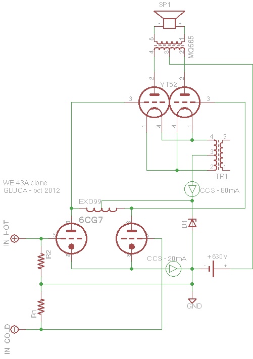

The last amp I built, actually just one channel running as I am missing a few minor parts, is a 6CG7 differential stage direct coupled to a VT52 differential stage. So far this is the best (maybe the second best after my EIMAC 75TL) amp I built. Filaments are AC heated and output noise is 0.8mVRMS. D1 is a string of 12V zeners for a total 252V but 6CG7 is feed from the 216V tap
Gianluca

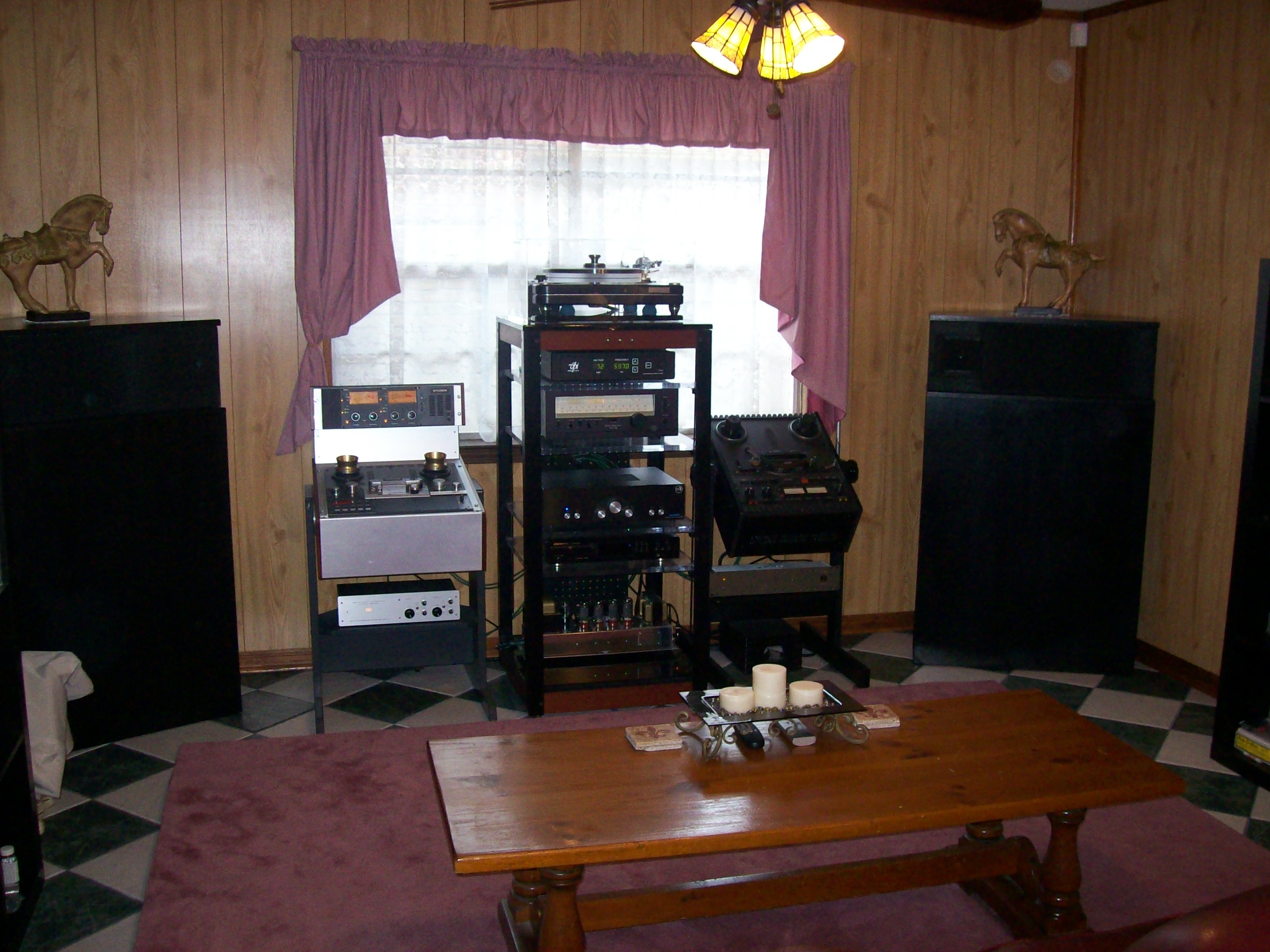

Hi Thomas,
Yes I am sure I listen between 85-95db most of the time, just kinda depends on what it is and my mood. My speakers started life as Klipsch Corner Horns the only thing original are the 15" woofers and the cabinets. I have upgrade all other componets. The mid driver is a 2" BMS rated at 118db so I have them padded down to match the other drivers so 106db is about where they are...😀
This is where you grabbed my attention. I own Klipsch as well (Fortes 98db/watt) of course highly modified. I have been DIYing for nearly the last 25yrs, I have 40yrs experience in the hobby. It was only when I began DIYing that I finally had some satisfaction.

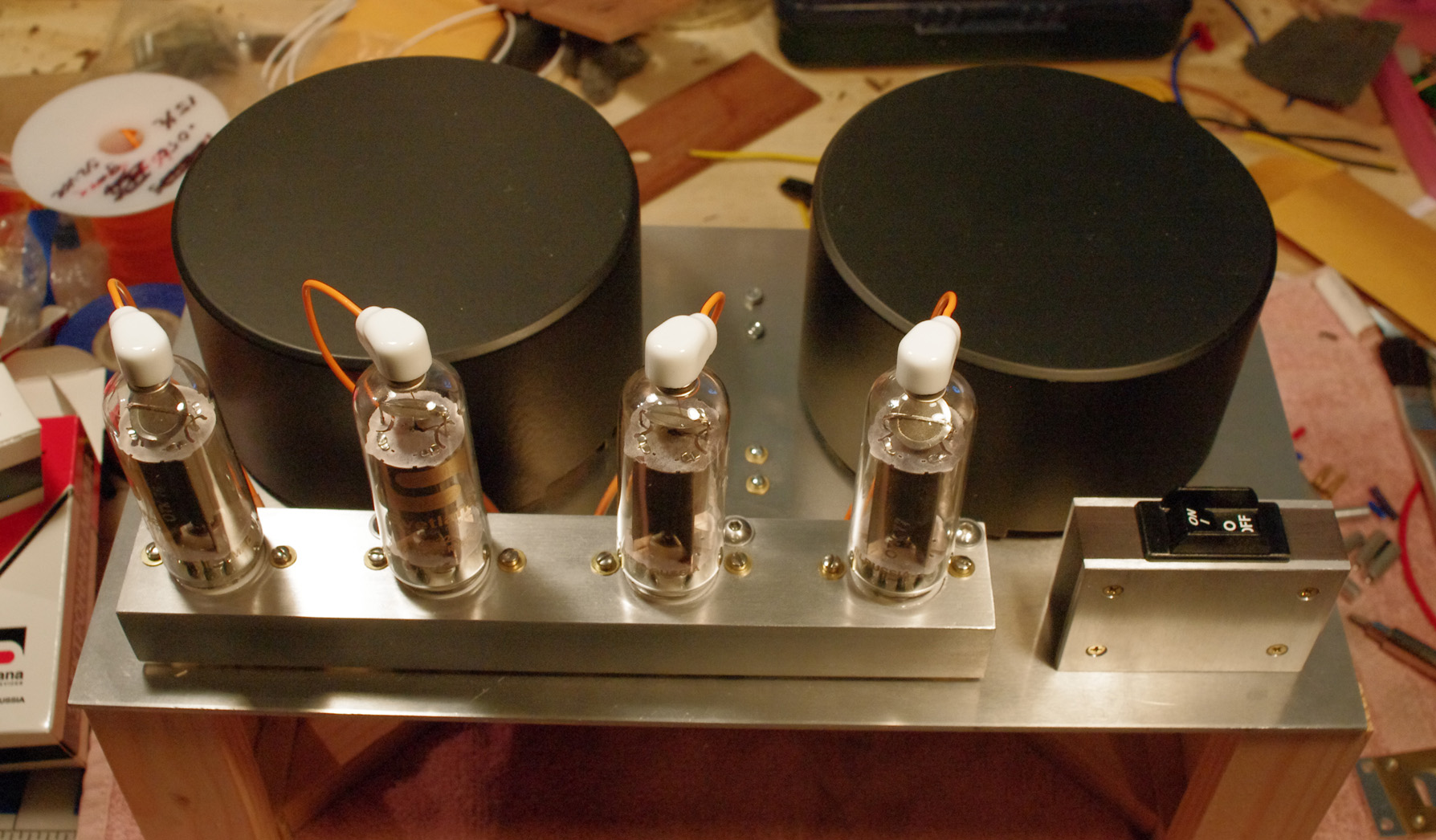

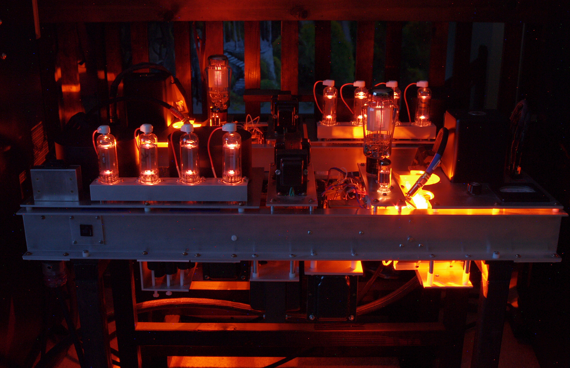

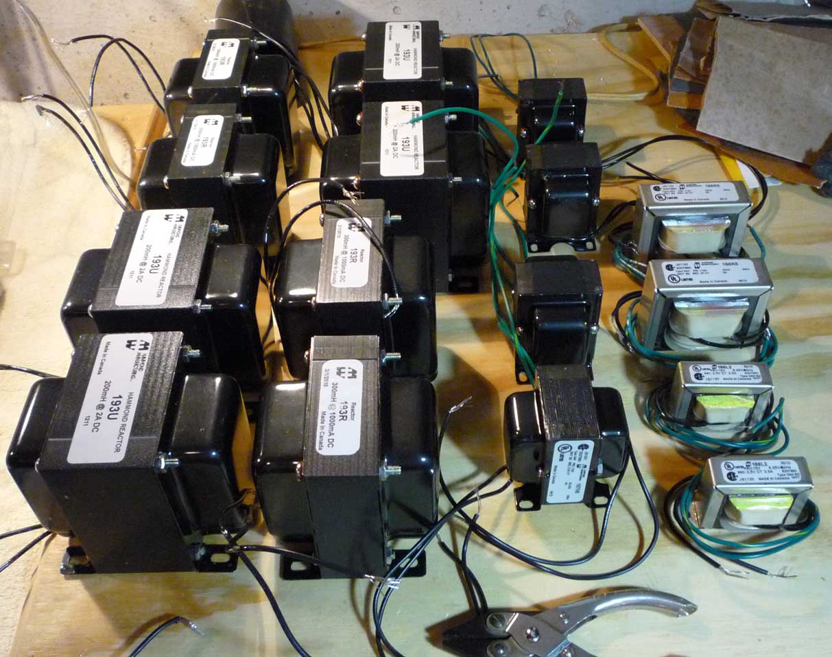

When I said not far enough here is a typical George Wright 2A3 Monoblock contrasting a 45 Monoblock that I designed the circuit for my very good friend John. John did the layout with some assistance from me which is very unconventional but the amp is dead quite on his highly modified LaScala's.
Further I would like to thank Thomas for his work with tube full wave bridge rectifiers which was eventually added to the project using 4 6D22S's/mono along with an additional paralleled mains power transformer.
John has said that he has not heard the amp clip or sense any form of compression. I designed this thing to be ultra fast both in impact and recovery. He lives 450mi away from me but I did get a chance to hear it and he was right as all I heard was effortlessness. As to playing to 100db, I ran some SPL #'s on his system efficiency vs mine and our system max SPL levels match. His amps incorporate many of the same principles that I have in my amplifiers. And I can easily obtain 100db in my system from SET Mono's, 10 watts from a 811-10 running Class A2 with no sense of compression.
I hope you enjoy the photo's. I don't get here to often so please e-mail me if you'd like to know more on John's system and the design of John's BOS45 amplifiers.

Hi jcmusic, I am the guy SET12 was talking about with the 45SET. I run La scalas with stock drivers. I have a better midrange horn and a Universal crossover made of premium parts and that helps some but really we can't be that far apart...unless...
Is your room huge? How close do you sit? What is in the room that might absorb sound energy? Have you ever done work to your crossovers?
I get by with way less than a Watt but then again I have a separate sub woofer with it's own amp. There are lots of factors I guess, it is just funny that we like about the same SPL = 86-89dB for listening. One Watt should do you just fine IF you have everything else going right.

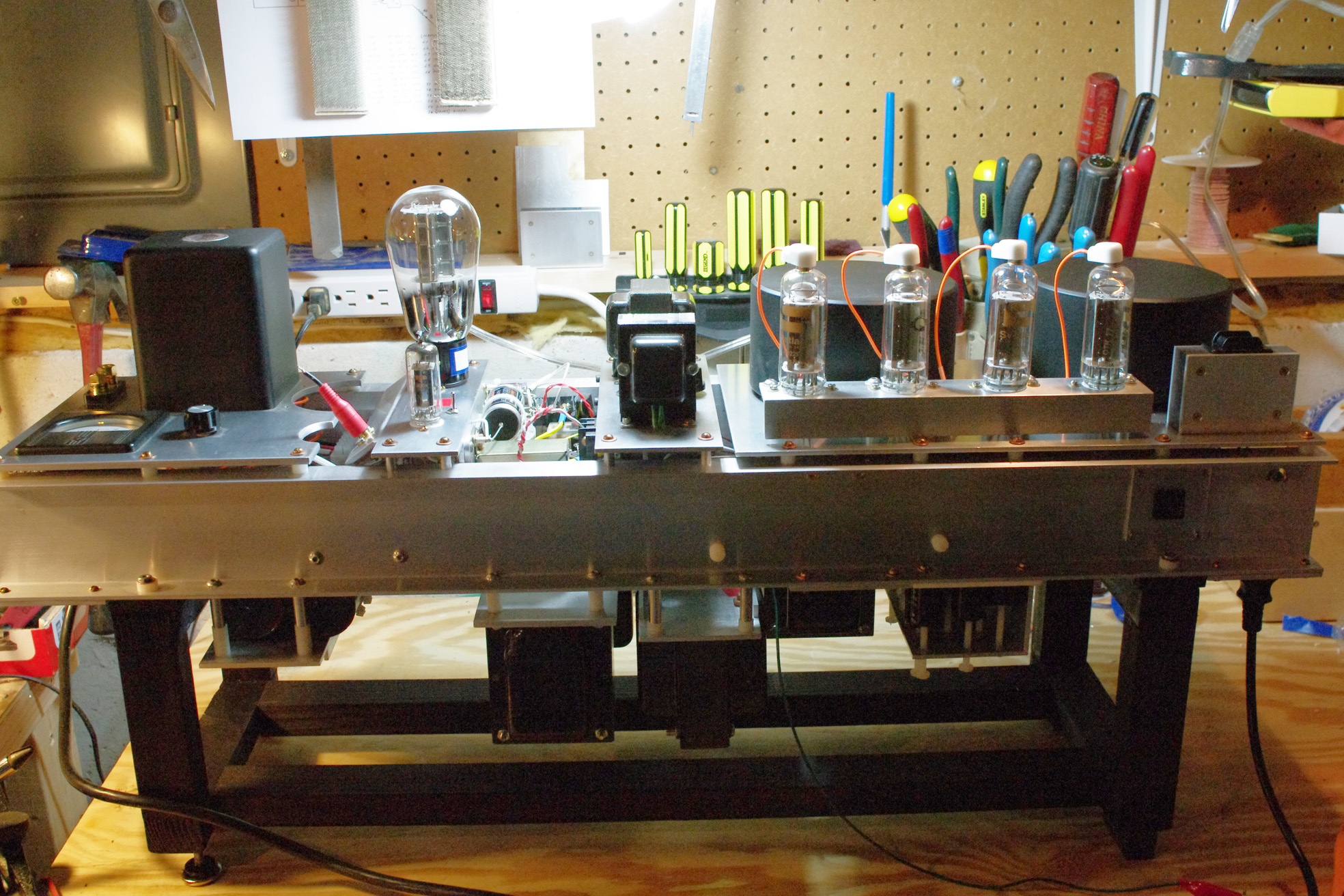

They are pretty big, pictured the John has them together they are about 3ft x 3ft. They a lot of iron but not utilized in classical design fashion. John's BOS45's use Silk grid chokes to help aid in clipping recovery. Each amplifier has over 900uf of capacitance that is highly isolated and aided what could be referred to as buffer chokes which feed his final caps. The design allows for great authority with transparency and speed. His EML45 is driven by a paralleled 12BH7 that is LED biased and has a plate choke, the 45 uses fixed bias with AC filaments for both tubes. The amplifiers DCR to the wall from each of its final caps is about 12 ohm's resulting in some serious impact. Most SET amplifiers typically have several hundred.
Pictured is Johns Tube Bridge Rectifier. His amplifier is modular so its very easy to further add enhancements like this.
Also the last photo with the iron which is missing I believe 6 pieces John appropriately named after the manufacture a "Hammond Army"

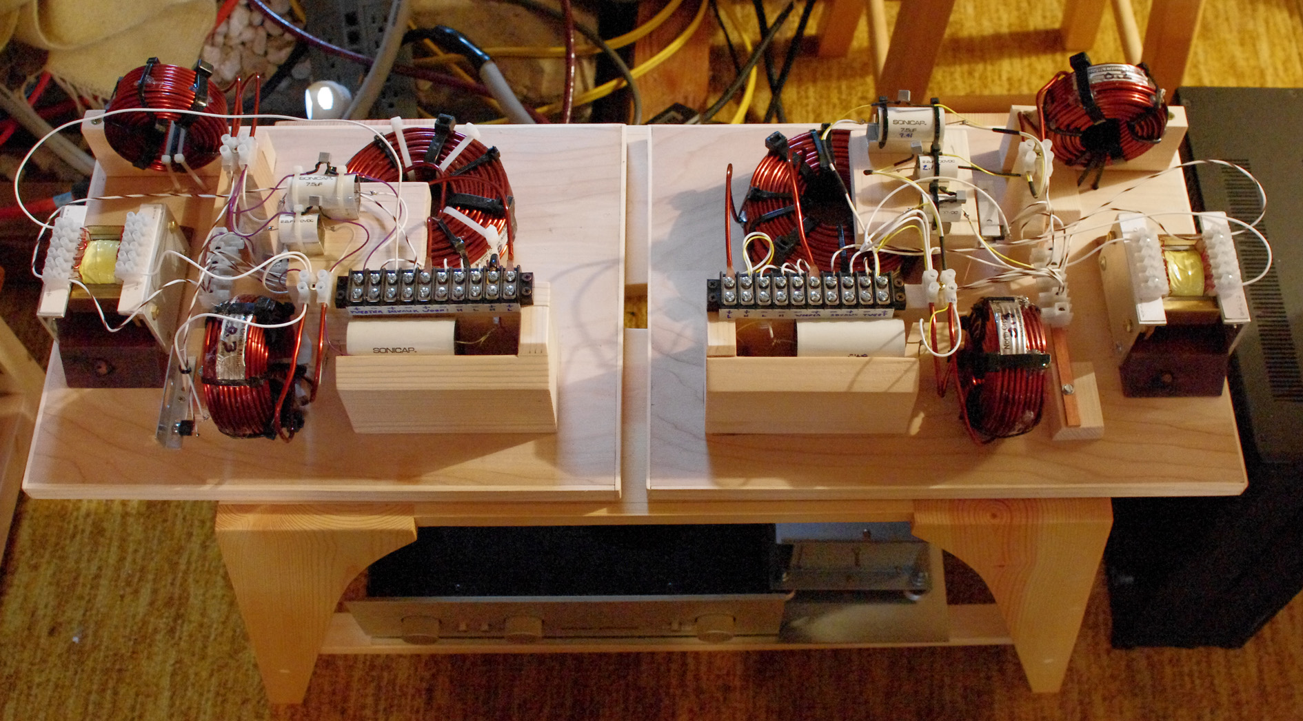

His DIY ALK Universal Network which is 12in by 16in and weighs 20lb each he is using North Creek Music Inductors I believe Johns are 10AWG which better then most (including the Solens) at coherancy in their working frequency range my own are 8AWG. He uses a higher quality Auto-transformer that uses Cardas wire. I use a German made C-Core pictured next to a stock Autotransformer. While the ALK is 50% larger then the stock the C-Core is 50% larger then the ALK.
Not so very different you and me...
OK so you and I are not so very different in our rooms or listening. You have put serious thought and effort into improving your drivers and dispersion and too to the room effects!
I have attached a picture of my Universals, they are ALK designed but use Northcreek 8ga air cores and a autoformer done u by Intact Audio. The caps are just gen 1 Sonicaps with the recommended bypass caps...
I cannot begin to describe the difference the darn air cores made. I hated spending the money on them as an "experiment" but don't regret for a minute the cost now. It was just the logical extension of the low DCR "experiment" with the building of my amp!
Yup my amps are huge; most of it is power supply, orders of magnitude more power supply than "needed". It doesn't show much in the picture but the four chokes of the power supply underneath the amp and are about 9 pounds each. All four of them add up to 1H and have a DCR of 10 Ohms...total. It is the throughput of the power supply you want unabated. If you look at the amp as what it is, a valve, you are listening to the power supply.
I would rather you contact SET12 directly for the technical side of the explanation. Suffice it to say that in most designs work far too much inductance loss is designed in and it's been designed in so long that no one bats and eye at using 20H in a power supply. The resultant resistance is death to speed. There is only 1 resistor in my amp, its after the grid choke, just because...(there are bleeders of course but they are not at all in the signal path). Dan mentioned that I have gone to a bridge rectification using TV damper diodes (and dual power toroids) which also helped smooth out the rush of power...all 1.6 watts of it. To be fair I am sure there is LOTS of headroom in the "1.6W" To be sure when it is called for power makes it to the speakers!
All this to say: take a look at the design of your 45 and see how conventional it is. Think about jumping way out of the box. You could easily just try upgrading your air core inductors in your Universal crossover and listen. If lowering your DCR has a obvious effect there you have tasted the fruit!
