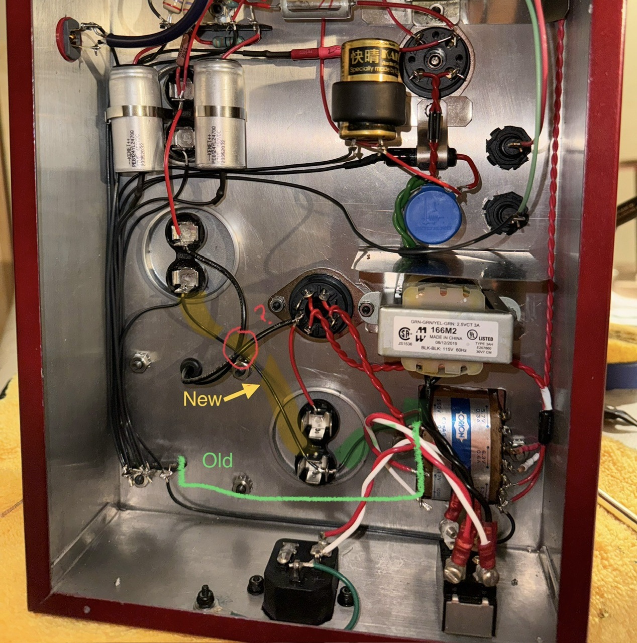

Before I get into the results let me put this question out to the group:
Just how low of a ripple can you get from a direct heated 45 with AC on the filament? (At speaker)
Maybe I’m chasing unicorns here?
EML website says anything under 1mV is a “fine piece of work”. (I was under half a millivolt)
OK onto the results:
Moved the ground wires to run from center tap to 1st cap to 2nd cap then to the star.
Ripple measured at the speaker:
Before: 0.48mV
Now: 0.49mV
Worse, certainly not better.
Also
60Hz very slight decreased
120Hz very slight increased
Makes no sense.
Only thing I can come up with is the ground wire between the first and second cap now crosses the high ripple wire between the rectifier and choke. (They are at 90° and separated vertically about an inch).
I mean the physical separation I lost has to count for something doesn’t it? That doesn’t seem to get mentioned much in any grounding discussion.
Think I am going to try something in between:
Center tap to first cap then to star. Second cap to the star. That will avoid crossing the rectifier to choke wire.
Good news is, it’s still less than half a millivolt ripple. 101 DB efficient speakers and I still don’t hear any hum unless my ear is shoved into the driver.

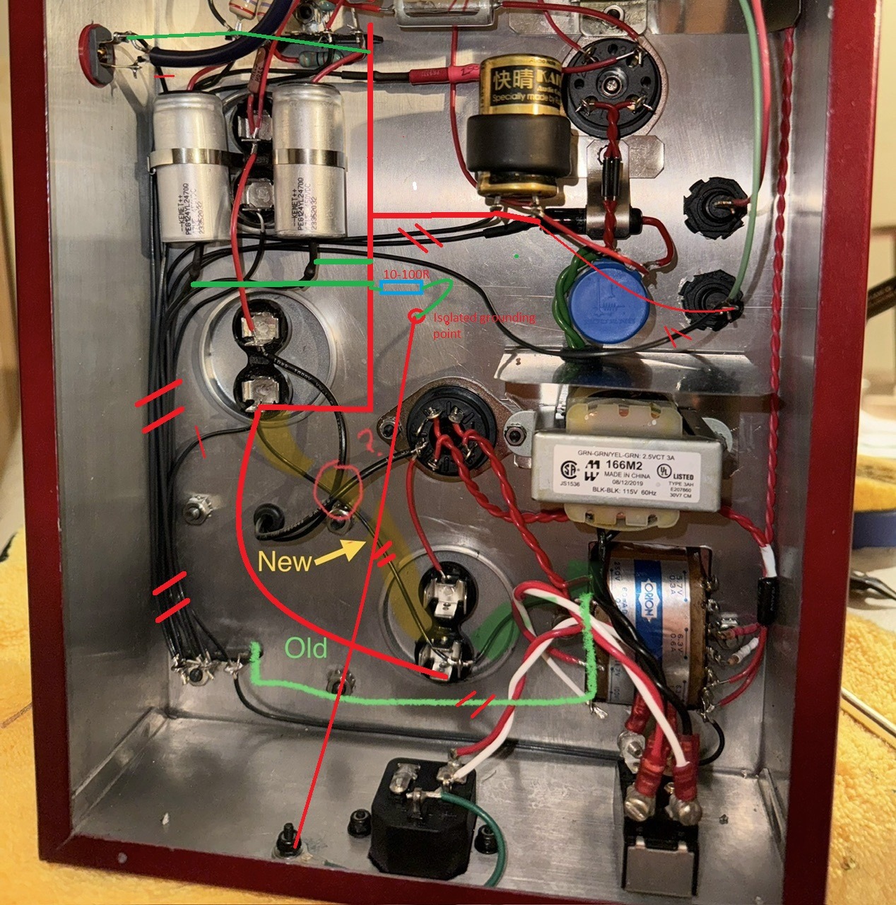

If the amplifier is in "silent mode" (shorted input, no signal within an amplifier), high ripple current occurs only between rectifier and first cap positive, and first cap negative to CT.Only thing I can come up with is the ground wire between the first and second cap now crosses the high ripple wire between the rectifier and choke. (They are at 90° and separated vertically about an inch).
These are -in my schematic simulation- 330mA spikes (if the steady current of load is 90mA).
Via the choke only the second cap charging pulses moving, about 4-5mA (mostly sinusoid, than first cap charging pulses).
So, as we repeated many times, the most critique chain is secondary-rectifier-first capacitor-CT.
BTW why not place choke "output" wire on the other side of second capacitor?
Started simple. Did not renew the entire grounding, just rearranged PT, C1, Choke ground wires.
While not ideal, I’m wondering if the grounding is NOT the limiting factor. How much can you get from a basic CLC filter along with AC filaments?
Red circle is where ground now crosses rectifier output. 1 inch vertical separation. Possible this is the cause of the very slight increase in 120 Hz?
Could you please post an 'after' pic?
The only reason those grounds can be noisy is by isolating them from the actual ground. There can't be noise in a zero ohm connection to "ground". And seriously stop and think a second, how much resistance is there in a couple of inches of solid 18ga copper wire (0.001 ohms?) and is that really going to have any impact on reducing or isolating a "noisy ground"?Rob7,
I use the scheme as shown the idea is to distance the noisy from the quiet gnds. Again, this is my way that maybe total BS to someone else.🤣
I have 104db horns and there is no audible buzz or noise of any kind.
ir1= ripple current from cap 1 etc.
You can see where the high ripple areas are located. The ir2+ir2+ir3 being the worst sum of the major ripple currents from filter caps.
I do agree the RCA "ground" is actually the return signal path and should not be brought all the way back to the main star ground point individually but should be connected to ta local ground at the input tube used for the cathode/grid leak resistor. Nothing good will come from having the return signal path being taken all the way back to the power supply ground and then back to the tube cathode/grid leak/volume pot via another ground wire in parallel to it.
Rob,
Use grounding scheme as you sketched in #25 post!
Using such extremely long wires -for example- from #45 cathode resistor AND decoupling capacitor negative to the "grounding point" is unreasonable.
Why not connected its together in capacitor negative?
Always use as short wirings as possible.

Rob7,Started simple. Did not renew the entire grounding, just rearranged PT, C1, Choke ground wires.
that does not look like an improvement IMHO, but then again it may not matter in the end. Does it buzz?
