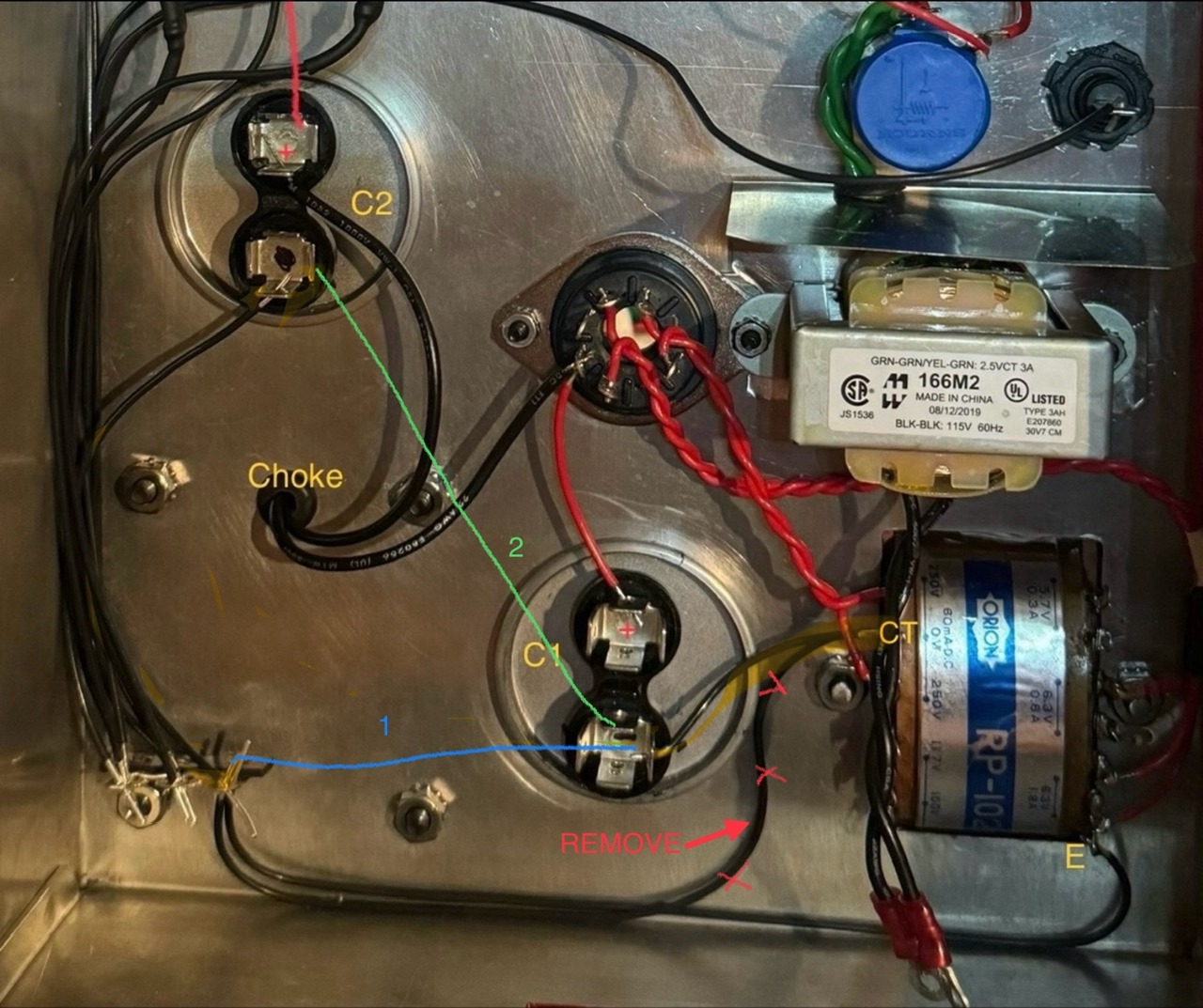

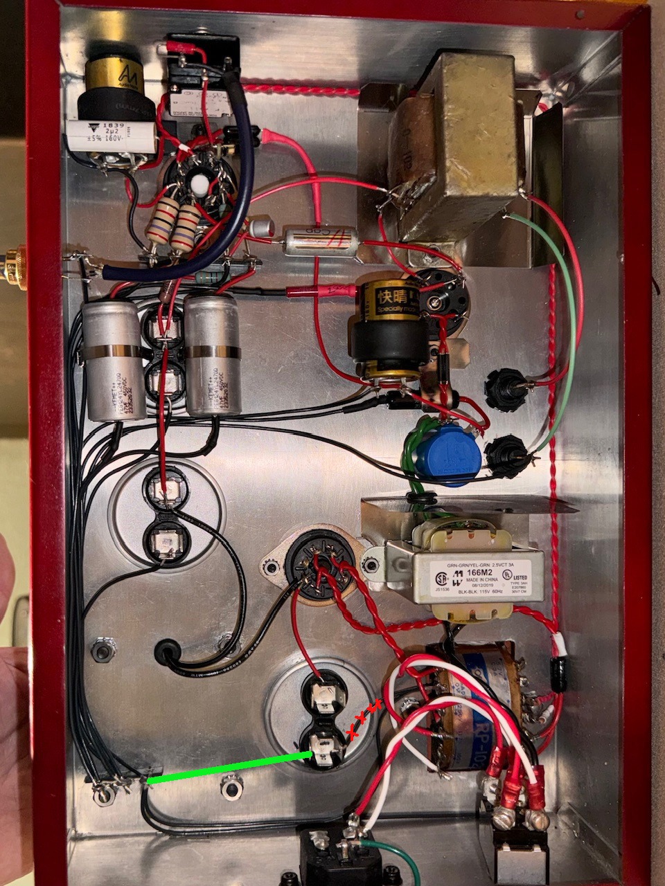

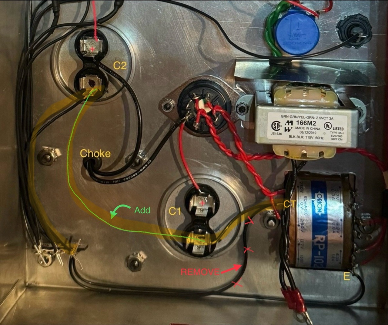

Any thoughts on how I grounded the first power supply cap? It’s directly to the zero center tap of the power transformer. I had read keeping it off the star ground can help keep 120 Hz hum out off the ground circuit. But not sure if that is correct.

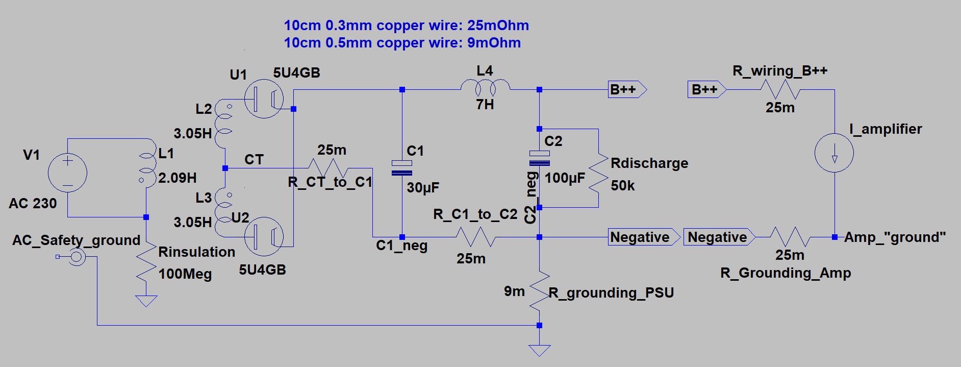

The first [hum] ground loop is power transformer secondary, rectifier, first capacitor.
With a wire from the negative of the first filter cap connected to the secondary center tap . . .
The largest current transients are contained in the shortest loop possible:
secondary wire 1, to rectifier, to first cap positive; then the first filter cap negative, to the center tap.
secondary wire 2, to rectifier, to first cap positive; then the first filter cap negative, to the center tap.
From the positive terminal of the first filter cap, that goes to either a resistor or a choke, to the positive of the second filter cap.
The negative of the first filter cap is then connected by a wire to the negative of the second filter cap.
The first ground loop is purposely local to the secondary, rectifier, first filter cap (all the transient current is in that local loop.
After that local loop has been established, then you connect from cap 1 negative to cap 2 negative.
Next, you connect yet another wire from cap 2 negative to the central ground.

Had to read that a couple of times!Correct
just to make sure we’re on the same page. Didn’t quite follow your description connecting C1 to Rectifier:
“secondary wire 1, to rectifier, to first cap positive……secondary wire 2, to rectifier, to first cap positive….” maybe I’m being too too literal but it seems this would short the secondaries?

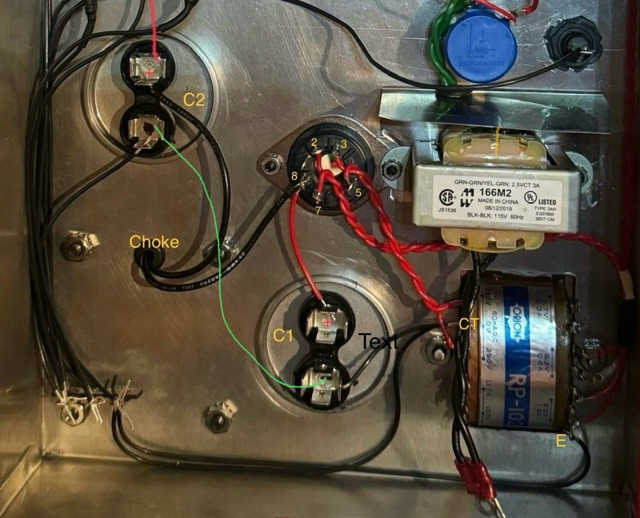

This amp uses a 6AX5GT rectifier tube. There is no connection between the heaters and cathode. Heater on pins 2 and 7. Cathode is pin 8. maybe that’s where the confusion lies?
that said, it seems I have followed most of your advice and merely need to connect C1 negative to C2 negative? (green line in photo). But wouldn’t that create a ground loop?
But they are connected already: C1 negative goes to the PT center tap…to the star ground…to C2 negative. As highlighted in yellow.required for operation.
If I put the green wire in as depicted, there will be two connections between C1 negative and C2 negative… isn’t that a groundloop?
I’m sure I’m making this way too difficult, but somehow I am just not getting this.
should I add the “green wire“, as drawn, and remove the wire between the center tap to the star ground?????
What is the "brownish" wire attached to negative of C1 going to? I typically use a bus bar grounding system. That would be a bare wire where your green connection is and my grounds get soldered to that. Not saying I'm doing things correctly. I'm interested in the star ground scheme.

Like This?
Like This?
Better. I still feel your gnd wiring is way too long and prone noise pickup. I would move the star gnd close to the center of the chassis.
I don't like Stephe's way AT ALL as it carries the hum from the CT and the first cap to the star point. Bad mojo.
If that is "bad mojo", why are all my amps built like this quiet? But doesn't shock me, anything I post of this forum is TRASHED, not sure why I even bother replying here anymore.

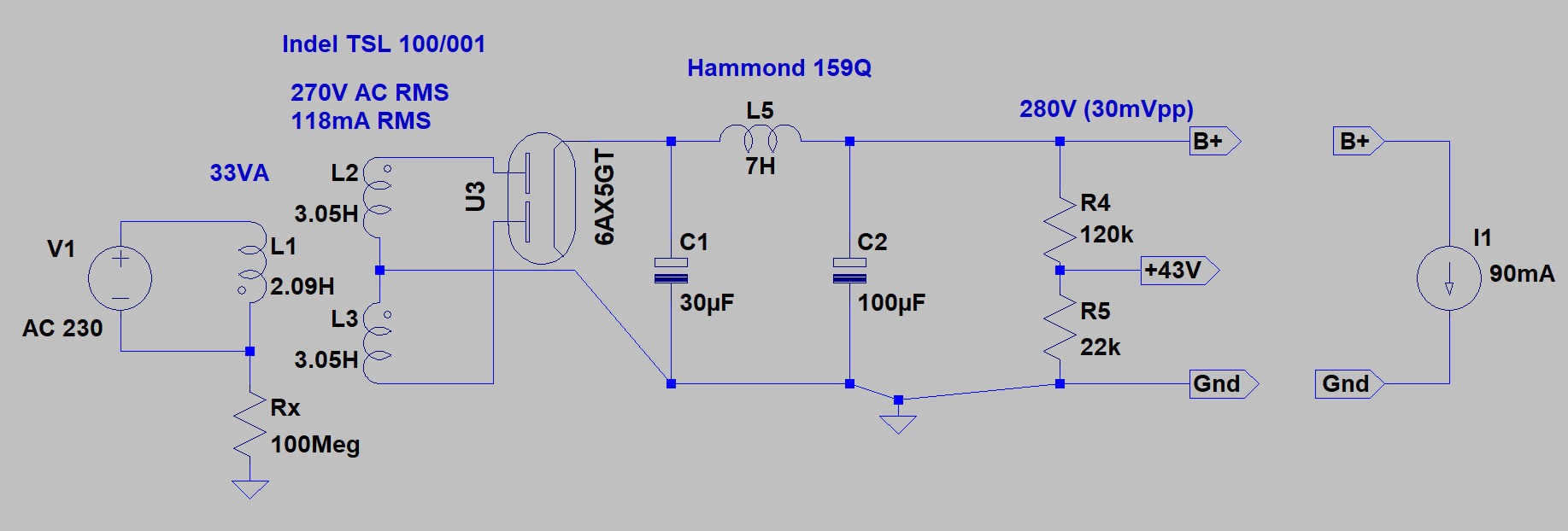

Note in this article, they don't show in their star ground examples the cap grounds being all daisy chained across the amp before going to the star ground point. https://www.valvewizard.co.uk/Grounding.pdf
Thanks for the input Stephe. You are responsible for this amp…my first. Without your inspiration and videos I would’ve never built it!Remove that one wire from the CT to that one cap negative, and then hook the negative of that cap
As to this grounding scheme, I am absolutely open to any and all ideas. I kind of enjoy the fine art of hair splitting sometimes!
That is a concern of mine. However, I did everything I could to tuck the wires away from all sources of noise. I grounded it as is in an attempt to keep the ground wires away from the nasty 120 hz ripple in the wire from the rectifier to the choke. The ground wires and the choke wire are kind of “S”d away from each other intentionally. I chose a little extra length for greater separation and tucking the wires into the corner of the chassis. Good idea or not… Still learning. I was also thinking, one way or another the grounds all had to reach the center tap… Be it multiple wires or a single wire—total distance and length would be the same regardless of the positioning of the star ground. Again, maybe flawed thinking…just an insight into my thought process. Thanks for your input. That’s exactly why I posted here. A conglomerate of ideas from a highly experienced group.gnd wiring is way too long and prone noise pickup
A little bump. Again, not totally clear on your original post. Did I get it right with my photo in post number 12?Correct
I know the answer must be so simple, yet it escapes me. My apologies, but…I’m a visual learner.
One more go at this:
option 1 (blue)
option 2 (green)
or none of the above…. (If I get this resolved, then I will move onto the positive side of C1. Only one other option that I can see)
