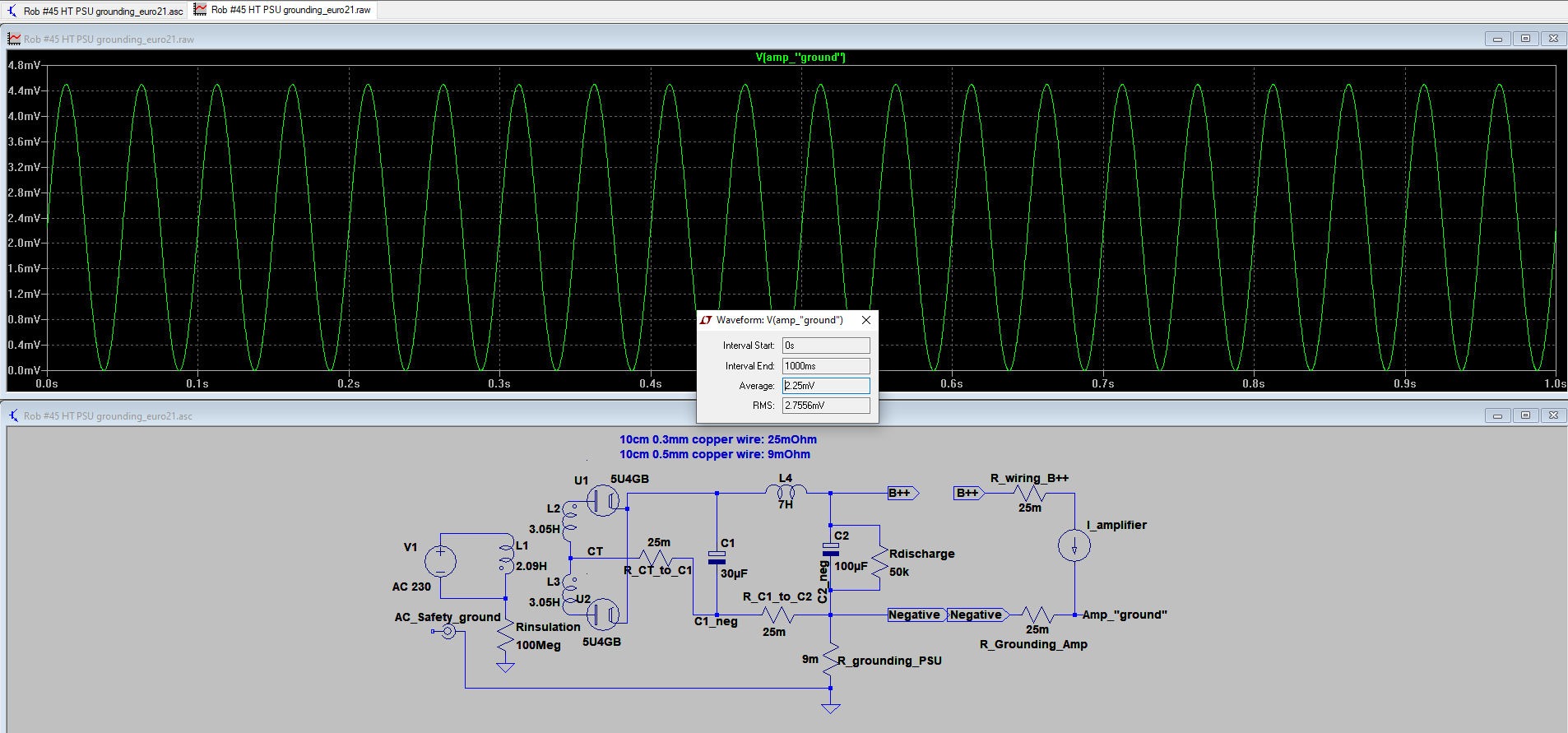

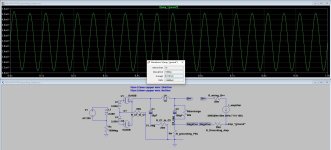

These are only simulations of long wirings in Rob's amplifier.
More worst, than in practice, but necessary to exaggerate to demonstrate possible differences.
The load is 20Hz 0...180mA current load (90mA biased A class).
The displayed signal is the amplifier part "ground" bus.
The first is the commonly used: CT to first cap negative, wiring to second cap negative, which is tied to grounding point. Each load "negative" tied to second cap negative. Shortest loop: C2 is the main energy storage device -for short load impulses- so the main current loop is between B++ (second capacitor positive) to PSU "negative" (second capacitor negative).
The second is Stephe's suggestion: CT to grounding point. First cap negative to grounding point. Second cap negative to grounding point. Each load "negative" tied to second cap negative (shortest loop).

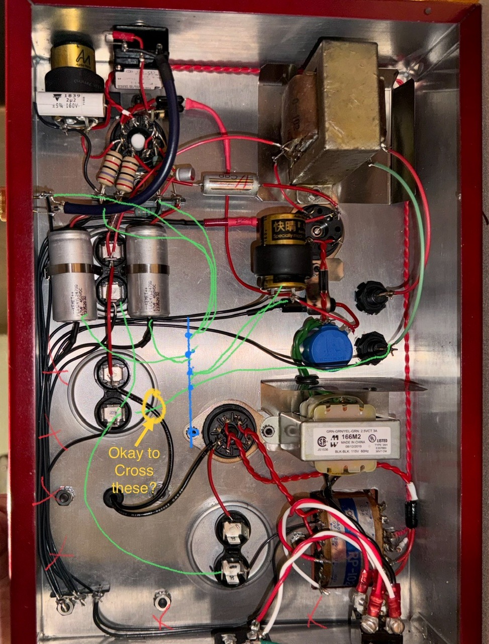

Thanks all—this is coming together in my head. Next question.
In last photo (post 25)where should the star ground to the chassis?
Many articles advocate for the ground to chassis be at the input, which seems counter to what everyone is saying here. Possibly I am just misunderstanding…again!
Looks like you are trying to go with a bus bar grounding system instead of the star ground you originally wired up.
Try considering that the SIGNAL ground is different from the CHASSIS/EARTH ground. if I were doing it, I would run a 14AWG wire between the two caps and bring each individual wire to that wire. I keep all the grounds from each stage together. The transformer center-tap gets hooked to C1. There is NO need to tie the SIGNAL ground to the chassis but I usually do through that hum breaker mentioned earlier.
That blue line was supposed to represent a tag strip. Was considering moving the Star ground to Central location. But you and another member have now mentioned putting heavy gauge wire between the caps. That would make for a good bus. Interesting thought.bus bar grounding system instead of the star ground

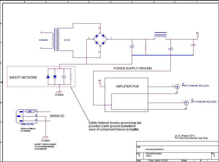

"Grounds" are the source of more confusion than just about anything else in audio construction (and often in system installations too - I've seen plenty of professionals get things wrong). We tend to fall back onto established cookbook methods because they work at least well enough, and because there are no ideal, perfect solutions - all methods are imperfect.
Let me suggest that to develope a working mental model about how to choose an optimum path we do two things. First would be to abstract our thoughts one step, from actual parts to a schematic. I suggest this because the interesting parts are there, but without the distractions.
Second would be to stop using the conventional "ground" symbols in the signal and power supply paths in schematics. This convention causes endless confusion because it's false. Instead we should draw and think about things as euro21 has drawn them, with actual (or estimated) impedances in place. This encourages us to think in currents when appropriate, and not always in voltages, and without imaginary perfect "grounds" which don't exist.
There are no perfect solutions for single-ended circuits, and star "grounds" are only a series of loops. Also we must remember that a stereo amplifier's channels are common-grounded at the source - another loop. Lotsa compromizes.

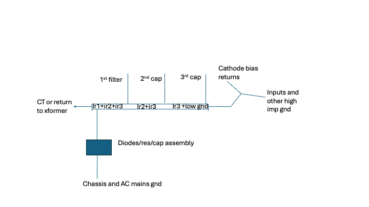

Rob7,
I use the scheme as shown the idea is to distance the noisy from the quiet gnds. Again, this is my way that maybe total BS to someone else.
I have 104db horns and there is no audible buzz or noise of any kind.
ir1= ripple current from cap 1 etc.
You can see where the high ripple areas are located. The ir2+ir2+ir3 being the worst sum of the major ripple currents from filter caps.
