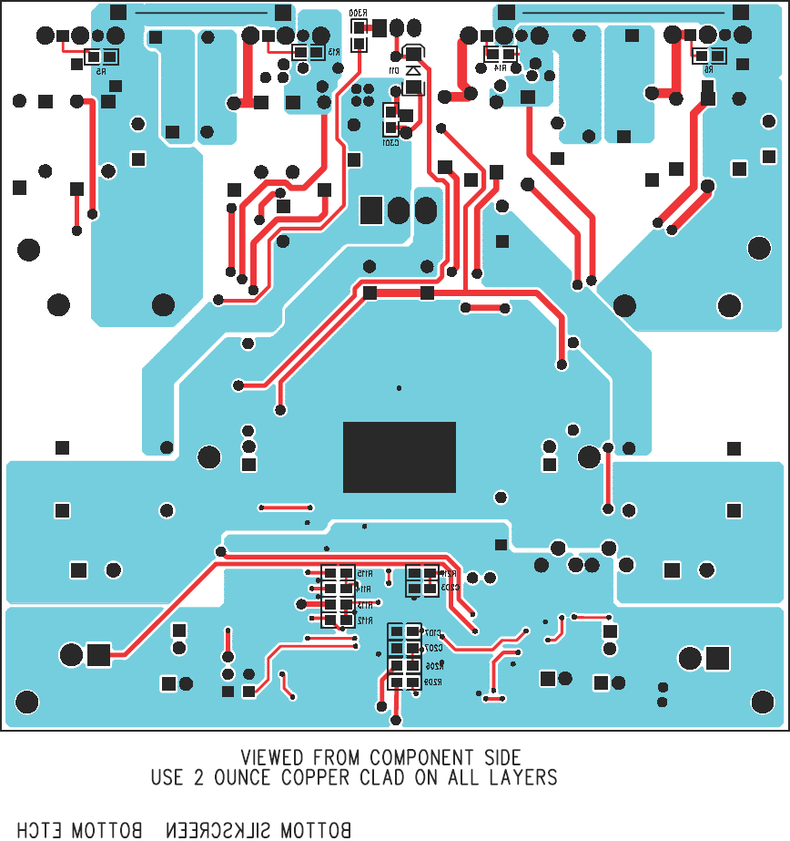

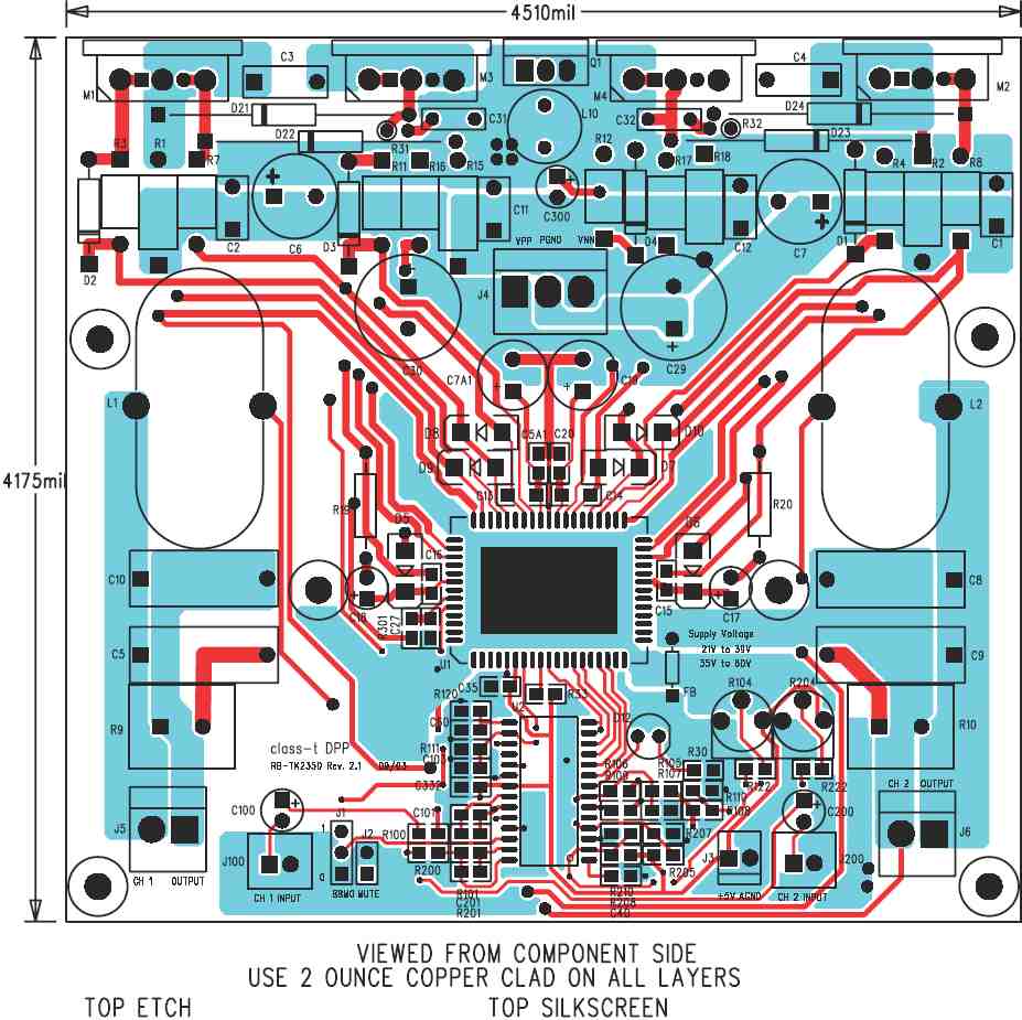

Anyone have a picture of the PCB layout? Any way to reverse engineer it so I could try to add 4 more drivers to it?
