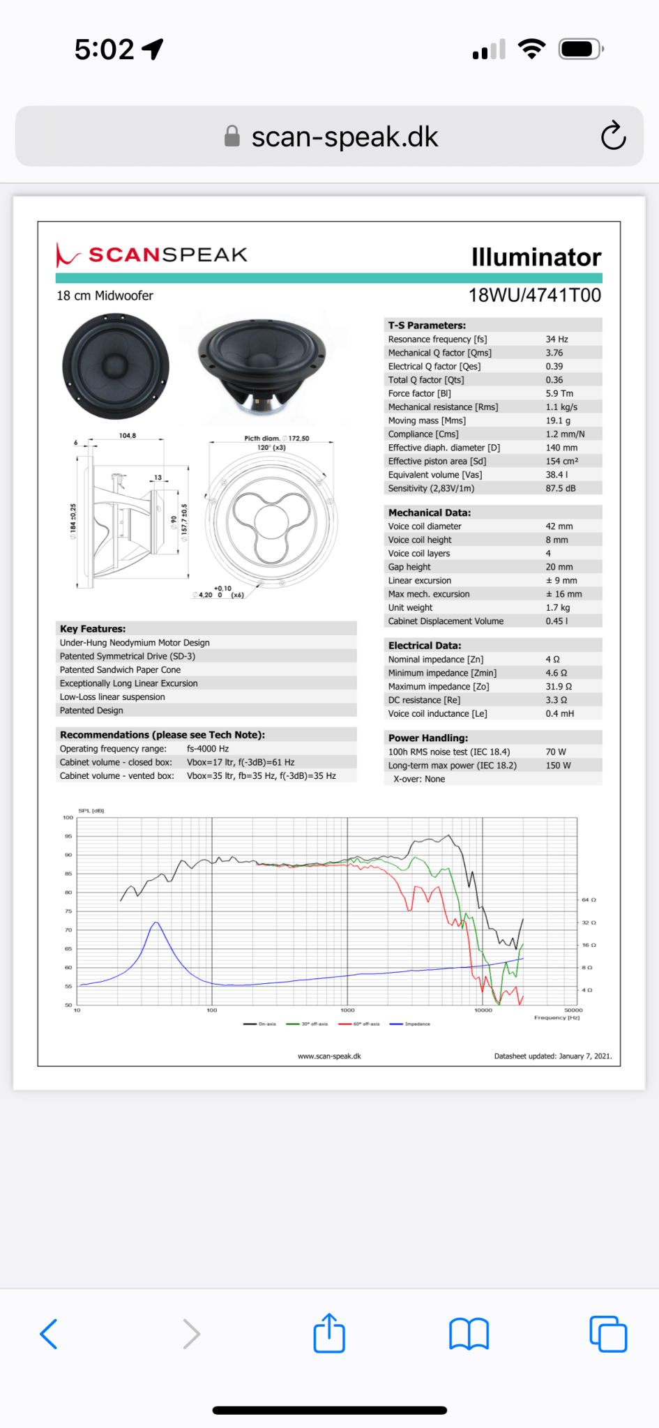

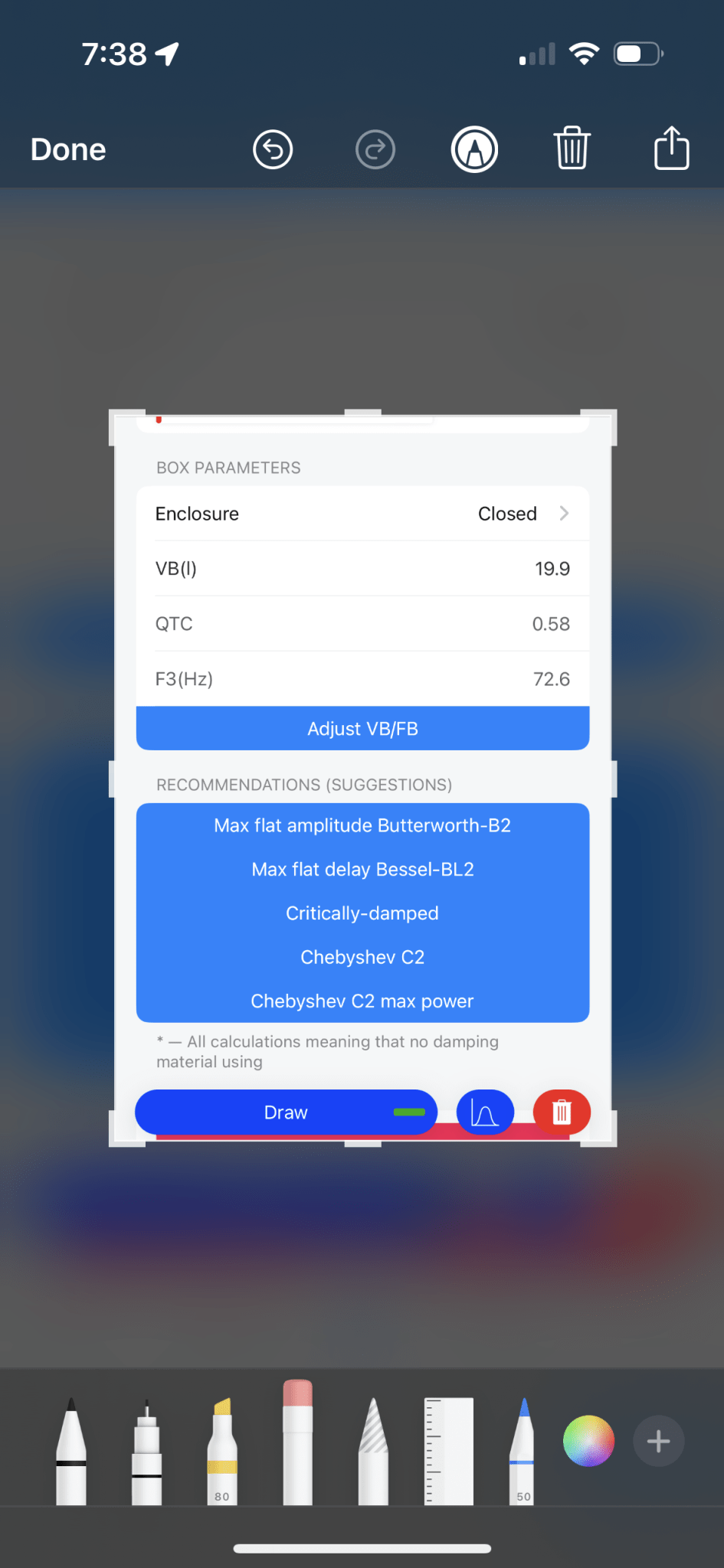

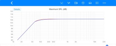

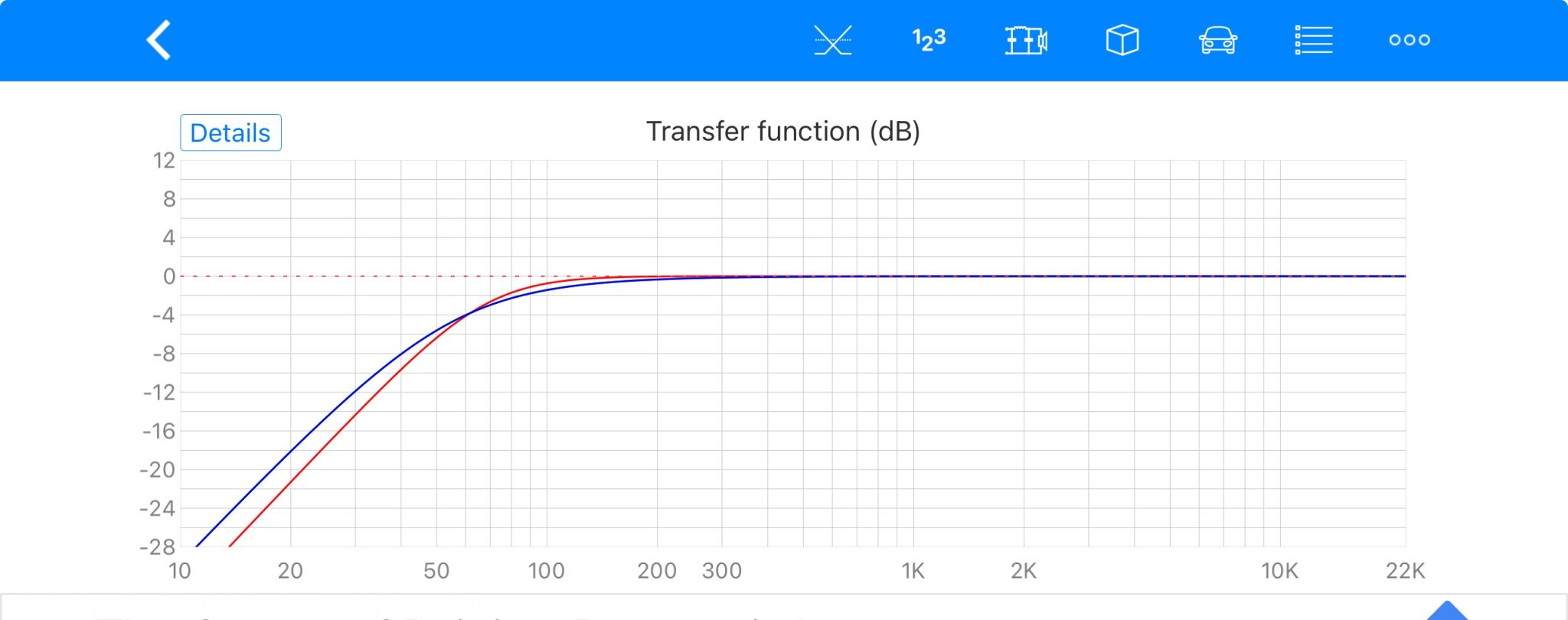

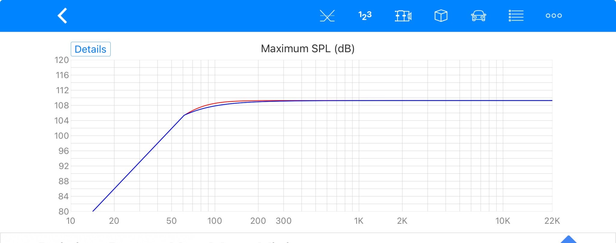

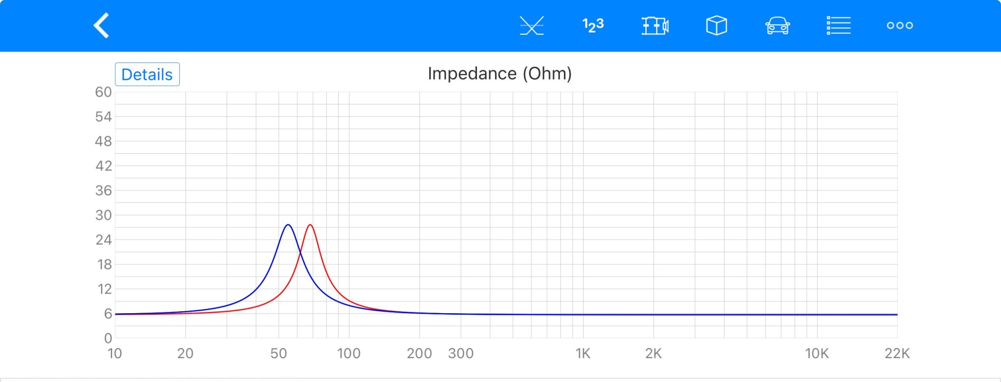

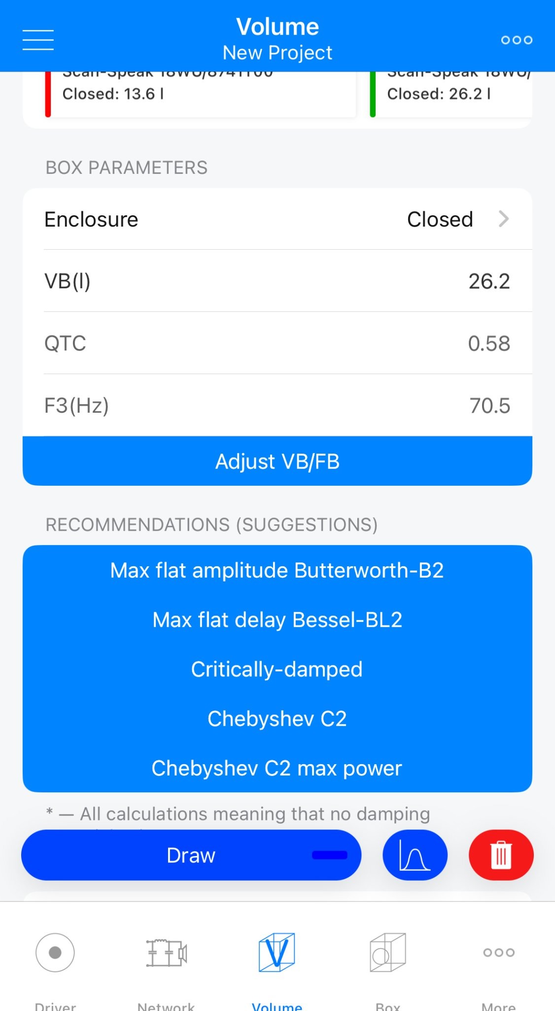

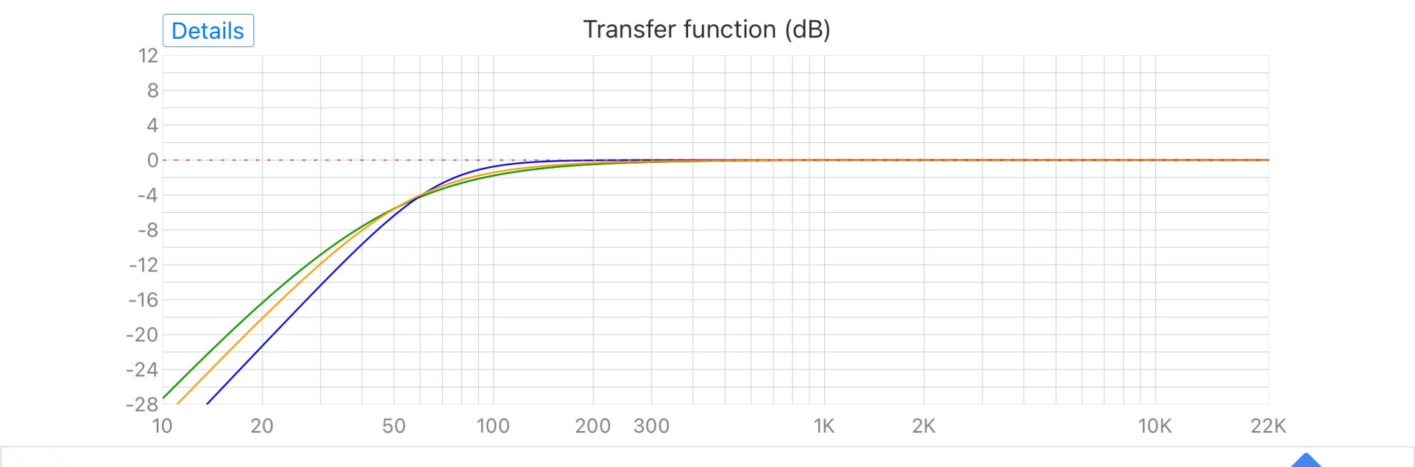

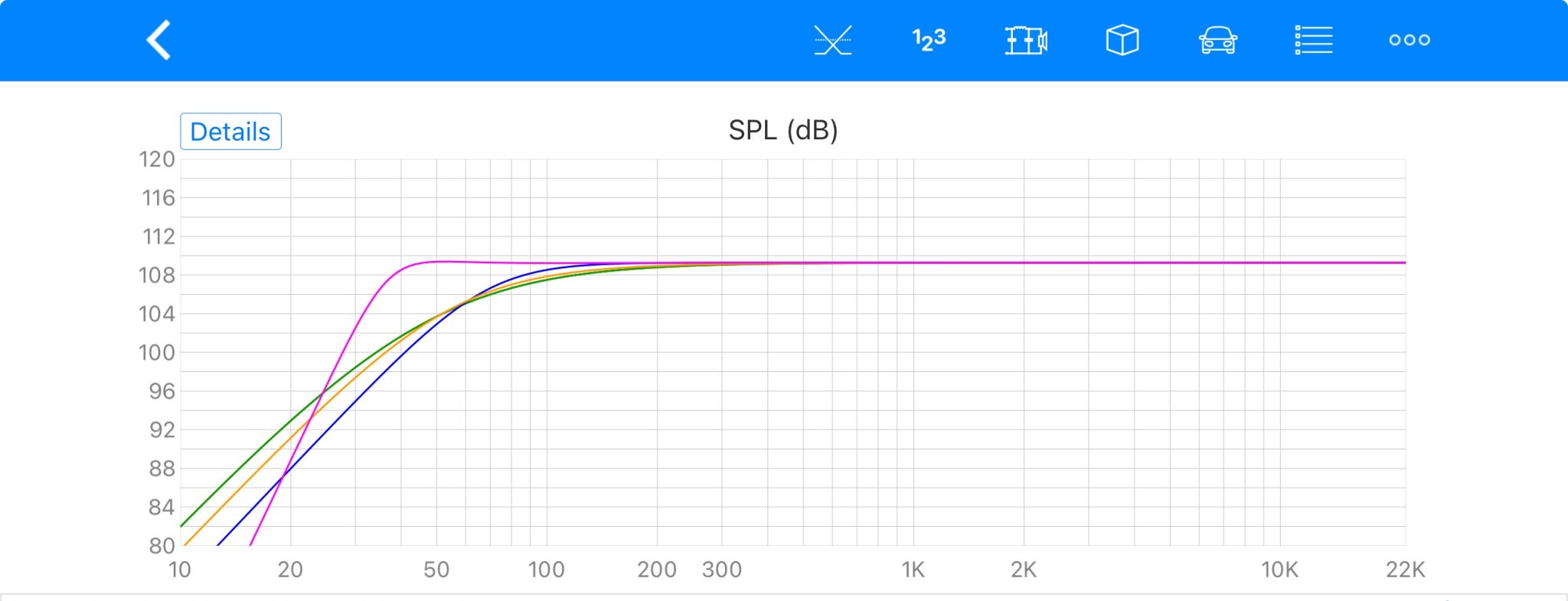

I ran a simulation in the smart phone App to give you an idea on the Illuminator 7 inch paper cone driver.

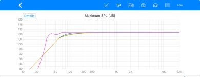

The max spl in the pass band is about it 109 db @ 1 metre. In the sealed alignments it’s limited to 70 hertz. If your intending to use it as a sealed mid bass driver the enclosure sizes are
Litres. QTC. F3
14. .707 68.4
26. .58 70.5
47. 0.5 75

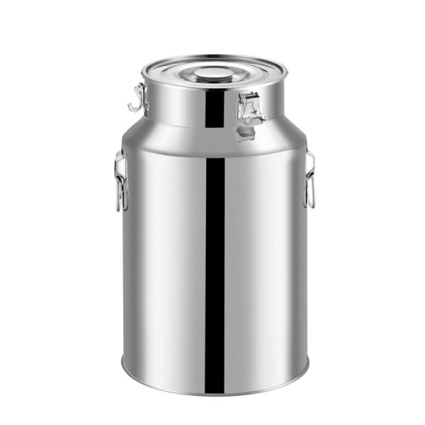

A sonotube used for concrete forms with mdf end caps is an option l haves used as a sealed enclosure. The enclosure should be lightly filled with fibre glass insulation.

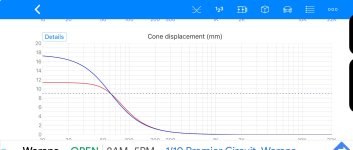

I also ran the bass reflex alignment. This driver has real potential. In a 34L enclosure the f3 is 35 hertz
Litres. QTC. F3
14. .707 68.4
26. .58 70.5
47. 0.5 75

Sonotube is an interesting idea. Do you mean that your cylindrical speaker enclosure was made of hardened/compressed paper? Or you used concrete inside the sonotube? Is it sturdy and air-tight enough?

With larger sealed box, the F6 and/or the F10 goes lower at the expense of the F3. But you can always EQ-it to the desired F3, F6 or whatever response you want as long as the system can handle it.One thing I noticed interesting is that F3 goes up as the volume becomes larger, which seems a bit counter-intuitive. Maybe the sensitivity goes up at the cost of higher F3?
The lower QTC sealed enclosure follows the high pass electrical filter.
The effect is a more gradual curve that starts at a higher frequency. It does go a bit lower too.

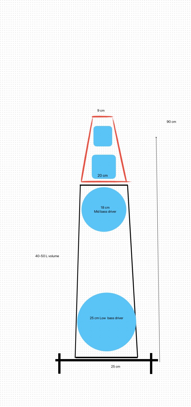

Yes theses tubes are stiff cardboard quite strong. I would make a disk out of plywood.
Make it somewhat larger than the driver so you can carve out a round over. That way you can use the largest sono tube
You could have a rectangle box shape further back that is not visible from the front
See my attached sketch.
The Surrounds on the Purifi are strange but they apparently work.
My suggestion is not to paint yourself into a corner with the industrial design until you have a mock up that works as it should acoustically.
I recommend that you start to realise the impact of different baffles and driver locations on baffles.

1. I recommend you use the QTC 0.707 enclosure if a smaller enclosure is preferred.

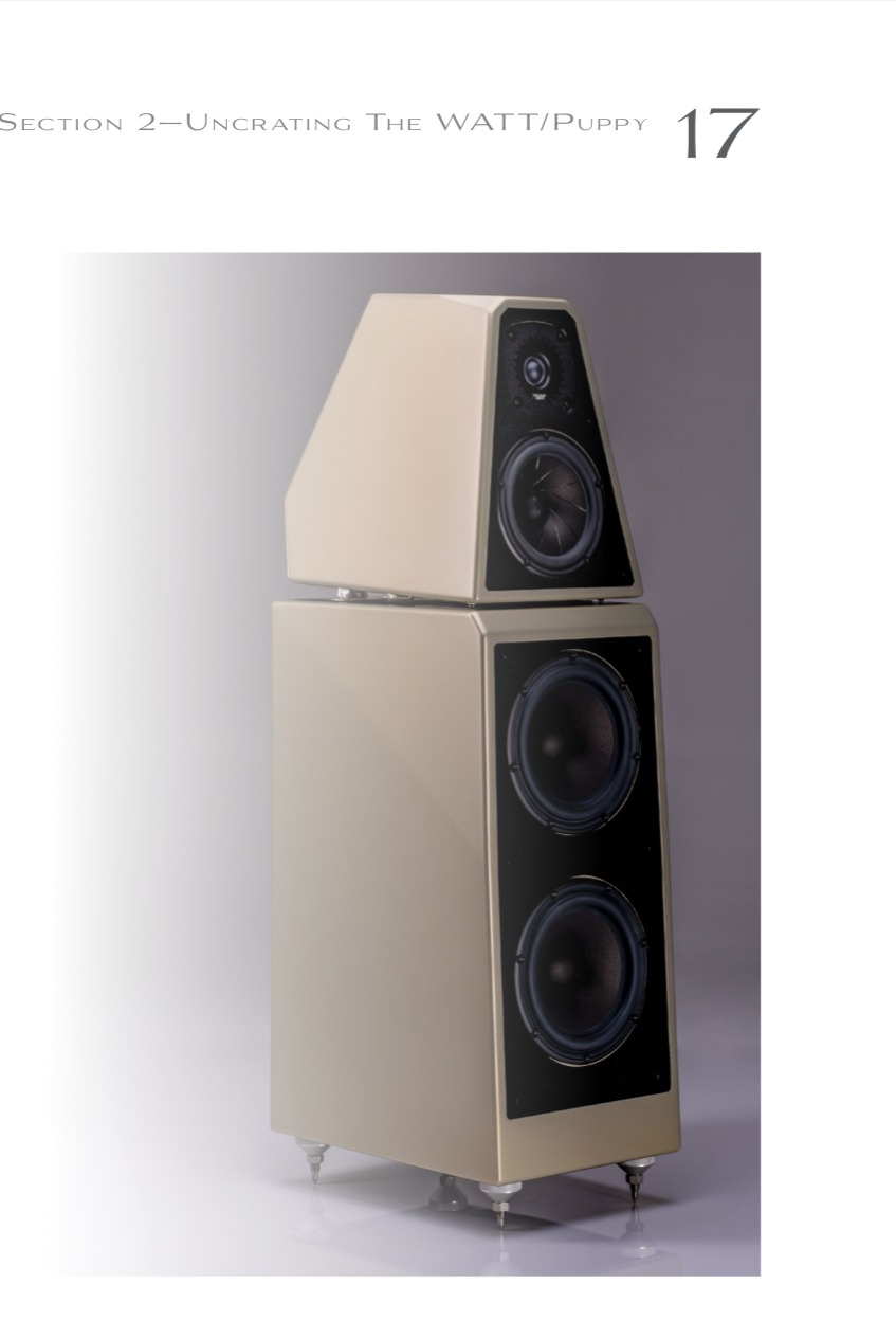

While not wishing to cross your concept of using cylinders as you are starting to realise the volume requirements of a woofer can become a problem.
Realising this and your desire to evolve your project another approach may be to your advantage.
The width limitations of your project and the desire for a mid bass driver creates a cabinet design problem requiring two independent chambers.
Two such chambers can efficiently be incorporated into a rectangular shaped low frequency enclosure.
The satellite enclosure sits atop of the low frequency enclosure. With this enclosure you can apply 3D printed diffraction control. Notably for the tweeter. The satellite can be re configurated with different drivers.
I see the low frequency enclosure as a more matter of fact design exercise based around a driver selection to smoothly cover from 30 hertz to 800 hertz. The design can be easily predicted in a simulation.
Issues such as baffle step can be engineered out quite effectively using two drivers with overlapping ranges.
I chose a 25cm 10 or inch driver for the low woofer because needs to do more work than the 18cm mid bass driver. A 25cm woofer is also more efficient and will produce low distortion all things being equal. The additional width can be an aspect of the industrial design.
The head or satellite may need several revisions and you have the flexibility to do this experimenting with alternative diffraction control shapes.
I think overall you would find such an approach much easier to assemble and give you at least one known aspect to the overall design. Anchoring the design with the bass will make sorting out the system much less complicated.

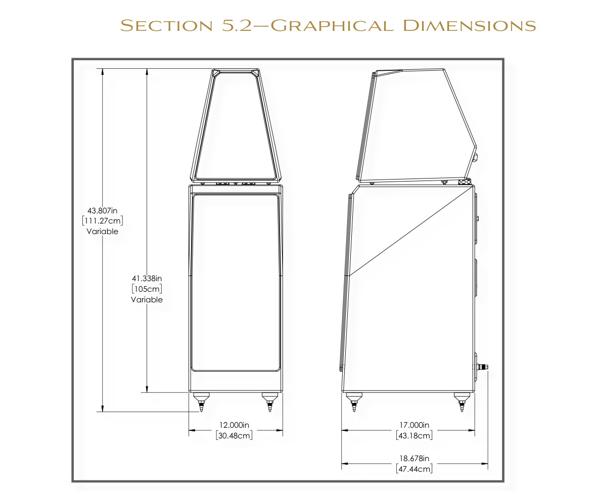

I thought that OP wanted to follow the Gallo's way...and Macka just followed the box enclosure style.
So there are two opposing treads and I much prefer the first thread...er...Trend, which is naked. Conflicting with the cylinder shape which offers no baffle to calculate radiation and adds the problem of internal aerodynamic which seems that might be mitigated by tapering in some cases where the magnitude is not big (midrange) or take advantage of mass loading of the air column where long wavelengths (the 1/4 wave...) play, so bass.
Wood for boxes is out of style, it follows
Attaching and suspending the cylinders is the new challenge

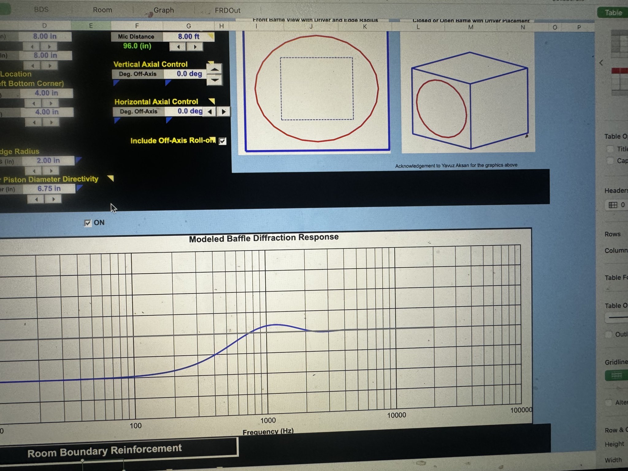

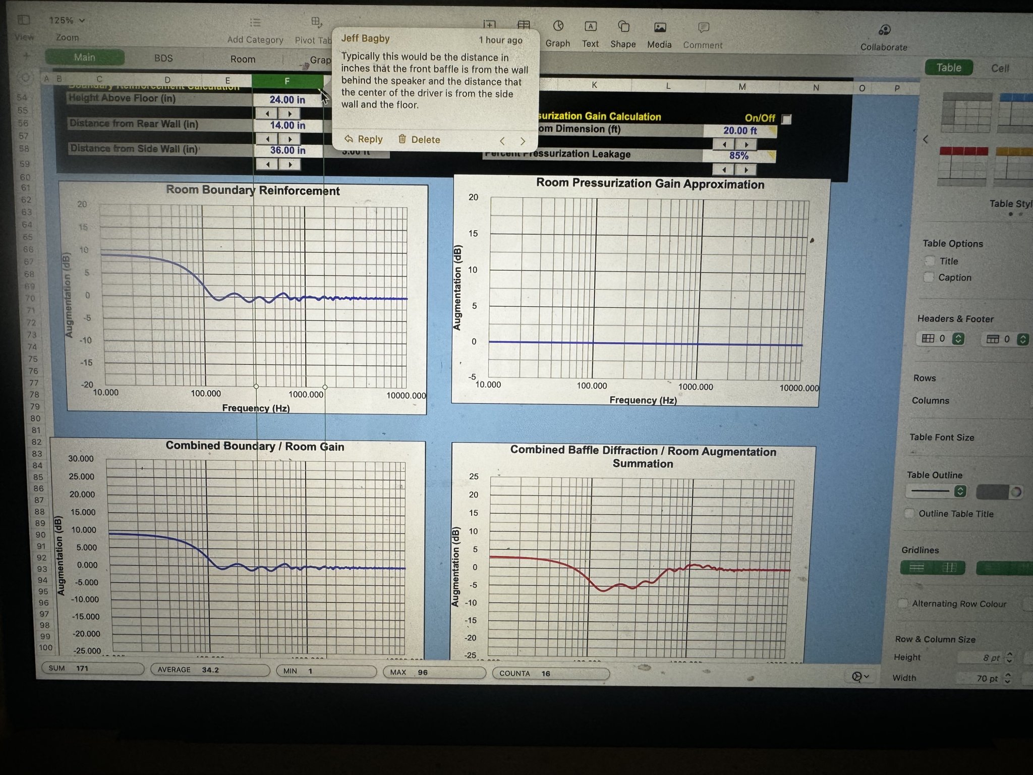

I ran the Diffraction and Baffle Simulator 1.3 today. Unfortunately the results aren’t promising.
Using a square 8” baffle with a 2” radius the baffle has a -3 db point at 400 hertz and -6 at 100 hertz. The round over had no effect on the baffle step. Only on the diffraction bump in the pass band.
Looking at the combined Baffle Diffraction/ Room Augmented with the driver located 24” above the floor and 14” from the rear wall there is a 5 db trough below 400 hertz dipping to -7 db at 120 hertz.
The impact: Even with electrical EQ the driver and or the power will quickly run out of headroom attempting to operate with a smooth flat response down to 150 hertz. Keeping in mind the sealed mid bass enclosure has a -3 db point of about 70 hertz the baffle step decimates the system working correctly.
The idea of a mid bass woofer operating in a separate pass band and is not going to be satisfactory because the reinforcement is required from both drivers above 250 hertz.
The Solution: Commercial loudspeaker manufacturers of tower loudspeakers are well aware of this scenario. The solution is to employ additional woofers in a vertical layout on these narrow baffles. Each woofer adds +3 db acoustic output. By staggering the low pass crossover points a smooth response can be obtained.
Referring the the link below the is an Excel spreadsheet.
Go through it and model your woofer trying some simple baffles
http://audio.claub.net/software/jbabgy/BDBS.html
