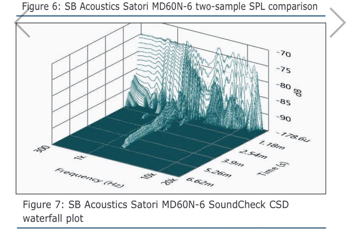

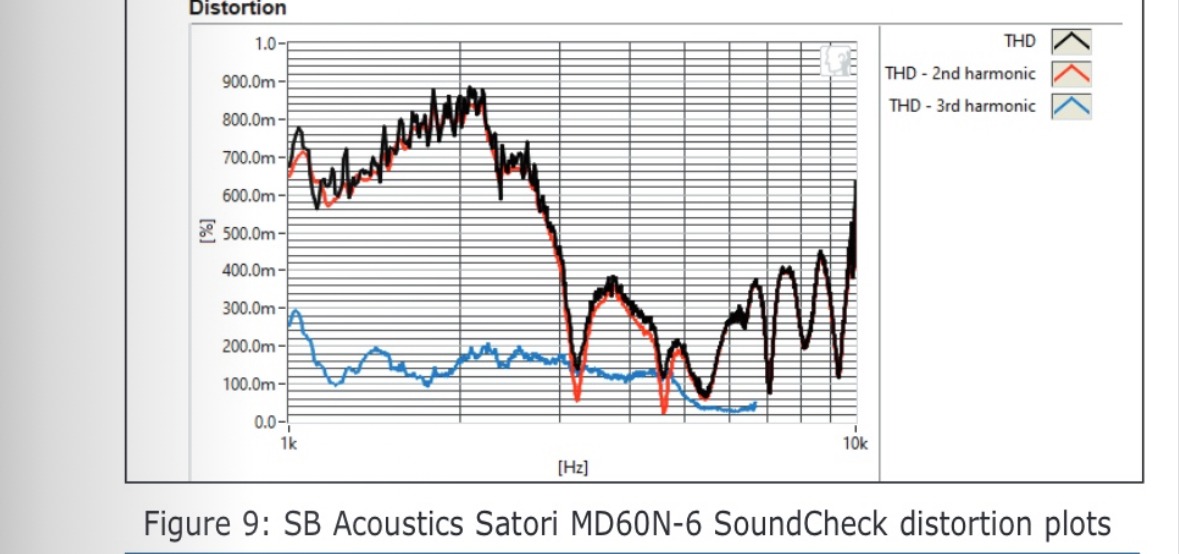

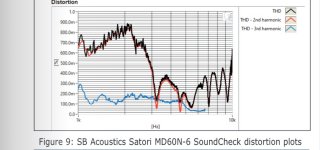

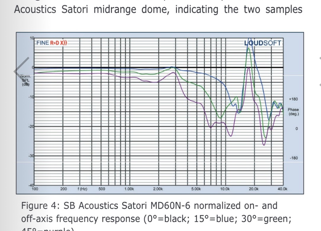

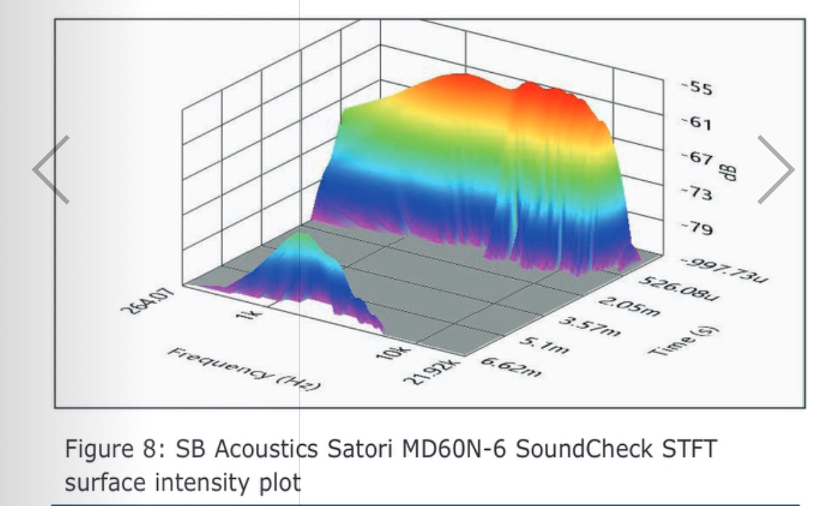

These are some real tests SB acoustics 2 inch dome. It’s the real deal. The dipoles be easily EQ out with dsp.
Frankly if it were me l would stick with SB for the purposes of selecting drivers in this situation. They are not in the Volt league but they are not $$$ prices either. SB are a major OEM driver manufacturer.
