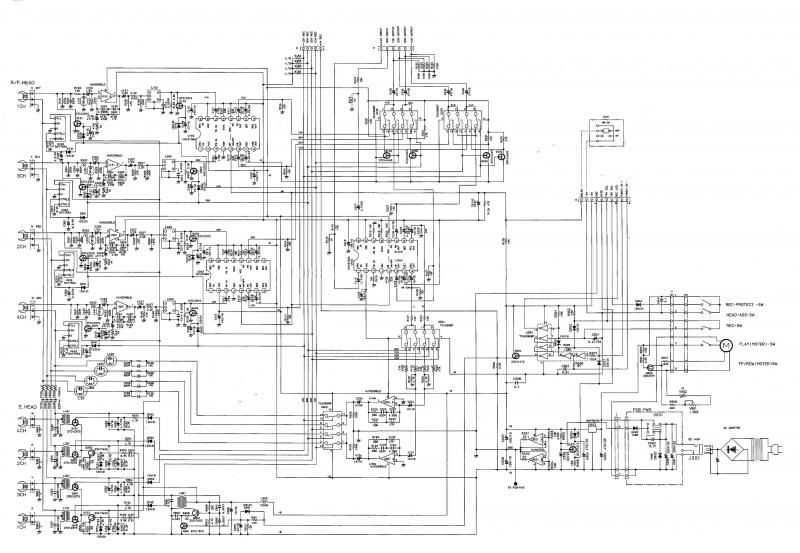

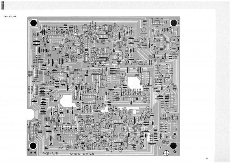

Schematic and PCB for the rec/play-section

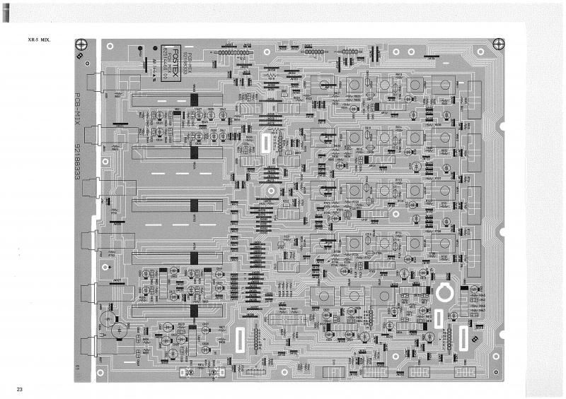

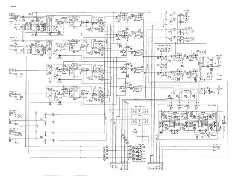

Schematic and PCB for the mixer-section
The circuits are too small to be useable but I can make out the four playback amps at the left (the opamps). There also seem to be four muting transistors on each. If any one of those is "on" then the corresponding amp will have no output.

Page 23 Play/Rec PCB
https://www.dropbox.com/s/foze1gbpcb3eu1c/XR5_sm-23_pcb_recplay.jpg

Page 24 Mixer PCB
https://www.dropbox.com/s/mj9ov28wgw70iqa/XR5_sm-24_pcb_mix.jpg
Page 32 Mixer schematic
https://www.dropbox.com/s/08ix23r9ec77c0k/XR5_sm-32mixer.jpg

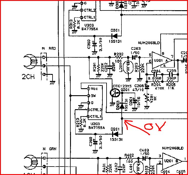

Some quick checks. First make absolutely sure you have identified the faulty channel correctly.
Look at the circuit. Make sure the point I arrowed is at 0 volts DC (less than 200mv) and that the point marked SW on U203 is connecting to ground in playback (you need a scope for that). If you are not sure then as a test remove the transistor Q201 and link SW to ground.
Does it play ?
