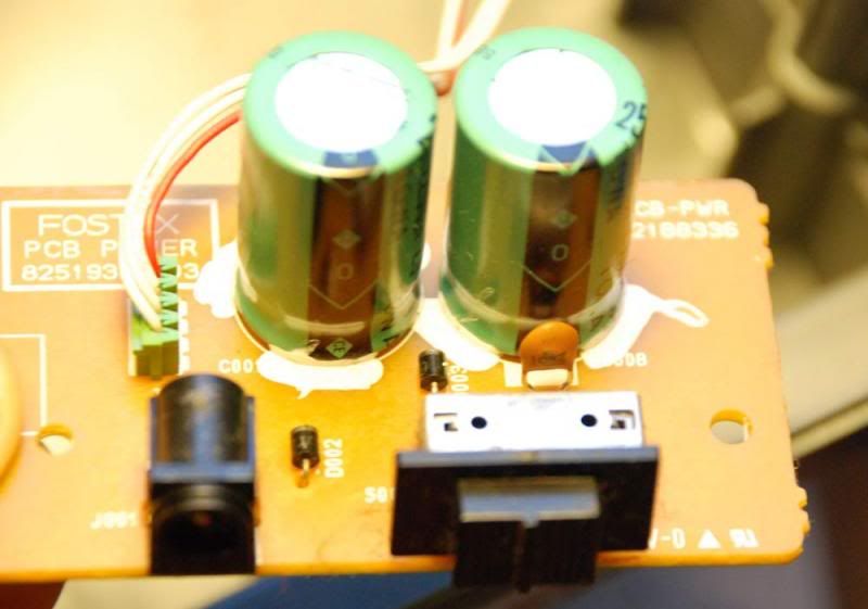

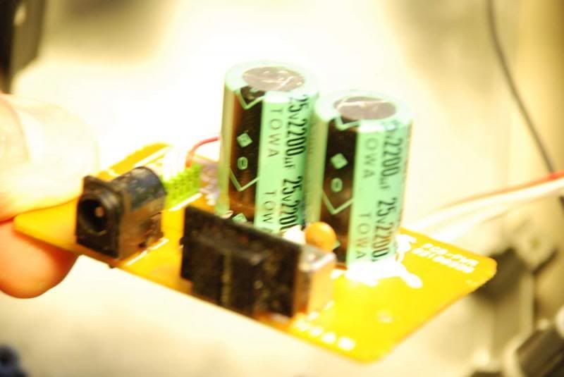

No, can you draw your own schematic using the PCB as it is very simple.

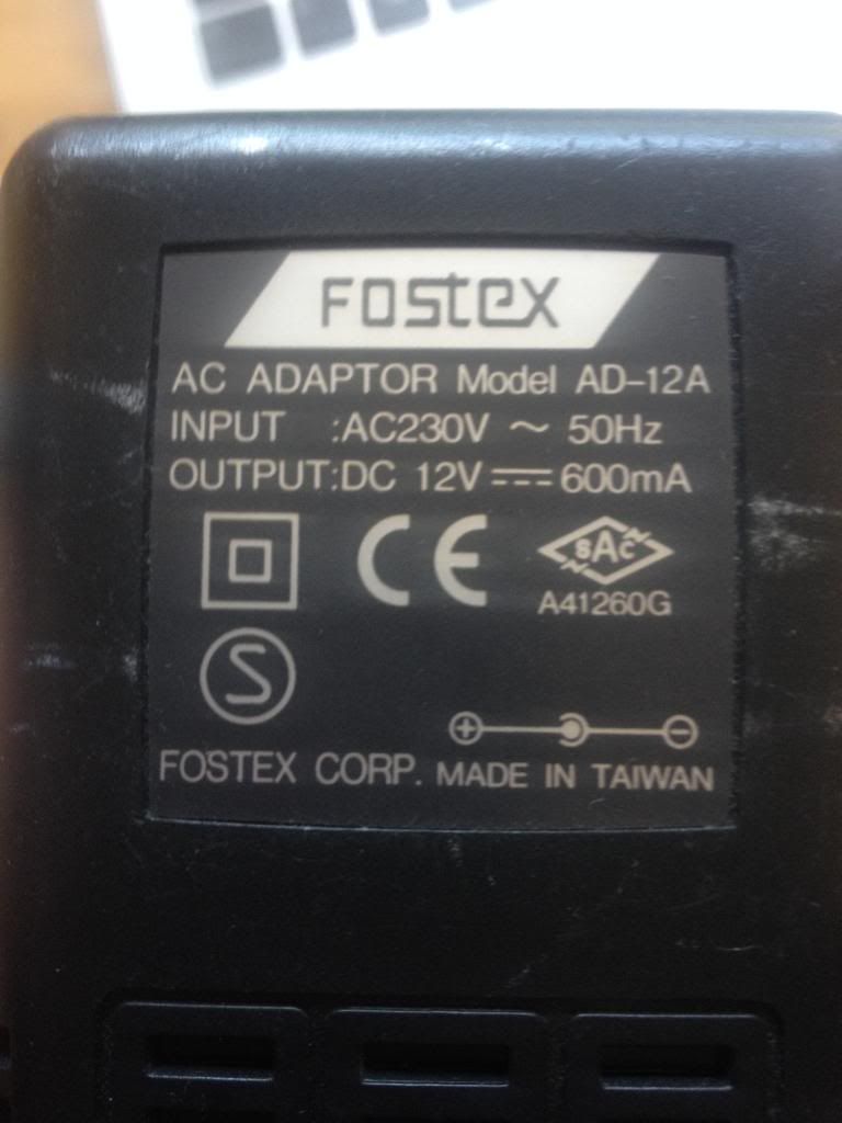

Can you take a photo of the label on the PSU.
Can you take a photo of the track side of the little PCB.

So, here are the pics of the small power PCB.
This is the lettering on the PSU:

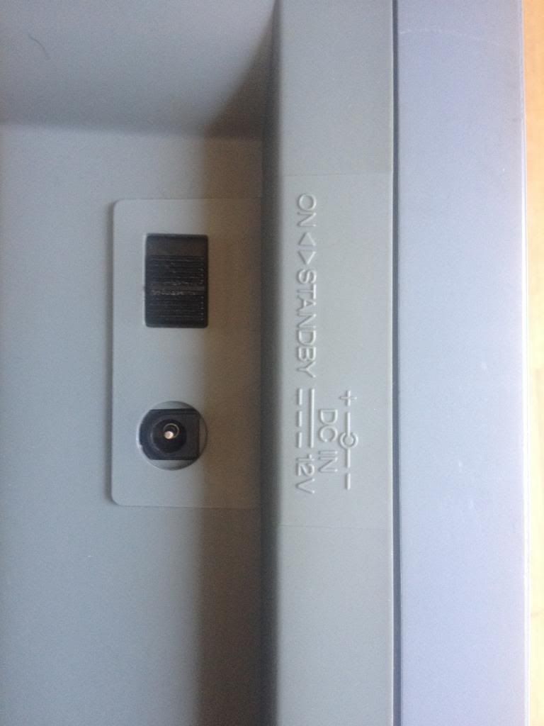

And on the back of the machine:
Haven't had time to really try out the machine. If I could do something more to make it perform better I'm all in for it!
