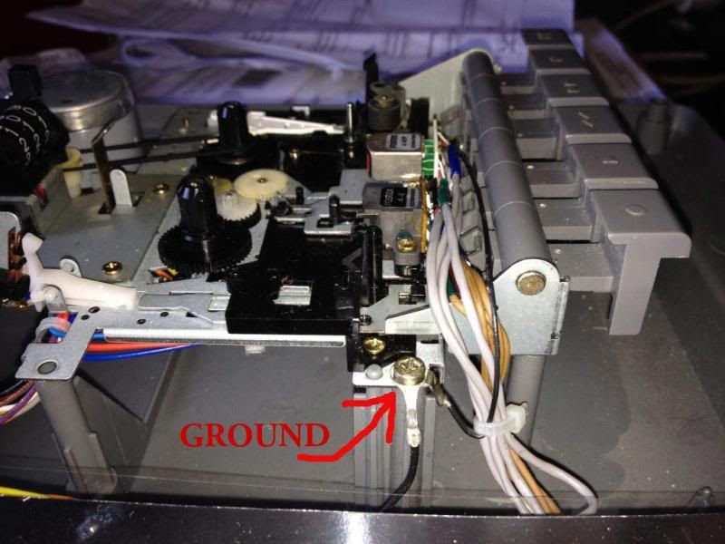

Oh, another thing. Can there be such a thing as a negative voltage? I might have left out some minus symbol on some readings.
When measuring the voltage over the 7810 I used the following spot as my Ground (black pen):

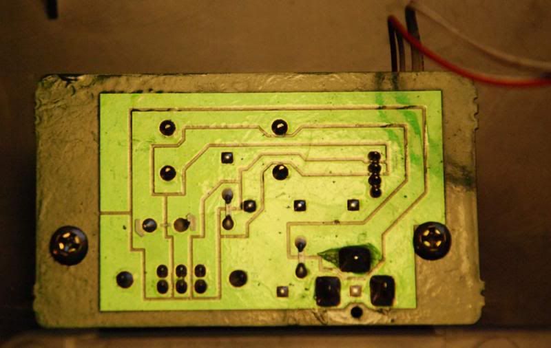

The little PCB shows the two big caps are in parallel. The negative connection of the caps is almost certainly the "true" ground point and is the point to which all voltages would be measured. The point you have marked probably is connected to the same point but confirm it is... it may not be.
Assuming the 7810 is used in "voltage" mode i.e. as a regulator, then there has to be at least a 12 volt or so differential between pins 1 and 3.

I get the impression that the heatsink around the regulator is connected to ground. Between leg 1 of the regulator and the heatsink i get 14.7V.
Between leg 2 and the the heatsink I get 0V.

Seeing the other side of the power PCB might help us explain what is happening.
Sure!

Tracing the PCB reveals no surprises. It is a DC power supply and requires a DC input. The bottom diode is across the DC input to protect against incorrect polarity and I'm assuming that the other diode is there to protect against the batteries being installed the wrong way round.
The two big caps are across the input DC and the smaller cap is across the switch.
The PCB would require a DC input of about 15-18V. DEFINITELY NOT AC, that would kill it.
