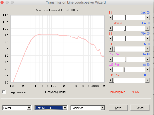

Why not a W5-2143 in a TABAQ? There is a sim for it in the TABAQ thread. A friend of mine built a pair, they sound amazing!
The driver is €71.45 on Soundimports: Buying a Tang Band W5-2143 woofer? - SoundImports
I think the W5-2143 is one of the best full range drivers with deep bass, good sensitivity, and very nice mids and highs. It should work exceptionally well in a MLTL. I think there is a Tabaq design already built and tested.
Bjorn's sim attached for your convenience! And someone posted a planset here: TABAQ TL for Tang Band

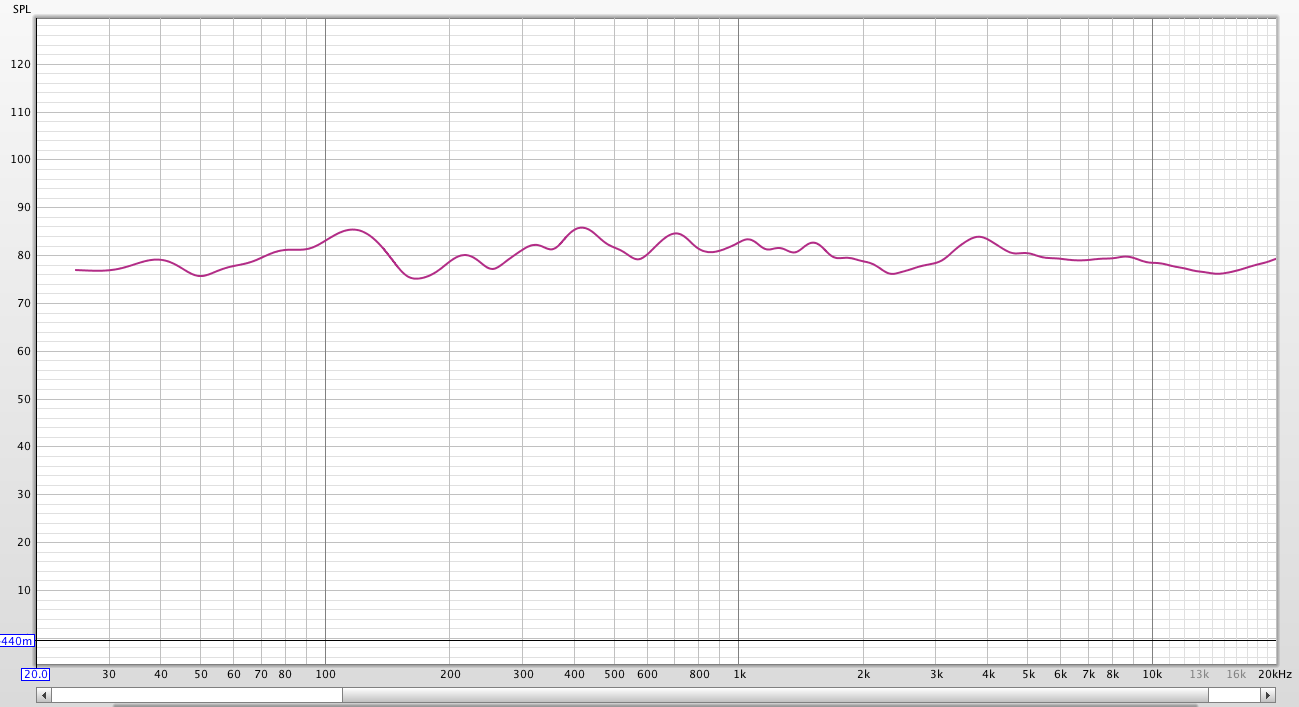

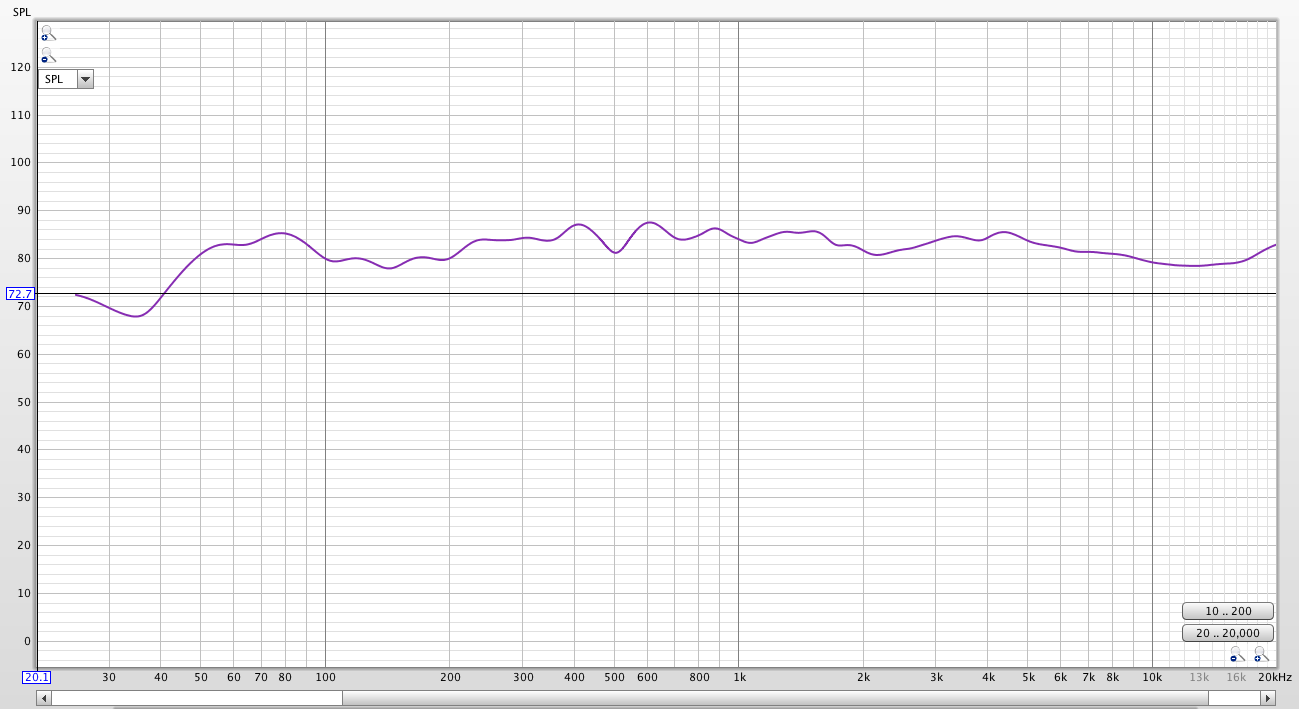

Just made a quick MLTL prototype for the SBA 5x8.
I just added a tweeter with only a 2.2uF cap on it to fill in the highs. It would need to be padded down a hair, but the responses have been... surprising!
1st measurement is taken at about 1m, 2nd measurements is at listening position to add the port and room gain to the mix.
I like where this is going.....
