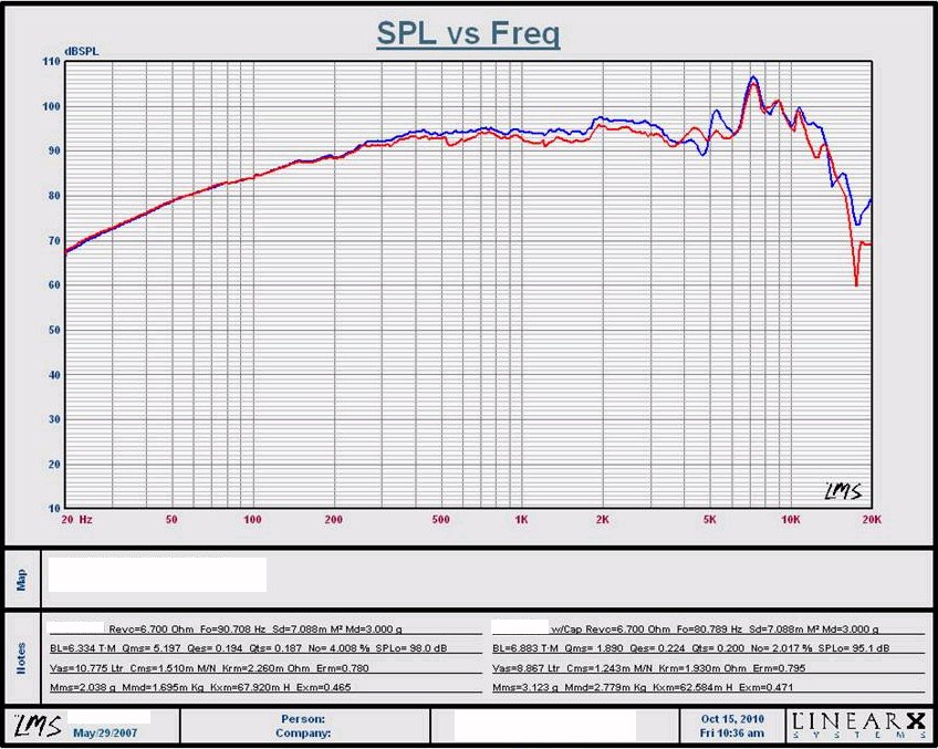

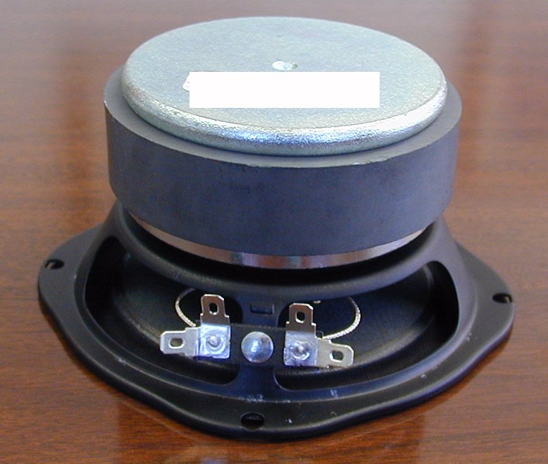

The blue line is no dust cap. I do not care for the dust cap one or the dust cap chosen so am am supplying a different dust cap. About as good as a mid as one could ask for.;)
4.5" with 1 inch VC and 20oz magnet- 2 grams and 98dB? Am checking.

In your subwoofer testing what was the cutoff slope for the low pass filter on the subwoofer? Did you use a FIR filter for testing? What amount of THD? If THD is over 3% second harmonic then there is a lot of 160Hz in the 80Hz output, as example, giving away the woofers location. Just questions please. Not accusing anyone of anything. Really curious actually on the details of your testing.:)
You did good finding a driver in today's power hungry environment. The difference between 89dB and 95dB is the difference between 200 watts and 50 watts. Not that there is a 95dB speaker yet. 94dB for sure and with the right dust cap maybe 95dB. Xmax at distortion of 10% THD is predicted to be over 1.5mm, which is pretty fantastic for a mid.
