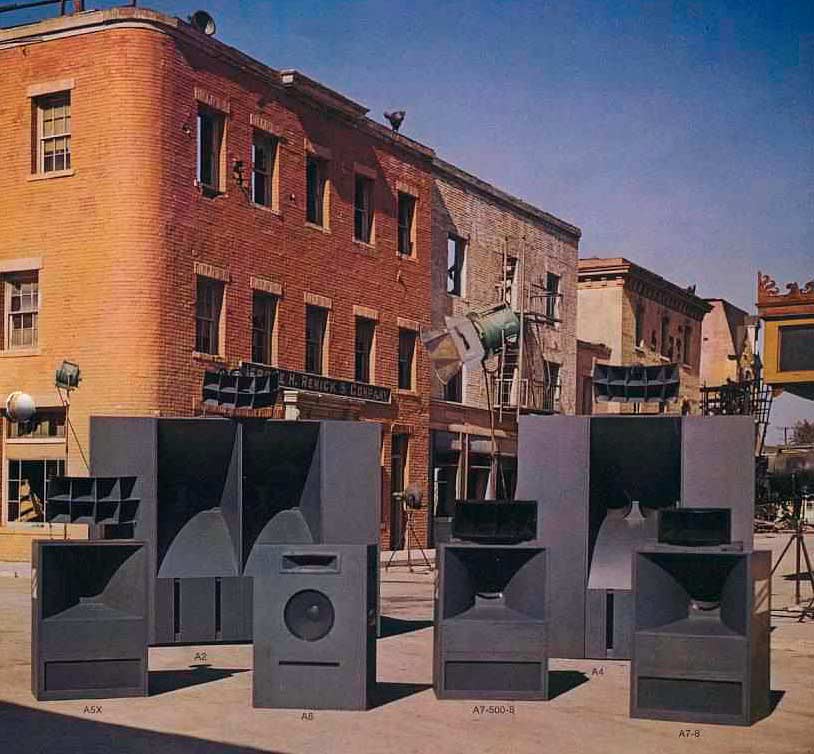

You want loud, go big. That's all there is to it. Think about the size of the speakers behind the movie screen. Do you think cheapskate theater owners would spend all that money on not one, but three huge loudspeakers if there was any other way to fill the theater with sound?
