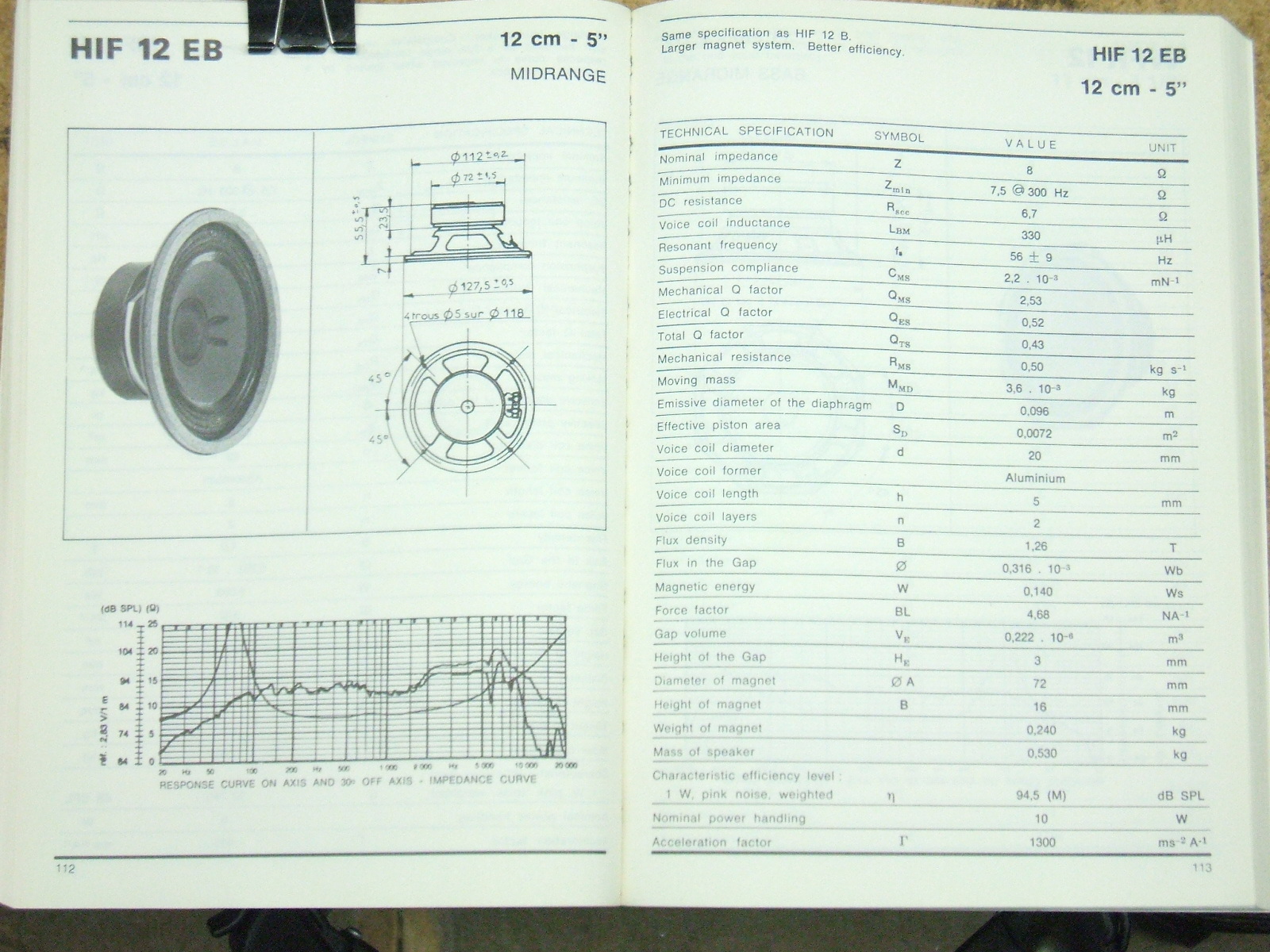

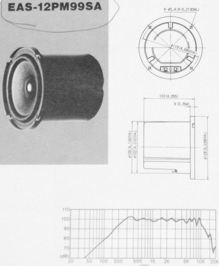

Of special interest, there are others. Do a search.😉
