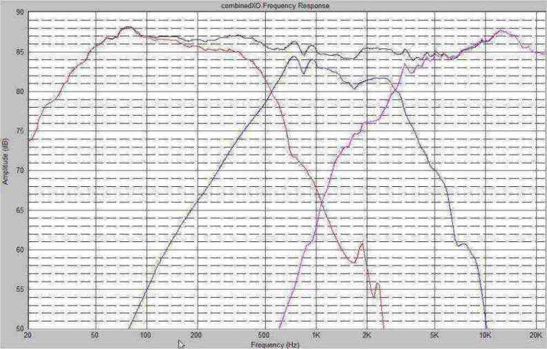

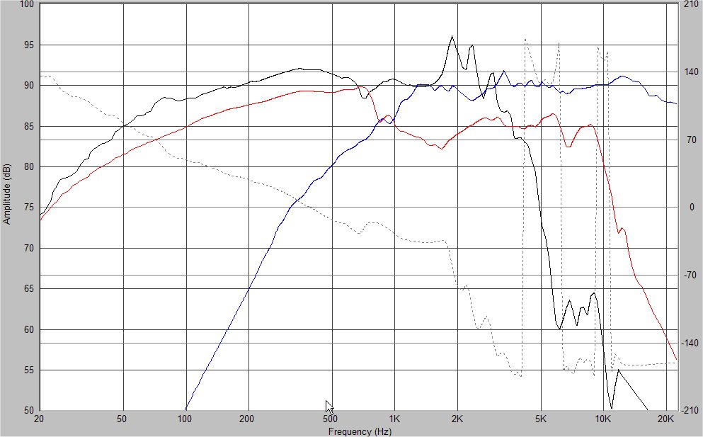

Omni,
I thought your XO details belong here, as we work through it. The FIRST graph is your drivers only, after the FRD tools, no XO, in phase. There's some interesting things to note:
* Peerless: understandably good bass extension and classic cone break-up at 2kHz, high sensitivity,
* CA15: Extended response, reduced sensitivity, dip from 700 to 1700Hz. Interestingly, Roman B's Calypso design showed a smaller dip at 1400Hz.
* 27TDFC: fairly smooth, resonance low at 550Hz.
( My comments below are from a beginners perspective, and when (not if!) I make blunders or oversimplifications, I hope someone corrects me ).
The overall system SPL will of course be determined by the CA which shouldn't need any attenuation or maybe very little. I still don't know if Speaker Workshop includes Bandpass gain, so we may get another 2dB for the CA? A target goal of a 4th order acoustic response for each network section might do the trick, as an initial choice anyway, for say around 87dB I hope!
The SECOND graph is my first brief attempt at a full 2nd Order design, Mid polarity inverted. The tweeter xo still needs some work (it was getting late), and offsets for all drivers was '0' inches.
I did get a slightly better response from other values, but forgot to save it. So there may be more than one way of getting an acceptable result, prior to tweaking. The best sounding may be
different again. At +- 2dB its possibly ok, I'll try for smoother when I get your measured offsets.
The tweeter Fs at 550 is way down, so it might just be possible to go all 1st order except for the Peerless, and assuming the CA off axis is still acceptable out to around 4kHz. The TDFC even if crossed at 2200Hz, 1st order electrical should be down around -27dB assuming 6dB LPad and driver rolloff. Its worth simming anyway. grant

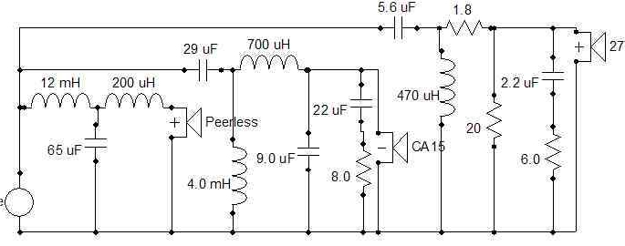

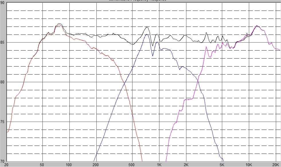

If anyone else is interested, this is my latest xo for Omni's drivers,
including specified Zobels on mid and tweeter. I'm not sure if its a good
idea to show it, because of my lack of knowledge, but for what its worth here goes... (the response looks acceptable if anyone wants to SW sim it), but its based on '0' horizontal offsets for all drivers. grant
(any comments highly appreciated)
I forgot to mention that to 'a trained eye' it might look ridiculous!
But, hey you've got to start somewhere, and this is the flattest response I could get from SW given the FRD'd data, and constraints.
Please feel free to comment on its viability, or tell me if its garbage!
grant

Hi, I don't understand the 200uH on the Peerless, 🙂/sreten.
seems you have a bit of "dips" around crossoverpoints
12mH on bass could be too big
29uF on mid a bit small
0.7mH om mid maybe a tad too big
tweeter slope has a bit of ripple - might help with a resistor on 0.47mH (in that case 0.47mH might need adjustment)
But you might be close, and only listening can tell
