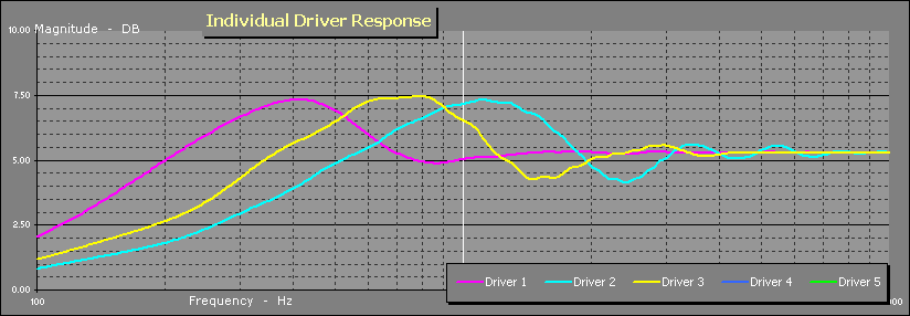

Alright, I am gonna try to attach my baffle simulation driver response chart here............Sreten, can you provide an interpretation of it ? Tinitus, if you're still here please chime in. This was done on Baffle Diffraction Simulator with my baffle design and driver placement, 8 degree slanted baffle. One curiosity I have though.............The operation manual states that when driver sizes are entered that the piston figure is calculated, however, it did not appear to happen for me. Do you know why, or am I gonna have to enter them in myself ? Since I am using standard inches, how do I convert square cm to square inches?.....................Driver 1=Peerless SLS 830669 Woofer.............. Driver 2=Seas 27TDFC Tweeter......... Driver 3=SeasCA15RLY Midbass...............Anyone else who reads this thread and can interpret this chart, please feel free to chime in. That would be greatly appreciated...........Respectfully..........Omni

Re: the baffle graph, I really don't know, but is it the baffle step in dB for each driver from 100 to 20kHz? Or is there more to it than that?

Without details of the actual baffle layout its hard to interpret.
It implies that you have a trapezoidal tapered front baffle.
For simulation you enter the effective, not actual diameter.
So for a tweeter = 1", for a 5" bass/mid= ~ 4".
