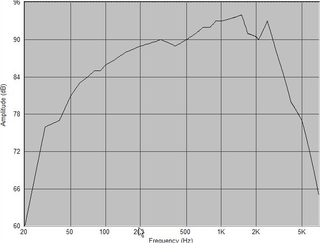

grantnsw said:Hi Omni,
I've just been trying to get the frd file (by editing .txt values) from my woofer's 20year old spec-sheet graph, which is all I have to go by. And the result looks reasonably close for a first attempt, but a little 'peaky', by 1dB maybe.
...best wishes, grant
The response appears to measured in a box so that graph includes
the baffle step response of the box, accounting for 6dB of the rise
between 100Hz and 1kHz.
🙂/sreten.

Hi Sreten,
You are indeed correct, I just noticed the small print on the P25 FR graph: "Box 50 Litres"

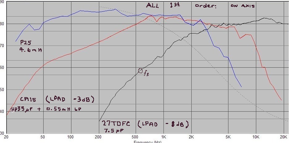

G'day Omni!
I think I had a bit of luck with SW today. After a little playing in menus and trying different things, it doesn't seem to be so daunting after all (c.f. Photoshop)! I even got my very first attempt at a simulated 1st order response (attached). Briefly, what I did:
* setup 2 Litre closed box for CA15, defined the CA, and input Zaph's driver parameters,
* setup vented box for P25 with round port and input Vifa's parameters,
* imported Calypso frd and zma's for CA15 & TDFC (many thanks to the author!),
* imported my own 'eyeball' frd/zma files for P25 (which now look very close to spec sheet),
* associated each driver with its respective files in the Properties - Data Tab,
* setup each drivers network individually (using initially Vance D. values) and calculated response,
* used the big 'red + button' to combine graphs and get a 'ballpark' result.
Result: I didn't like the graph much using Cookbook values, so modified all component values, some quite a lot. Eventually attenuated tweeter 8dB and mid 3dB. Maybe I should have attenuated first? That may have been a better idea? Also, I used 'on-axis', but I think 45deg off-axis would be better, especially for the mid. Not sure how to include baffle-step. I assume it can be done in SW?
(BTW, its interesting to see how changing component values together with attenuation affects response).
As a very first attemp, for a full 1st Order it may (or may not) look feasible? I'm not sure. So I really don't know whether or not its worth trying yet. But the result does look a little encouraging? Unfortunately, I haven't worked out how to get a summed response just yet. So the graph could very well be, err, trash.
The 27TDFC seems to be almost 30dB down at resonance 550Hz - so it might be OK 'power-wise'?
I need to read the doco more fully as I didn't know what to input for Box Leakage and Box Damping Q's? Also Port Q for P25 - no idea!. For the Drivers Tab: Inductance L1? (I just used Le) and Series Resistance R1? ( I just used Re). Could be why the CA has a peak near resonance? I'm sure SW will become very intuitive - when I better get the hang of it. Omni, I know you're trying a lot of different simulators at the moment - I don't know how you do it! Lol. I get 'brain-fragged' on one package! But FRDCombiner? Whoa!
Thats seriously complex stuff.
Ooops, I'm raving on again. Hope I haven't bored you senseless! Hope your paint finally dries!
Hi Sreten, hope you're still here! best regards to you both, grant

Hi Sreten,
If you have any comments on that last 'un-summed' graph, I would
really very much appreciate it, thanks. The component values are, in some cases very different to V. Dickason. I'm just wondering if this is feasible? (values need adjusting?) As of now, I don't have enough knowledge to pursue your recommendation for the series woofer.
But am reading the links....Many thanks , grant

Grant,it looks like you are making some headway............This is a totally different approach than plugging into formulas, and it certainly constitutes a leap of faith..................As of now, I have been going down the path of the FRD consortium,downloading the recommended programs and attempting to follow them step by step in the 7 page tutorial. Right now I have the Woofer FRD and ZMA files processed in Unibox, and have started experimenting in Baffle Diffraction Simulator, but run into a few snags there. I will also need to process the CA in Unibox, then all 3 drivers in BDS,..............then all 3 drivers in the Frequency Combiner program, before I get them into crossover simulation..........Tedious, time consuming, and filled with uncertainty.................I did another spray on the baffles yesterday.............no dice................gotta sand down 1 more time, however, I think I got the problem solved for my next attempt.........It's difficult to get a lot of uninterupted time to do this computor stuff, so my progress is only coming about at a snails pace..................I hope your mum is doing well, as I understand the time committment you need to spend with her. Recently my dad passed, and I had the opportunity to spend a great deal of time with him before, and it was worth it. Sometimes we only realize this in retrospect...................Keep in touch..................Regards...............Omni...........
IMO plugging numbers numbers into cook book formula's is a leap of
faith. But as said something that churns out graphs you don't really
understand also seems to be a leap of faith. all I can say is you keep
doing it until you get some consistency and understand whats going
on.
All I can say is cross checking with other designs should build
confidence with each tool and help with what each tool means.
I'll note that as a far as I know G. does not have a zma or frd file
of the bass/mid unit in its enclosure (the calypso is in a large vented
box) so proceed with caution interpreting the results. There should
be no reason to attenuate the mid - and this will increase Qtc of the
mid in its enclosure. 5dB on the tweeter sounds right for 86dB/W/m.

Re: the P25 & CA frd/zma's in my specific boxes. Your'e right - I don't. So for this reason alone, my project is probably pointless. The Calypso data was measured in an 11 Litre vented box, Zaphs CA test was on an infinite baffle, and Seas was in a 20 Litre closed box. (The P25 Vifa data was measured in a closed 50 Litre box).
This is the only info I have to go by, unfortunately. I was under the misguided assumption that the FR at 300Hz xo (and upwards) would not be significantly affected by the different Qb/Qtc's resulting from the above measurements. But I am probably very wrong! I will have a look at the CA responses above, and try to figure it out. Impedance is another issue. I also assume, baffle step has inherently been included in all the above measurements.
Yes, it seems pretty senseless to attenuate the mid.
