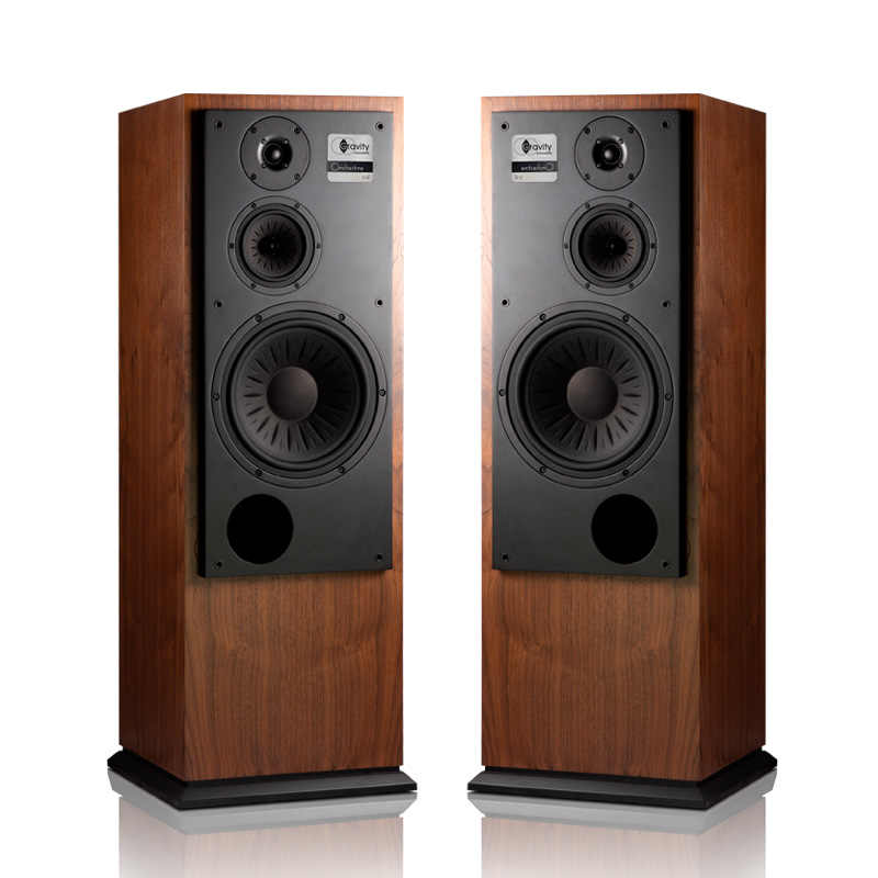

I just saw this and started to cry of happiness...
It´s exactly what I am aiming for
  • Altavoz-de-pie-HiFi-de-alta-gama-altavoz-de-3-v-as-altavoz-de-suelo-hifi.jpg_q50.jpg
You want to hang those floor standers on your walls, as in the photo you posted earlier? If not, you might be interested in something less "floor standy".

Not hanged! Just standing. It´s going to be a 80lt enclosure, so I am not far from that picture I posted.
Just small speaker stands, with the boxes on top of them. I need the tweeter to be at 1.2meters from the ground. Thats my ear level when mixing/mastering.
