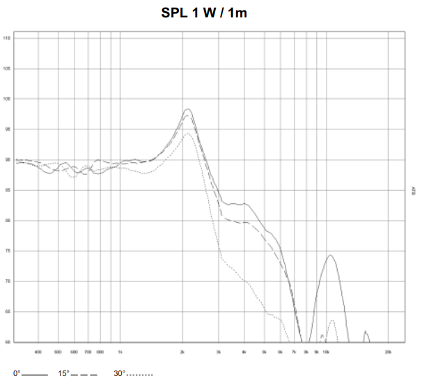

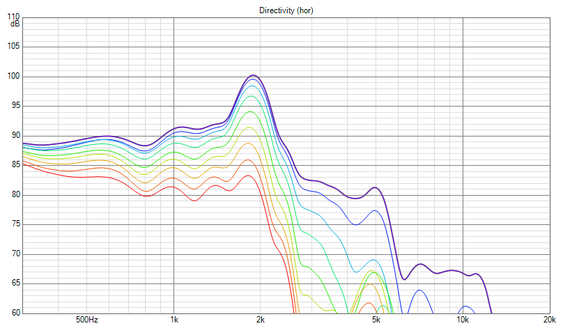

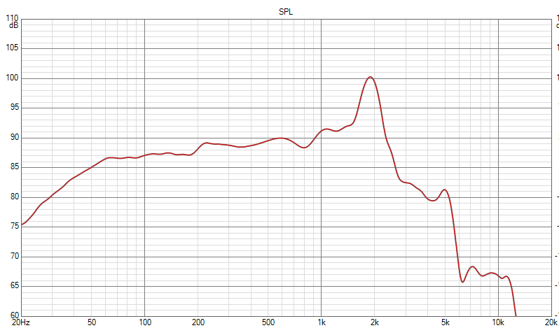

Attached are some measurements for Eton 11-581-50 Hex. It is not the same as your model but are very similar except for the Hex's 2 KHz peak.
1. Factory curve, shows FR from 300 Hz and at 0, 15 and 30 degrees, 60- 110 dB scale, presumably this is an open air wide baffle measurement;
2. The driver in a 65L box, aperiodic, with 33 x 77 cm front baffle, shown from 300 Hz and same 60 -110 dB scale;
3. Same as above but shown from 20 Hz so you have full picture of what's happening with the "sensitivity" with a real box and a baffle step.
4. Lastly, the unit is low-passed at 290 Hz with LR24 acoustical target. Shows the actual level which will then be merged with whatever mid you decide upon. The level in this case is about 85/86 dB, so anything above should work (but there are many variables beside the level in dB per se).

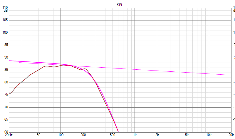

This "factory curve" says dB-SPL/1m/1W, so it relates to efficiency (power). The reminder of your post seems to be about sensitivity, which is a voltage thing (not power). You may have to convert that factory curve to a voltage sensitivity curve first.
This is a good catch. I missed it. Unibox gives the sensitivity to be 92.2dB at 1m with 2.83V. So add another dB or so to your mid sensitivity requirements.

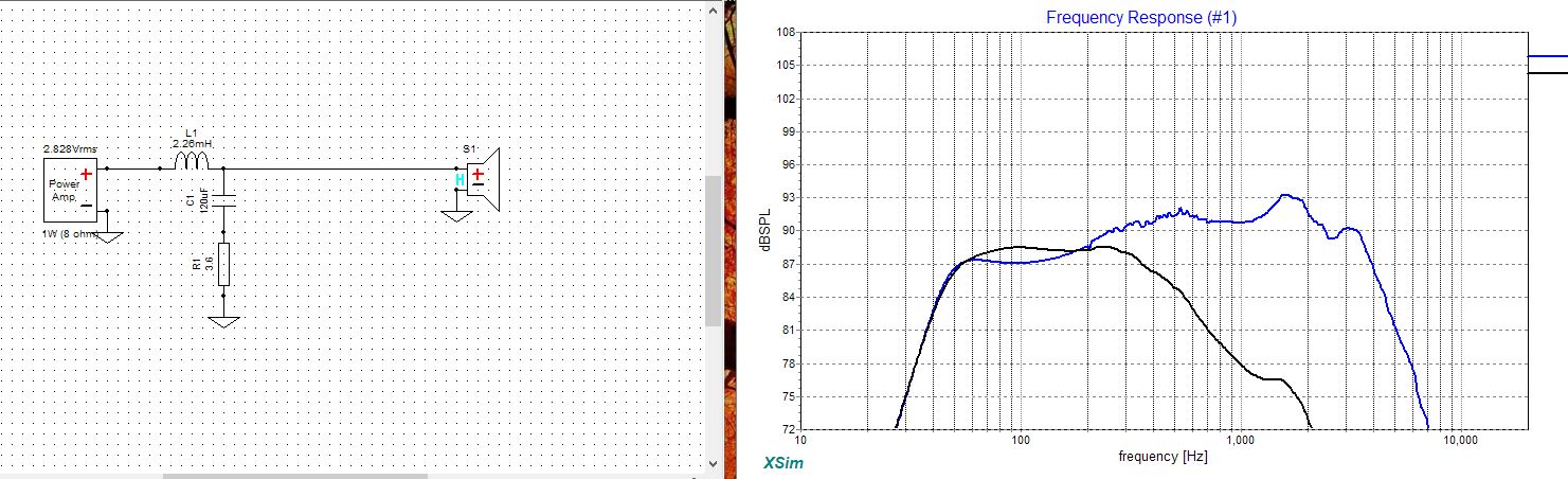

Re baffle step loss - indeed proximity to boundary walls and floor can affect how much compensation is needed but so too can your box width, box tuning and xo choices.
For eg, if you model that woofer in 50L tuned to 40Hz, you get a small 1.5dB increase in LF output. Then you add in the full 6dB of baffle diffraction from a 14" x 21" front baffle with the woofer centered 7" from the bottom and you get the blue trace in pic 1 below. If you then go with a passive xo aimed at about 600Hz, you get the black curve and a couple of dB more again in the low end due to the interaction between the driver's impedance resonance peak and the xo. Speaker sensitivity would end up being about 88.5dB or so.

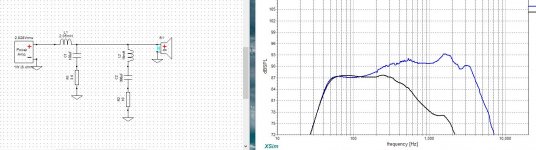

If that LF gain due to the xo isn't desired then an impedance compensation notch will keep it down and then you get something like the 2nd pic which will give you a sensitivity of about 87dB.
Doing a quick sim with that woofer made me wonder btw if a lower xo point down around 300Hz may not be optimal with a passive xo because it might need a very large capacitor to ground to make it work. Which means wasted power and an inefficient speaker. Just something to consider as you look for a mid.

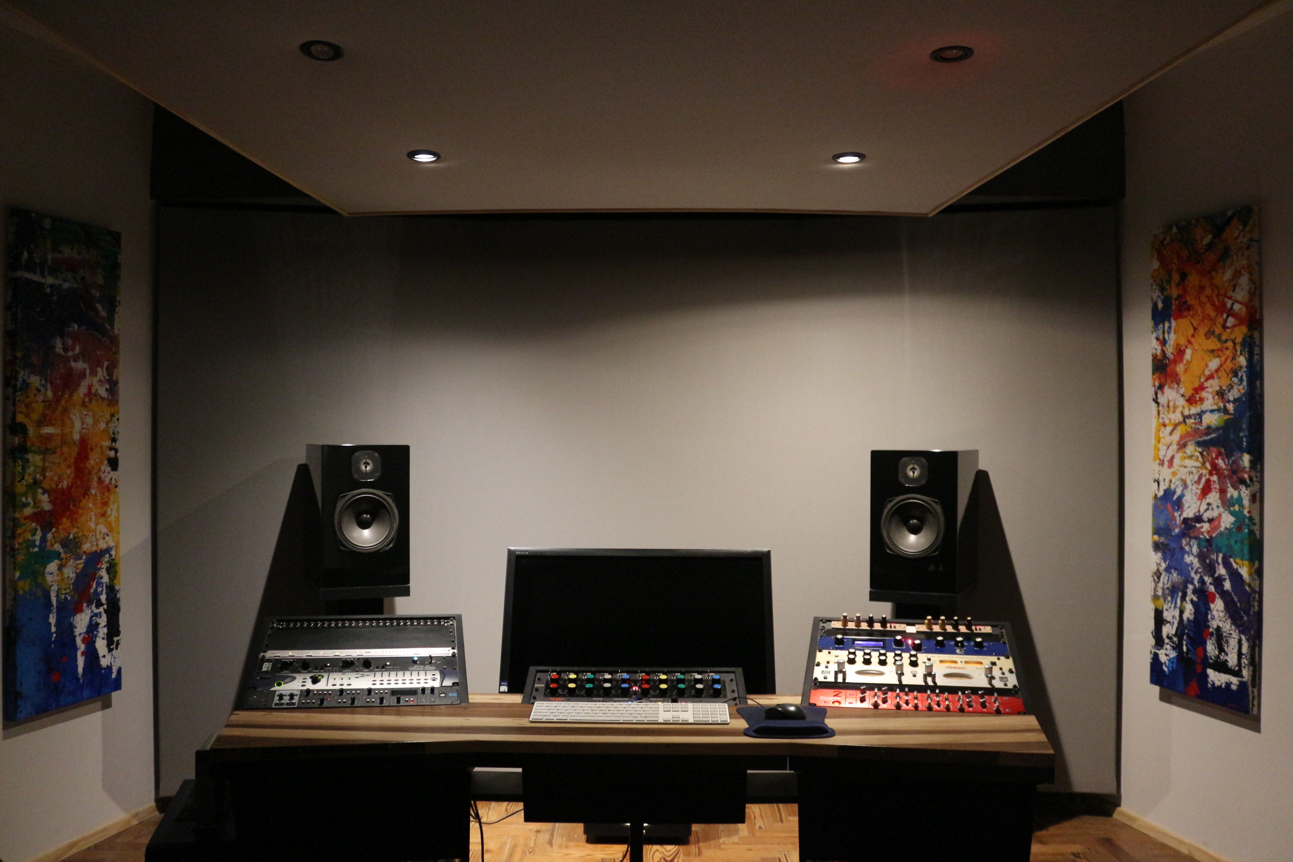

About my room: Is´t really well treated, a little dry, but it was intended to be that way. Behind the walls, and corners there is glass and rock wool for containing standing waves... Also, there is one bass tramp in the ceiling... So, everything that comes from the "source", to the sweet spot it´s really controlled.
I try different monitors in the room and it´s noticeable how each of them reacts in a different way.
I´ll leave you a photo so you have a reference... I am pretty sure I´ll listen to baffle loss here haha!

Got to run out right now but just quickly, speakers right up against the back wall like that may mean your woofers will experience less than the full 6dB of baffle step loss. It always hard to say exactly. You might want to ensure that the mid can get up to about 90dB again - just in case.
Man I feel like a pin pong ball here.
So LF's should wrap around the speakers completely and be well attenuated so I think you're back to the full 6dB of baffle step loss mitigated by some of the factors I've described.
